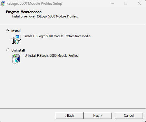

Add-On Profile (AOP)
An AOP is similar to a driver you might download when using a computer device for the first time. The AOP contains information and configurations about the device so the PLC can communicate with it. Unlike an EDS, which is defined by the field device manufacturer, an AOP is downloaded from the PLC manufacturer’s website and is installed much like typical software.
An AOP is installed into RSLogix/Studio 5000, Rockwell Automation’s programming suite. After installation, the device can be selected from the list of network devices, as would be seen after installing an EDS file. The AOP is only used for Rockwell Automation software, and the benefit is the addition of many parameters that EDS files do not add, but ensure you only use one, not both.
Cognex offers both AOP and EDS files for some of their vision systems, with some slight differences. If using the AOP, there are additional parameters made available that can affect how the vision system is programmed—both versions will show up in your list of devices. So if one team member selects the EDS version and another selects the AOP version, you could end up with differences in your code. Some AOP installs have graphical interfaces where additional settings, such as IP addresses and subnet masks, can be configured during installation.
AOP add on profile installation dialog from RSLogix 5000
Figure 3. AOP installation dialog from RSLogix 5000.
When an AOP is added to a project and the new module is created, the lists of controller tags will be populated with the proper names and labels. In addition, several function blocks may now be available that aid in programming for the new device. EDS files do not contain such predefined tag labeling or programming blocks.
