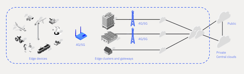

Manufacturing is an early adopter of edge technology. As electronics became more cost-effective, the industry moved towards connected devices. Industry 4.0 and IIoT devices started capturing data from individual machines.
A diagram showing the relationship between edge devices, gateways, and cloud networks. Image courtesy of IBM.

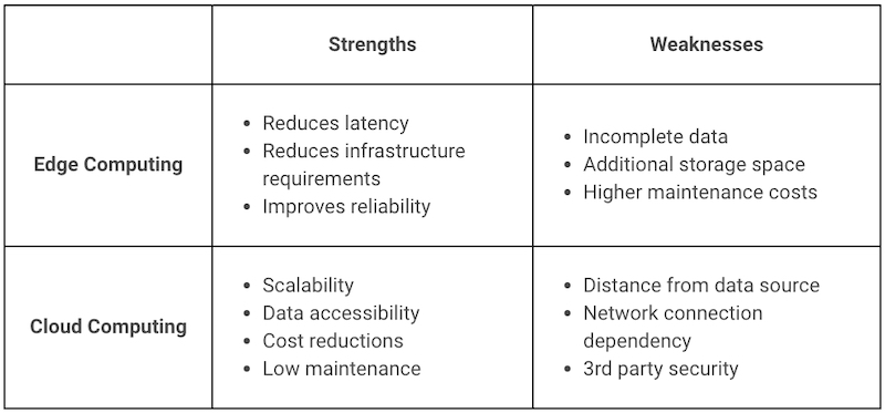

Pros and Cons of Edge Computing
Data helps make more informed decisions and predictions. However, more connections expand networks, demand more bandwidth, can increase access to a company's secure networks. Edge computing can process data locally and only send the necessary information. This can reduce bandwidth, cloud service costs, and latency.
Table courtesy of MachineMetrics.

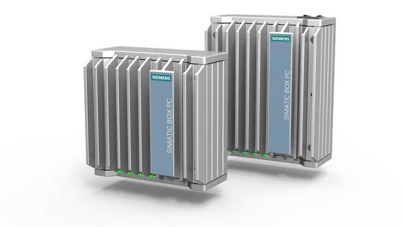

High-speed applications can create latency problems. Computing closer to the edge or directly on a machine reduces latency. Additionally, the device might operate independently, which could improve security by not having access to a larger network.
There is value in sharing information, so you may want some or all edge devices to have the ability to connect to a network. Connected devices increase accessibility, which can weaken security. Encrypting data is often built into many modern industrial connected devices.
An example of standard edge devices. Image courtesy of Siemens

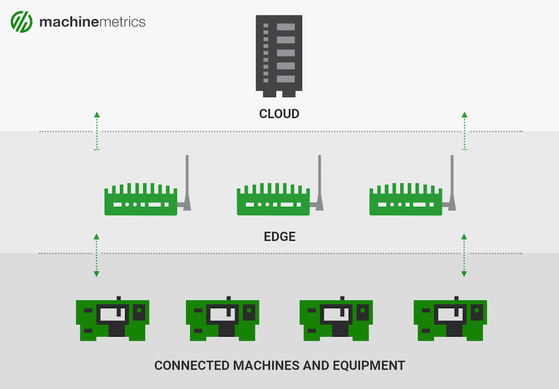

The second big driver of edge computing is for processes that generate large amounts of data. Sending large amounts of data may require a more robust network and greater bandwidths. Applications that process large amounts of data can reduce the networking and Cloud service costs by using Edge computing devices. However, it is essential to know what data is important and where it needs to go.
For example, sending raw data over a network or to the Cloud is often not necessary. Instead, process raw data locally at the edge. It might not be important to send the temperature of a machine every second.
Processing temperature data locally and only sending updates when queued or alerts when thresholds are exceeded free up bandwidth while maintaining the benefits of using a connected device.
The best advice I've heard when it comes to where data should be processed was from Nick Fragale, founder of Rover Robotics, who said, "Run on the edge, train in the cloud."
This is a clear and simple understanding of where different technology works most effectively. Keeping in mind how each technology will scale and be integrated may determine the best results.
An example of how edge computing serves as the connection between the cloud and connected machines and equipment. Image courtesy of MachineMetrics
