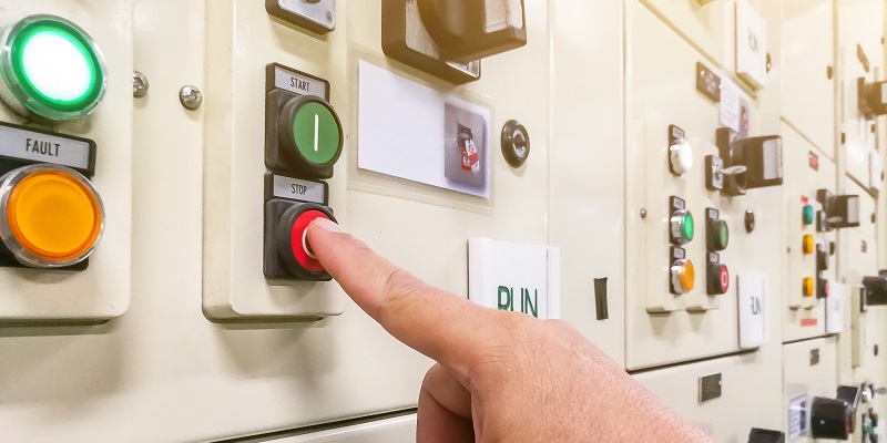

Starting and stopping a motor
Figure 1. Starting and stopping motors is a balancing act between production speed and power efficiency. Image used courtesy of Adobe Stock

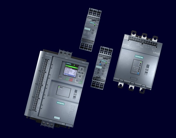

Siemens
SIRIUS Series
Siemens soft starters

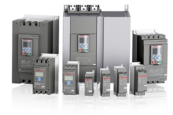

ABB
PS Series Softstarts
ABB soft starters

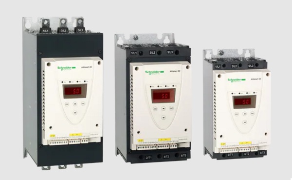

Schneider Electric
Altivar Altistart Series
Schneider Electric soft starters

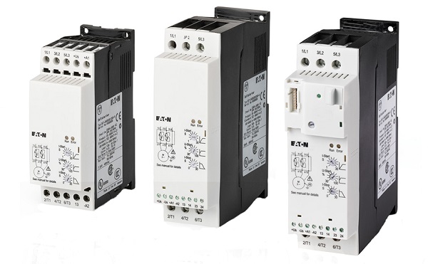

Eaton
(D)S Series Soft Starters
Eaton soft starters

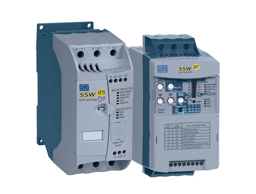

WEG
SS Series Soft-starter
WEG soft starters
