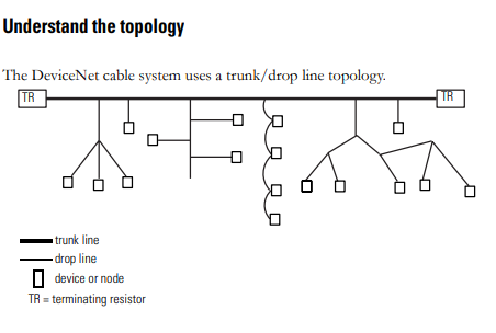

Many companies just starting a digital transformation plan might only be looking for data to see where a connected device or advanced automation would offer the greatest ROI. This might require multiple sensors or simple devices that need two things; a connection and power.
Image used courtesy of Rockwell Automation
DeviceNet offers power and signal in a single cable to connect up to 64 devices that each have a specific node address. Power and signal in one cable can save on cost. Additionally, a trunk and drop line architecture make integrating new devices relatively easy compared to Ethernet/IP which often requires individual wires for each device. Additionally, DeviceNet’s architecture and individual node addresses work well for maintenance and troubleshooting.

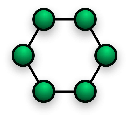

ControlNet can use fiber optics, operate up to 1000 meters without a repeater, connect up to 99 devices, has data transfer rates of 5 Mbps, and offers multiple topologies. This network uses a logical token ring or token-passing BUS control network.
Each node (circle around the ring) has an ID and knows the address of the node before and after it in the ring. The token transmits data frames around this ring until the end of its transfer or it reaches a set time limit.
The timing is set by the network update time (NUT) that can be set between 2 to 100 ms and is made up of three parts: scheduled, unscheduled, and guardband. Scheduled service time will communicate with each node. If a node has no data to transfer it will still send a short message to show it is still transmitting. Without this communication, a provision in the ControlNet protocol will regenerate the token and send it to the next node in the ring.
