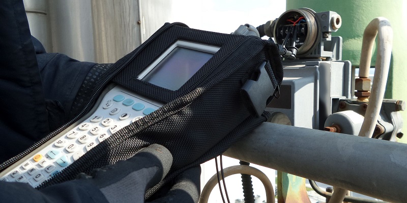

process signal transmitters must be calibrated to ensure high-quality control signals
Figure 2. Process signal transmitters must be calibrated to ensure high-quality control signals. Image used courtesy of Canva

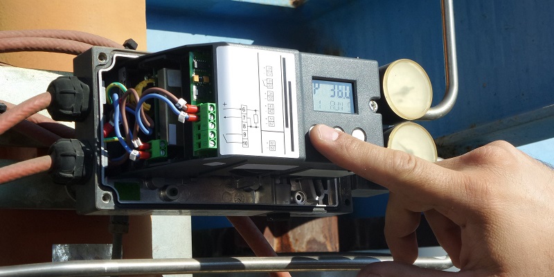

calibration for digital or smart field equipment can be done through onboard parameters
Figure 3. Calibration for some digital or ‘smart’ field equipment can be done through onboard parameters. Image used courtesy of Canva
