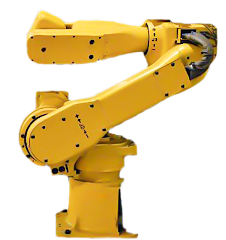

FANUC S-6
Figure 1. FANUC’s S-6, one of their 6-axis robots. Image used courtesy of RobotWorx

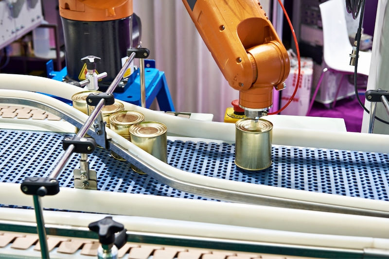

robot working on a conveyor belt
Figure 2. A robot working on a conveyor system.

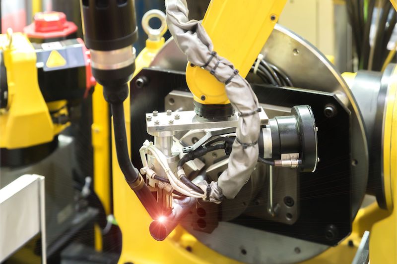

robot cnc laser
Figure 3. A 6-axis robot arm working with a high-precision CNC laser.
