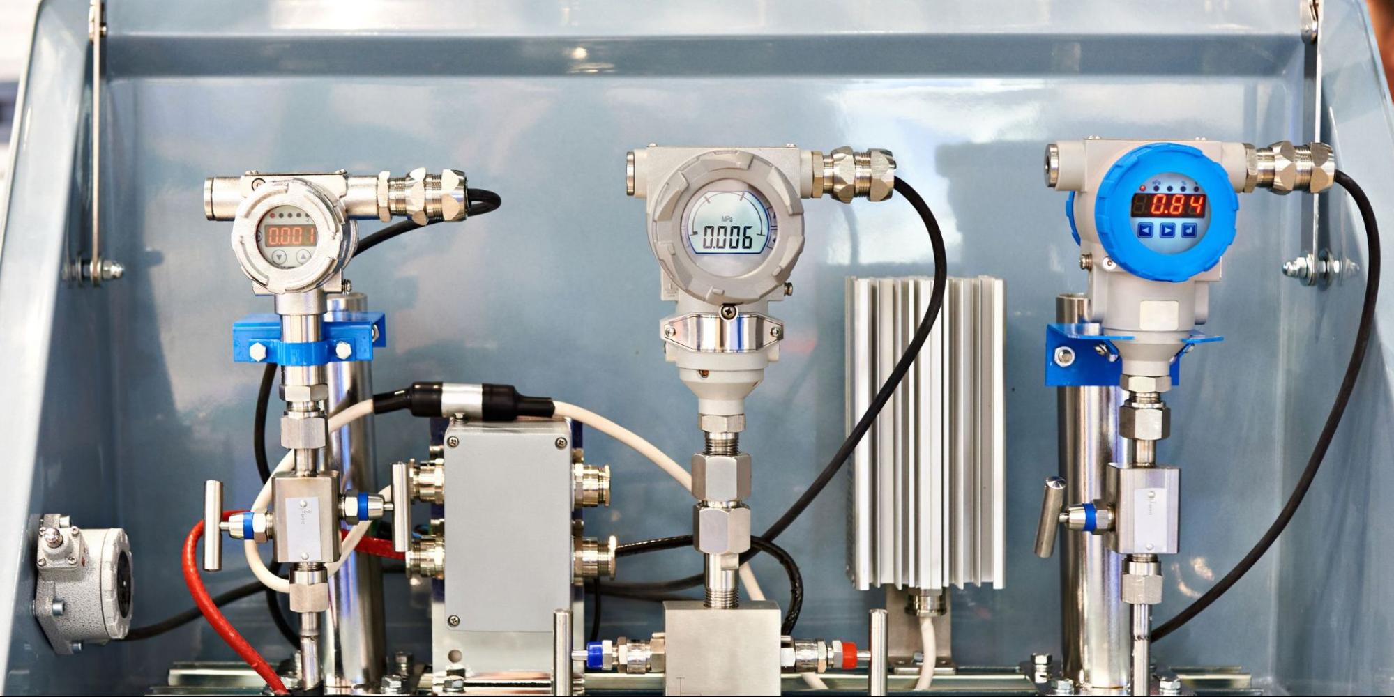

pressure and flow measurements are usually analog signals
Figure 1. Pressure and flow measurements are usually analog signals, many times following the 4-20 mA standard. Image used courtesy of Canva
Current signals have a much more linear response compared to voltage signals. This makes calibration easier with current signals. Current signals are also immune to noise by providing a low impedance for the sensors. For these reasons, current signals are preferred over voltage signals for transmitting electrical signals.

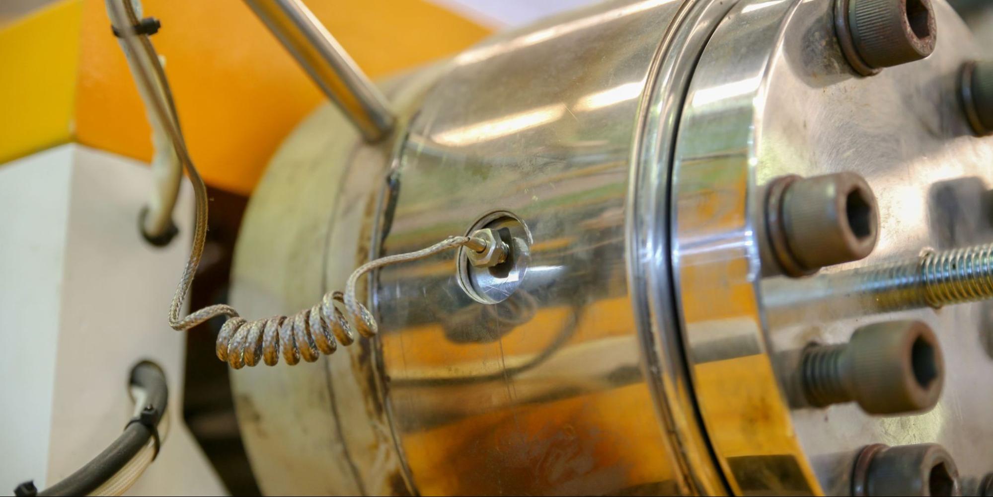

temperature measurement in the form of thermocouples
Figure 2. Temperature measurement, in the form of thermocouples, are critical analog process measurements. Image used courtesy of Canva
This is the dead zero problem. The PLC cannot distinguish between a faulty transmitter loop and the lower range of the measured process variable. Considering that PLCs of the past did not have features like diagnostic circuits and fault identification, the dead zero problem was a big challenge.
The dead zero problem can be eliminated by having an elevated live zero. Elevated live zero means the lower range of the measured value will be represented by a current signal of more than 0 mA. When the 4-20 mA transmitter signal range is used, 4 mA represents the lower range. In the previous example, 4 mA will indicate 20 °C. When there is a fault in the transmitter loop, the PLC receives 0 mA as the input. Since it does not represent any measured value, it can be identified as a fault.
