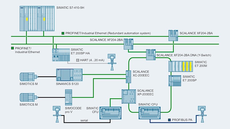

Expandability is a design criterion that is often overlooked. More often than not, control systems undergo expansions and retrofits. Consequently, the network itself usually needs to be expanded. In a well-designed wired network, this can be achieved with relative flexibility by integrating more industrial switches, access points, and the corresponding wiring. This, however, remains a disadvantage when comparing against the flexibility given by wireless media.
Figure 3. An example of a wired industrial controls network. Image used courtesy of Siemens

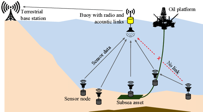

Infrastructure costs and cable replacement are no longer the primary reasons for using wireless communications. Two of the most common applications of wireless networks are remote monitoring and asset management. Some of the most practical examples of these applications are in the oil industry. With some of the most hazardous conditions, infrastructure installation is higher and riskier than in most industries. Wireless devices equipped with a battery power supply are normally the first design choice for new remote monitoring needs.
Figure 4. A wireless sensor network providing underwater conditions data to an oil platform. Image used courtesy of Research Gate
