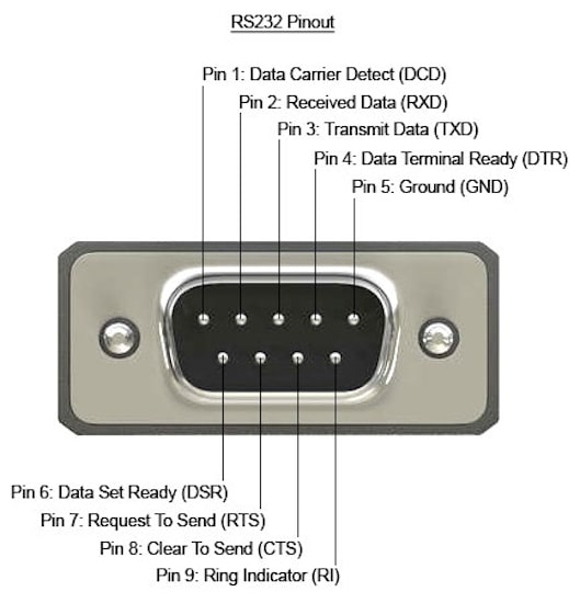

Serial and Ethernet Communication—Protocol Differences
Let us first look at the differences between serial and Ethernet communications to get a better idea of the reach and limitations of the conversions. First, serial communication is designed for point-to-point interfacing. While setting up a serial-based network is possible, they are unreliable at long distances and do not support many devices. Ethernet, on the other hand, supports large networks and long distances.
There is another key difference in terms of the OSI model layers used. Serial establishes a connection only at the physical layer, while Ethernet is a multilayered protocol. Serial is much slower than Ethernet regarding transmission speed, with a supported maximum baud rate of only about 1 M bit per second, and even lower for many applications.
Serial port pinout
Figure 2. Serial port pinout. Image used courtesy of US Converters
Considering these differences, we can say the serial protocol will be the limiting side of speed and flexibility. Also, use cases for serial to Ethernet conversion will be for point-to-point communication most of the time, which does not mean there are few applications.

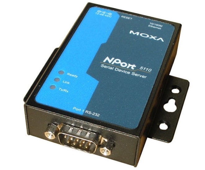

Serial to Ethernet Adapter
Serial to Ethernet adapters are devices that convert data packets back and forth between the two protocols. These adapters come with one RJ45 port and one serial port, usually for the familiar DB9 connector of the RS232. Many of these adapters are available in the market, even on sites like Amazon and eBay.
For control applications, it is crucial to choose adapters from reputable vendors with experience in this sector. Moxa is one of these vendors and one of the leaders in networking solutions for the automation industry.
The NPort
Figure 3. The NPort, a serial-to-Ethernet converter from Moxa
The adapters will come with a programming tool that can be locally installed on a personal computer or accessed via a web browser. The programing tool facilitates the parametrization of the two ports. For the Ethernet port, it is possible to configure the IP address, MAC address, gateway, and other networking settings. Likewise, the baud rate and some timeout parameters can be configured for the serial port.
Some advanced adapters will let the user choose from different operating modes, including Real COM, UDP, TCP Server, TCP Client, and Telnet.
Serial to Ethernet adapters are comparatively more cost-effective than many automation devices. They are also easy to install as part of a control rack and easy to configure.

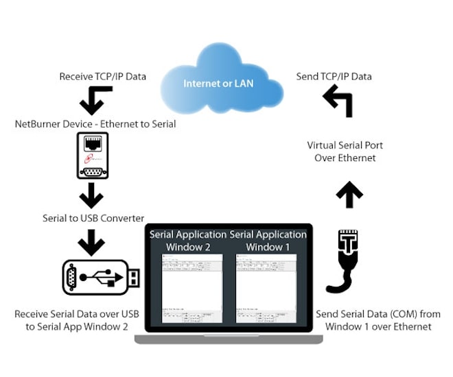

Virtual COM Port
Virtual serial ports (VCOMs) are software-based ports that emulate serial communication. A VCOM is created using a dedicated application running on a Windows operating system.
A VCOM can convert serial-to-Ethernet communication entirely without the physical media. For instance, a VCOM can capture data packets coming from a wireless network to a specific port and translate them to the serial protocol. The data packets are then forwarded to the designated port number (COM number) within the same computer.
VCOM port configuration
Figure 4. An example of a VCOM port configuration. Image used courtesy of Netburner
VCOMs are not yet widely utilized in industrial automation, but that could soon change as more previous generation serial devices need to take a generational leap and integrate directly into the cloud through an Ethernet-based network.
