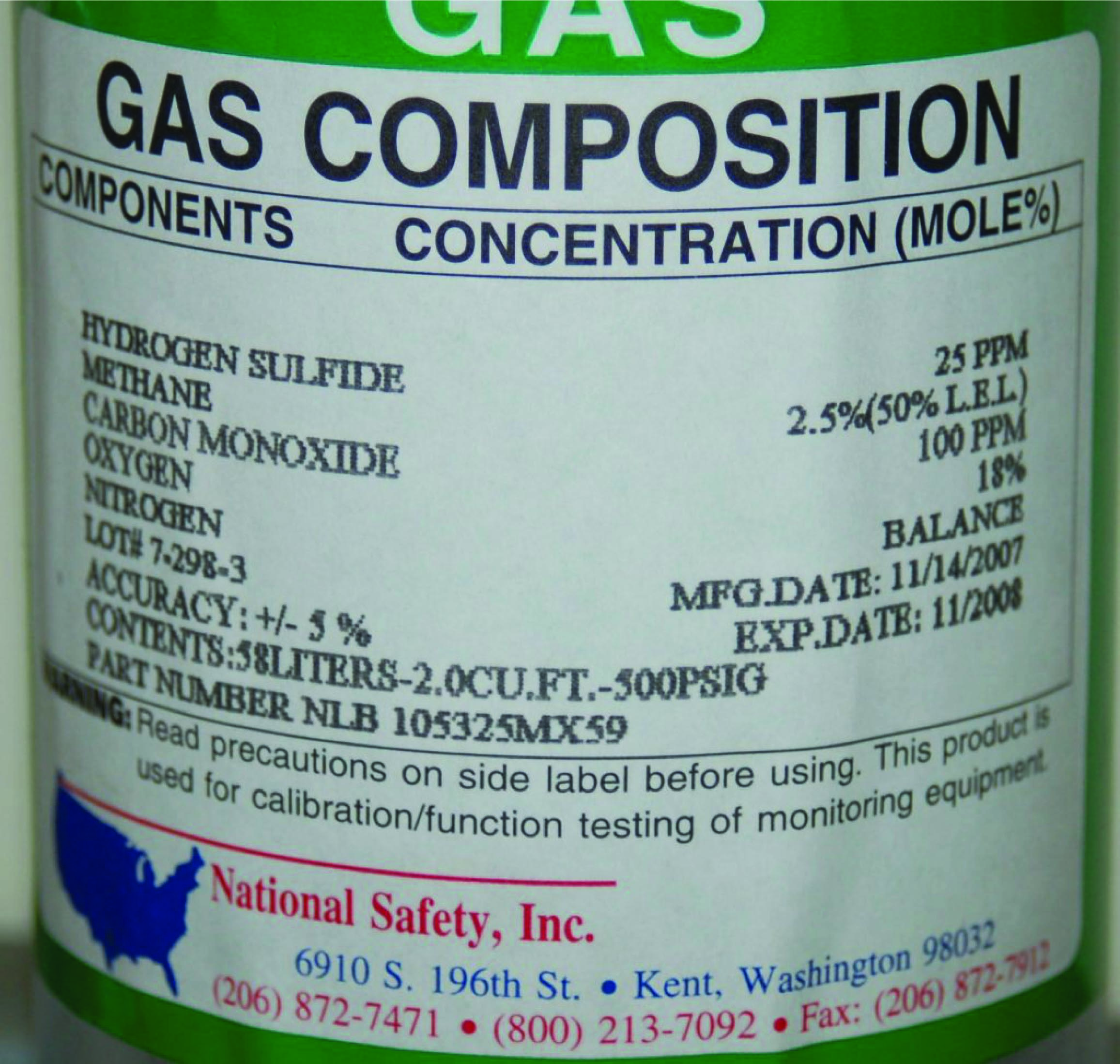

The following photograph illustrates this concept, showing the label on a calibration gas bottle containing a certified mixture of gases used to check the accuracy of air-safety monitoring instruments. Note the concentrations of each gas type within the mixture – some expressed in percent, others in ppm – and how the label states “MOLE %” in the upper-right corner using large bold print to let you know the concentration values refer to molar quantities (e.g. 18% oxygen means 18% of the molecules contained in this bottle are oxygen molecules), which for gases closely corresponds to volumetric quantity rather than mass:
the certified concentrations of different gases
