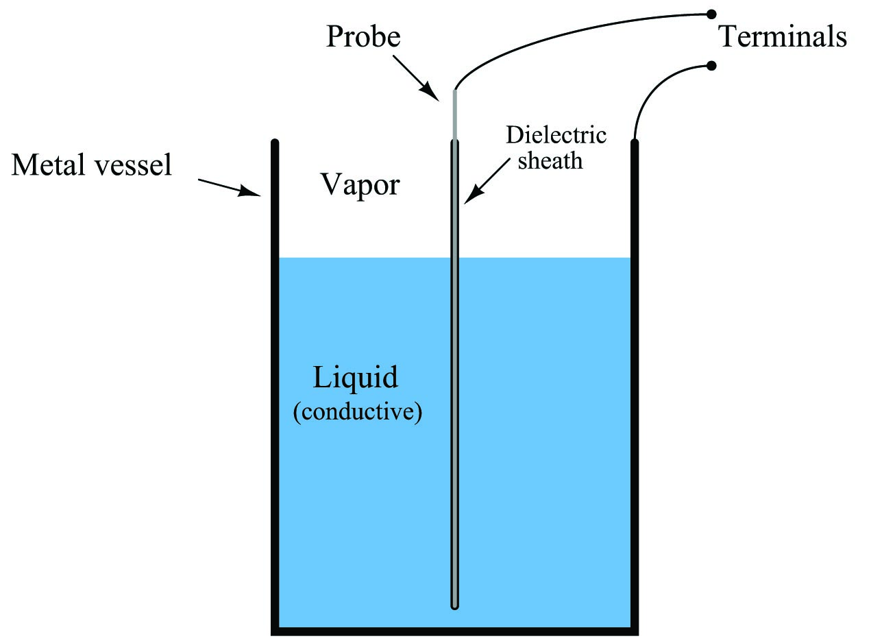

Capacitive level probes come in two basic varieties: one for conductive liquids and one for non-conductive liquids. If the liquid in the vessel is conductive, it cannot be used as the dielectric (insulating) medium of a capacitor. Consequently, capacitive level probes designed for conductive liquids are coated with plastic or some other dielectric substance, so the metal probe forms one plate of the capacitor and the conductive liquid forms the other:
In this style of capacitive level probe, the variables are permittivity (\(\epsilon\)) and distance (\(d\)), since a rising liquid level displaces low-permittivity gas and essentially acts to bring the vessel wall electrically closer to the probe. This means total capacitance will be greatest when the vessel is full (\(\epsilon\) is greatest and effective distance \(d\) is at a minimum), and least when the vessel is empty (\(\epsilon\) of the gas is in effect, and over a much greater distance).

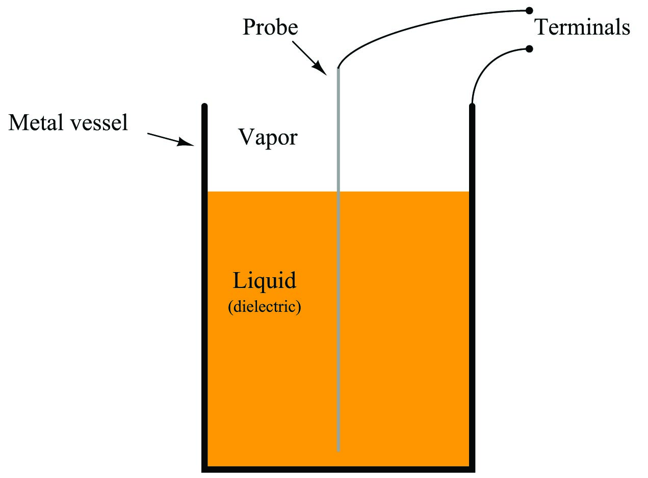

If the liquid is non-conductive, it may be used as the dielectric itself, with the metal wall of the storage vessel forming the second capacitor plate. The probe is just a bare metal cable or rod:
In this style of capacitive level probe, the only variable affecting probe capacitance is permittivity (\(\epsilon\)), provided the liquid has a substantially greater permittivity than the vapor space above the liquid. This means total capacitance will be greatest when the vessel is full (average permittivity \(\epsilon\) is at a maximum), and least when the vessel is empty. Distance (\(d\)) is constant with a non-conducting process liquid, being the radius of the vessel (assuming the probe is mounted in the center).
