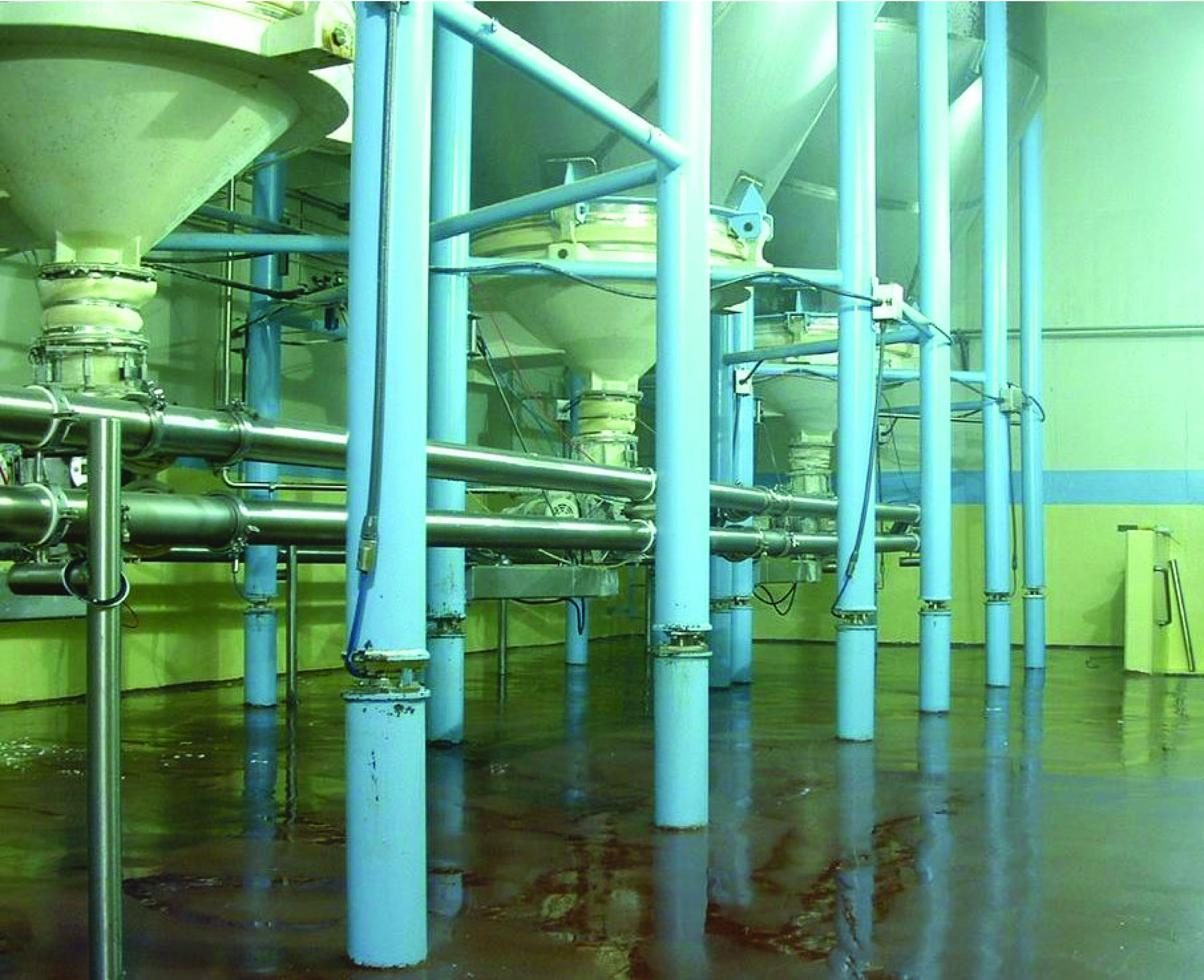

The following photograph shows three bins used to store powdered milk, each one supported by pillars equipped with load cells near their bases:

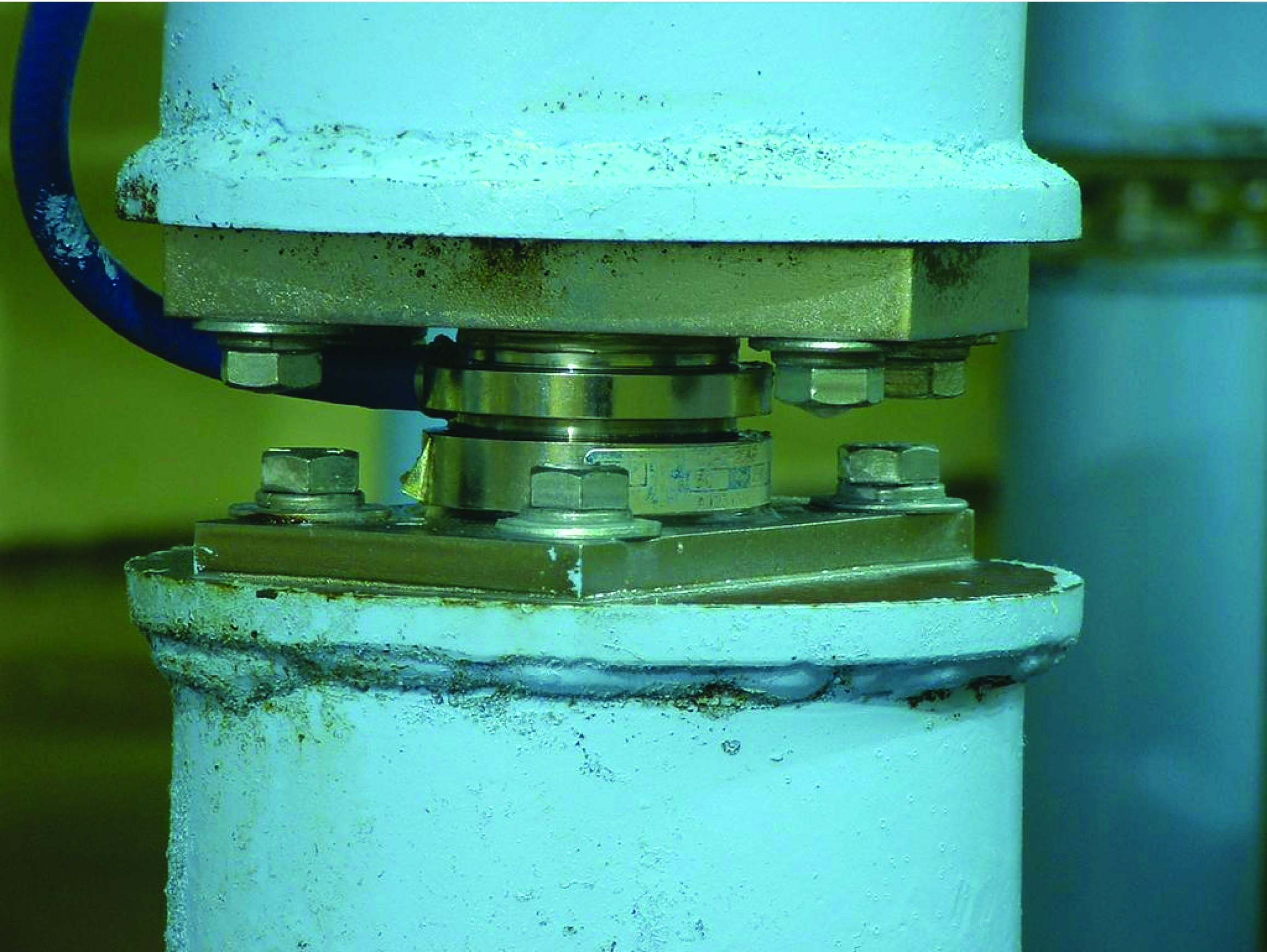

A close-up photograph shows one of the load cell units in detail, near the base of a pillar:
When multiple load cells are used to measure the weight of a storage vessel, the signals from all load cell units must be added together (“summed”) to produce a signal representative of the vessel’s total weight. Simply measuring the weight at one suspension point is insufficient, because one can never be sure the vessel’s weight is distributed equally amongst all the supports.

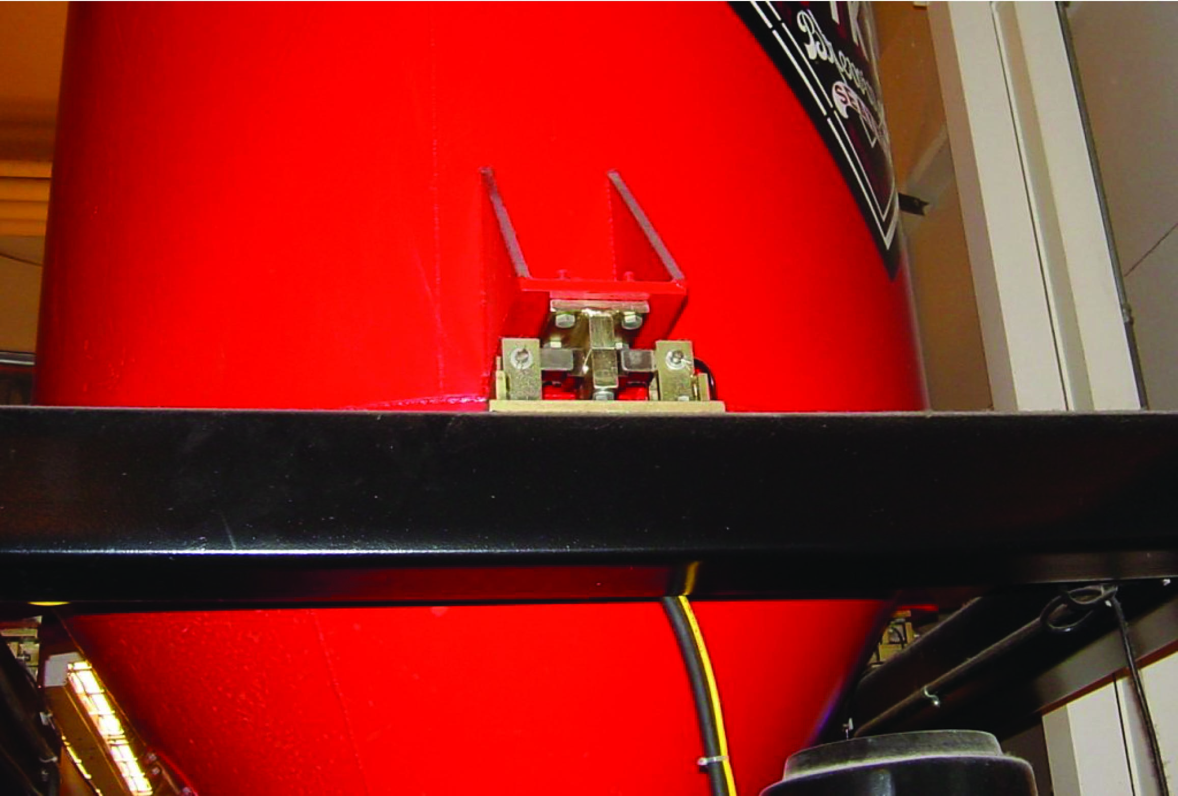

This next photograph shows a smaller-scale load cell installation used to measure the quantity of material fed into a beer-brewing process:

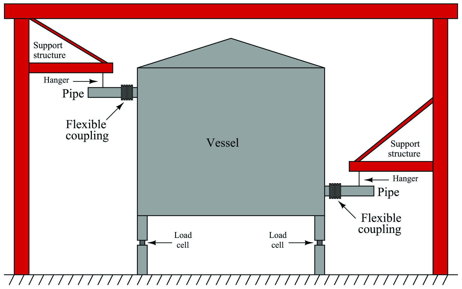

One very important caveat for weight-based level instruments is to isolate the vessel from any external mechanical stresses generated by pipes or machinery. The following illustration shows a typical installation for a weight-based measurement system, where all pipes attaching to the vessel do so through flexible couplings, and the weight of the pipes themselves is borne by outside structures through pipe hangers:
Stress relief is very important because any forces acting upon the storage vessel will be interpreted by the load cells as more or less material stored in the vessel. The only way to ensure that the load cell’s measurement is a direct indication of material held inside the vessel is to ensure that no other forces act upon the vessel except the gravitational weight of the material.
