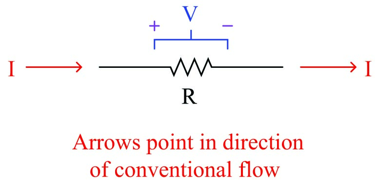

Control valves are rated in their ability to throttle fluid flow much in the same way resistors are rated in their ability to throttle the flow of electrons in a circuit. For resistors, the unit of measurement for electron flow restriction is the ohm: 1 ohm of resistance results in a voltage drop of 1 volt across that resistance given current through the resistance equal to 1 ampere:
The mathematical relationship between current, voltage and resistance for any resistor is Ohm’s Law:

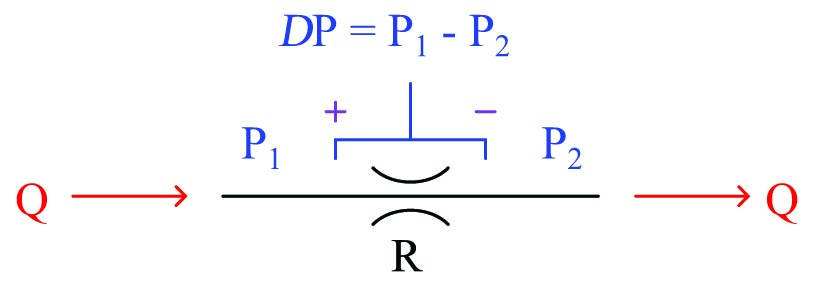

The fluid “resistance” of a restriction depends on several variables: the proportion of kinetic energy lost due to turbulence (\(k\)), the density of the fluid (\(\rho\)), and the cross-sectional area of the restriction (\(A\)). In a control valve throttling a liquid flow stream, only the first and last variables are subject to change with stem position, fluid density remaining relatively constant.
[fluid_restrictions]

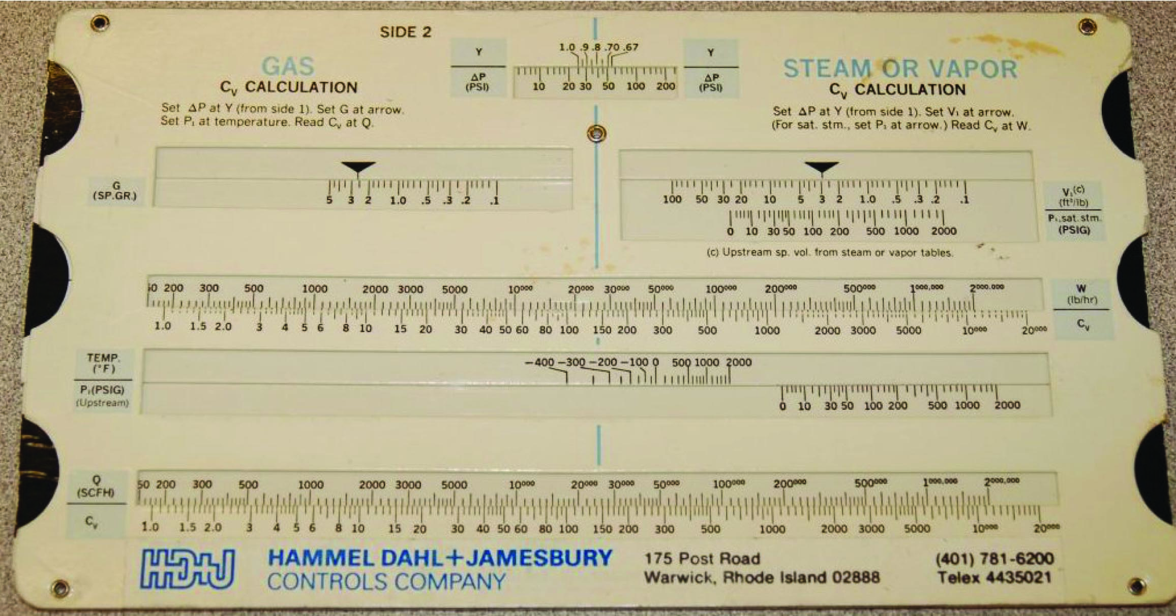

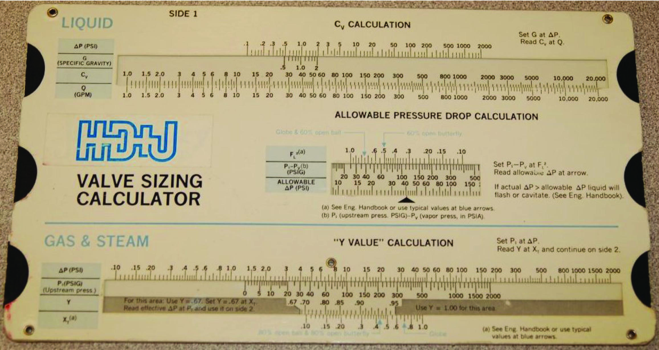

Control valve sizing is complex enough that some valve manufacturers used to give away “slide rule” calculator devices so customers could choose the \(C_v\) values they needed with relative ease. Photographs of a two-sided valve sizing slide rule are shown here for historical reference:

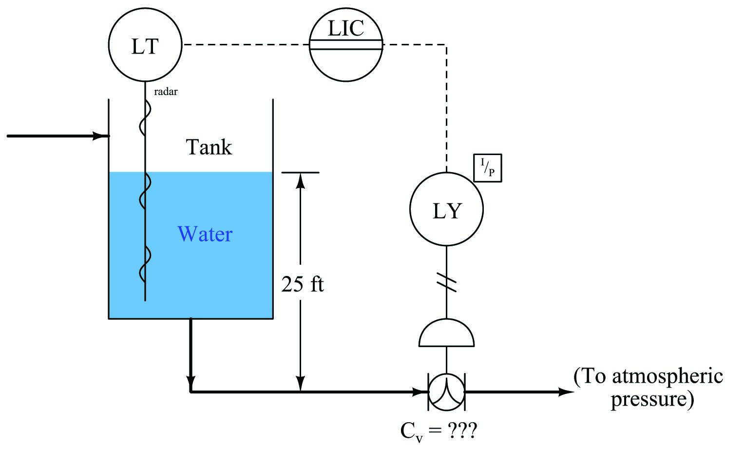

Suppose the process engineer designing this system specifies a maximum flow rate for this valve of 470 GPM. What should the maximum \(C_v\) rating be for this valve? To begin, we must know the expected pressure drop across the valve. The 25-foot water column height upstream provides us with the means to calculate \(P_1\) by using the formula for calculating hydrostatic pressure (the pressure generated by a vertical column of liquid under the influence of gravity):
\[P = \gamma h\]
\[P_1 = (\hbox{62.4 lb/ft}^3)(\hbox{25 feet})\]
\[P_1 = 1560 \hbox{ PSF} = 10.8 \hbox{ PSI}\]
There is no need to calculate \(P_2\), since the P&ID reveals the downstream side of the valve to be vented to atmosphere, and thus is guaranteed to be 0 PSI gauge pressure. This gives us a pressure drop of 10.8 PSI across the control valve, with an expected maximum flow rate of 470 GPM. Manipulating our flow capacity equation to solve for \(C_v\):
\[Q = C_v \sqrt{{P_1 - P_2} \over G_f}\]
\[C_v = {Q \over \sqrt{{P_1 - P_2} \over G_f}}\]
\[C_v = {470 \hbox{ GPM} \over \sqrt{{10.8 \hbox{ PSI}}\over 1}}\]
\[C_v = 143\]
This tells us we need a control valve with a \(C_v\) value of at least 143 to meet the specified (maximum) flow rate. A valve with insufficient \(C_v\) would not be able to flow the required 470 gallons per minute of water with only 10.8 PSI of pressure drop. As mentioned previously, these calculations yield approximate results only. An analysis using computer-based valve sizing software may require an even larger control valve for this application.

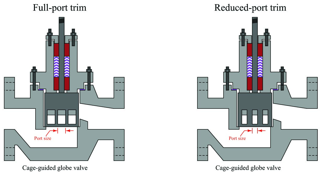

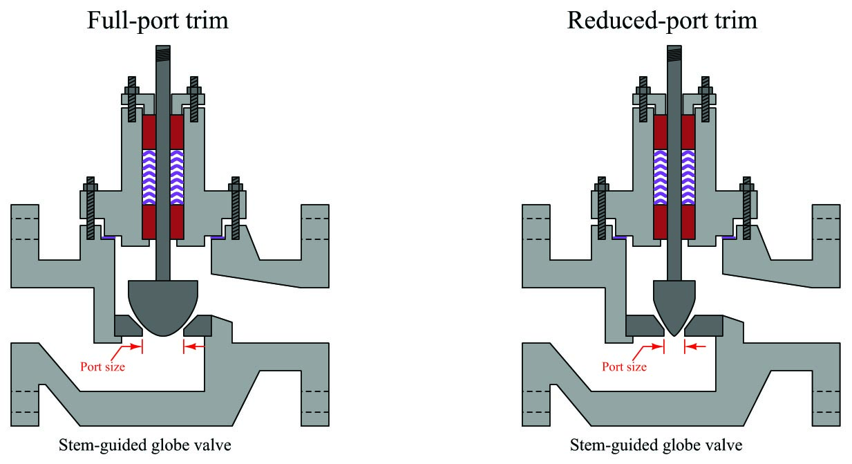

A practical solution to the problem of valve over-sizing – especially when larger flow rates will be required of the valve in the future – is to initially order the control valve with a body size suitable for the largest flow capacity it will need in the future, but equipped internally with reduced-port (or restricted-capacity) trim. This means trim having smaller holes (“ports”) through which the fluid must flow. Such a “reduced” trim is under-sized for the valve body, making the control valve’s \(C_v\) rating significantly less than it would be with normal-sized trim installed. The benefit of installing reduced-port trim in a control valve is that the flow capacity of the valve may be upgraded simply by removing the reduced trim components and replacing them with full-port (full-sized) trim. Upgrading a control valve’s trim to full-port size is significantly less expensive than replacing the entire control valve with a larger one.
Reduced-port trim for a stem-guided or port-guided globe valve takes the form of a new (smaller) plug and seat assembly. The seat is specially designed to match the plug for tight shutoff and good throttling behavior while having the necessary external dimensions to fit the larger valve body casting:
full-port trim and reduced-port trim diagram
Reduced-port trim for a cage-guided globe valve often consists of nothing more than a new cage, having smaller ports in the cage than standard. Thus, reduced-port trim for a cage-guided globe valve may utilize the exact same plug and seat as the full-port trim for the same cage-guided globe valve:

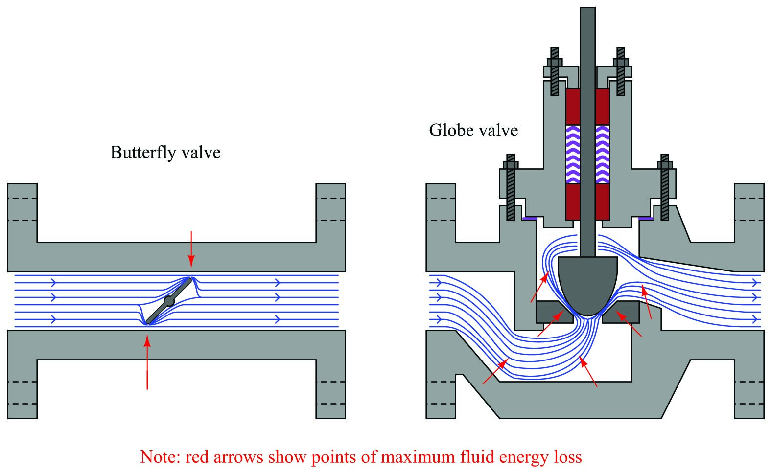

Not all control valve types exhibit the same \(C_v\) coefficients, however, for the same pipe size. A 4-inch butterfly valve, for example, has a much greater full-open \(C_v\) rating than a 4-inch globe valve, due to the much more direct path it offers to a moving fluid. A simple comparison of these two valve types clearly shows why this is true (note the “constriction” points labeled with arrows):
A globe valve is simply more effective at generating fluid turbulence – and therefore dissipating fluid kinetic energy – than a butterfly valve of the same pipe size, because the globe valve design forces the fluid to change direction more often and in different ways.
