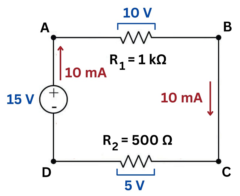

Let us examine the effects of both faults in a simple two-resistor DC circuit. We will begin with an analysis of the circuit in a healthy condition, showing all values of voltage and current:
Being a series circuit, the current is the same through all components while the two loads’ voltage drops add to equal the source voltage.

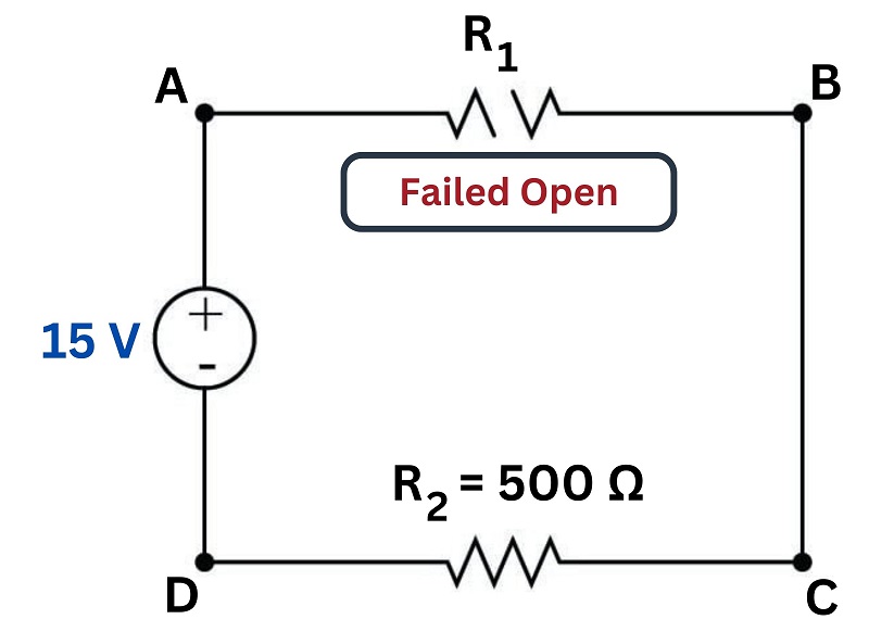

Open Circuit Fault
Now suppose resistor \(R_1\) fails open. We know that a continuous electric current is able to exist only where there is a continuous path for that current. If a component fails open, the continuity of the circuit will be broken, and current must halt. Since this is a series circuit, if current halts in one location it must likewise halt in all locations:
We would still expect to measure 15 volts between test points A and B because it is the nature of a voltage source to maintain a constant voltage across its terminals (i.e. to maintain the same amount of energy difference per unit charge from one side to the other). We may apply Ohm’s Law to calculate the voltage across the healthy resistor \(R_2\): since \(V = IR\) and \(I = 0\), we may safely conclude that \(V = 0\) for resistor \(R_2\).

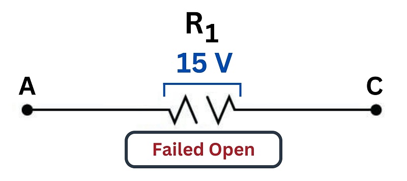

Unfortunately, we cannot apply Ohm’s Law to the failed resistor \(R_1\) since the resistance of any failed-open component is infinite. Infinitudes do not lend themselves to arithmetic calculations (how much is zero times infinity?), and so we must find some other way to determine the voltage dropped across the open \(R_1\). Here we find that Kirchhoff’s Voltage Law applies very nicely: if we know that the algebraic sum of all voltages in a loop must equal zero, and we know all but one of the voltages in the loop BACDB, we may calculate the last voltage by simple addition and subtraction:
Path | Voltage gain/loss | Reason |
B to A | +15 volts | Source voltage value |
A to C | \(-\)15 volts | Necessary to satisfy KVL |
C to D | 0 volts | These points are equipotential |
D to B | 0 volts | Ohm's Law: V = 0 A \(\times\) 500 \(\Omega\) |
BACDB | 0 volts | KVL sum = 0 |
Clearly, the voltage between points A and C (across the failed-open \(R_1\)) must be \(-15\) volts in order to satisfy Kirchhoff’s Voltage Law. The negative sign of \(V_{AC}\) tells us that point C must be at a lesser potential than point A (i.e. A is positive and C is negative).

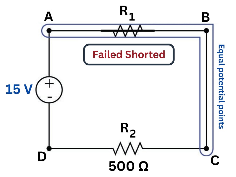

Short Circuit Fault
Let us suppose now resistor \(R_1\) fails shorted. This means its two terminals are now directly connected to each other rather than being separated by 1000 ohms of electrical resistance. In other words, the two terminals of resistor \(R_1\) have been made equipotential by the shorted fault. By extension, this forces points A and C to be equipotential as well. Since points C and D are already equipotential to each other by virtue of the wire connecting them, points A through D must now be equipotential.
If points A through D are all equipotential, it means the right-hand terminal of resistor \(R_2\) is directly connected to the positive terminal of the 15 volt source. The left-hand terminal of \(R_2\) is already equipotential with the negative terminal of the source. This means the shorted fault at \(R_1\) has placed the full source potential across resistor \(R_2\). An analysis using Kirchhoff’s Law confirms this:
A to C | 0 volts | Shorting points makes them equipotential |
D to B | \(-\)15 volts | Necessary to satisfy KVL |

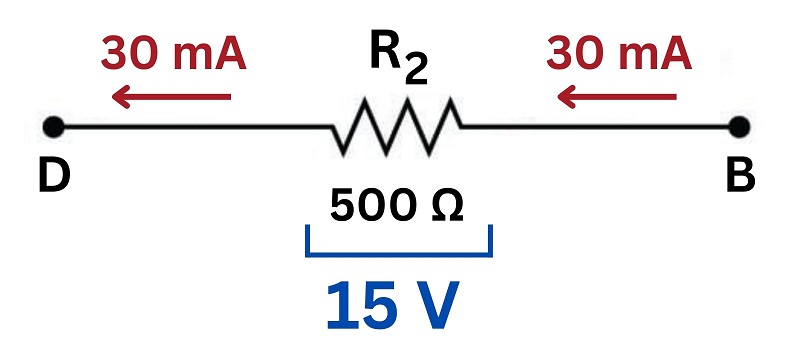

The negative sign of \(V_{DB}\) tells us that point B must be at a lesser potential than point D (i.e. D is positive and B is negative). Calculating the amount of current in this circuit is now a simple matter of applying Ohm’s Law to resistor \(R_2\). Given a 15 volt potential across it and 500 ohms of resistance, the current is equal to 30 milliamps:
