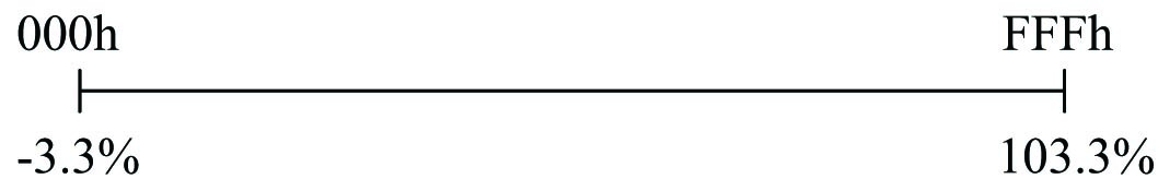

In some data acquisition systems the digital “count” scale maps to a live-zero analog range. For example, the Siemens model 353 process controller represents process variable, setpoint, and output (“valve”) percentages on a displayed scale of \(-3.3\)% to 103.3% with a 12-bit ADC count. For this controller, a digital count of zero (000 hexadecimal) represents an analog signal displayed on the controller’s digital readout of \(-3.3\)%, and a full-scale digital count value (FFF hexadecimal) represents a displayed value of 103.3%. We may show the relationship between these two scales in graphical form, like a number line:
At first, the task of translating any analog value into its corresponding digital count value for this scale may seem daunting, but it is really no different than translating an input value into its corresponding output value for any linear instrument. This is something every student of instrumentation learns to do when working with analog-signal instrumentation, where process measurements are represented by 4-20 mA current signals or 3-15 PSI pneumatic pressure signals. If you were given a temperature transmitter with an input range of \(-100\) to 450 degrees Celsius and an output range of 4 to 20 milliamps, and then asked to calculate the appropriate current value corresponding to 300 degrees in that range, the task would be simple. First, you could translate 300 degrees into a per-unit expression of range by subtracting the lower-range value (LRV) of \(-100\) and then dividing by the span (URV \(-\) LRV):
\[{300 - (-100) \over 450 - (-100)} = 0.7273 \hbox{ per unit}\]
After that, you would translate that per-unit figure into a current value:
\[(0.7273)(16) + 4 = 15.636 \hbox{ mA}\]
This general procedure of converting an input value into a per-unit representation of range, then converting that per-unit quantity into an output value, is described in detail in the section beginning on the page. Other methods of performing the same translation between linear input and output ranges.
Converting a digital count value to its respective analog value (or vice-versa) follows the exact same procedure. All we need to do is identify the input and output ranges of the converter circuit, then apply the same formula. One of these ranges will be an analog voltage or current range, while the other will be a count range. If needed, the count value may be translated to or from hexadecimal or binary, because your manual calculations of course would need to be done in decimal format.
For example, suppose one of these Siemens controllers displayed a value of 26.7% on its front panel, and we wished to know what digital (count) value corresponded to this. First, we could translate the panel indication of 26.7% into a per-unit expression of range based on the scale being \(-3.3\)% to 103.3%:
\[{{26.7 - (-3.3)} \over {103.3 - (-3.3)}} = {30 \over 106.6} = 0.2814 \hbox{ per unit}\]
Then, we may take this per-unit expression of 0.2814 and multiply it by the span of the known count range (4095 for a 12-bit converter) to arrive at 1152, or 480 hexadecimal (480h).

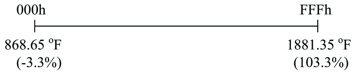

Similarly, if we knew the range of this 12-bit ADC in actual process engineering units, we could translate between ADC counts and the process value by the same method. Suppose we used one of these same controllers to display the temperature of a furnace, where the lower- and upper-range values were 900 deg F and 1850 deg F, respectively. It is important to realize that these lower- and upper-range values represent 0% and 100% of scale, and that the ADC is actually configured to cover a range from \(-3.3\)% to 103.3%. In other words, the ADC range “spills over” the specified range of 0 to 100% (900 to 1850 \(^{o}\)F) by 3.3% on both ends, equating to 31.35 \(^{o}\)F above and below the specified range limits. Thus, the 12-bit ADC’s full-count range of 0 to 4095 (000 to FFF hex) actually covers a temperature range of 868.65 \(^{o}\)F to 1881.35 \(^{o}\)F:
Suppose we happened to know the ADC count inside this Siemens controller for a certain furnace temperature was A59 hexadecimal (A59h), equal to 2649 in decimal form:
To convert this count value into a temperature, first we convert the count value of 2649 into a per-unit value:
\[{2649 \over 4095} = 0.6469 \hbox{ per unit}\]
Next, we translate this per-unit value into a temperature based on the known LRV and URV range points:
\[(0.6469)(1881.35 - 868.65) + 868.65 = 1523.75 \hbox{ degrees F}\]

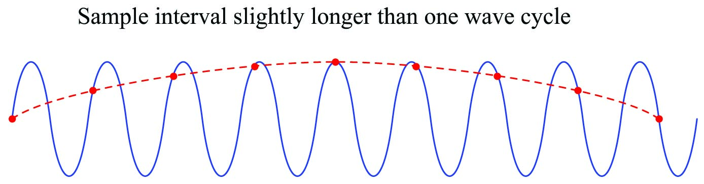

An example of signal aliasing is shown in the following illustration, where a sinusoidal signal (colored blue) is sampled at periods slightly slower than once per cycle (samples marked by red dots). The result (the red, dashed curve) is what appears to be a much lower-frequency signal as seen by the digital system, which only “sees” the values represented by the red dots:

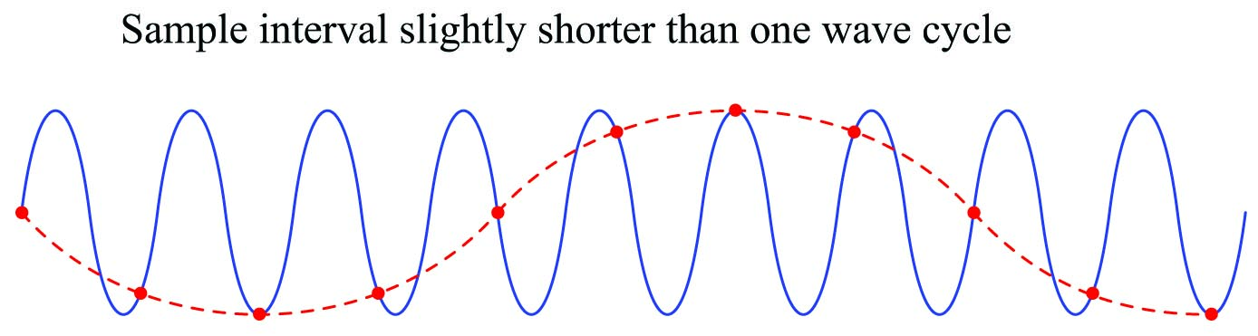

Aliasing can even occur when the sampling rate is slightly faster than the sinusoidal signal’s period, as shown in this illustration:
As you can see from these illustrative examples, the troubling nature of aliasing is that it causes the ADC to report a completely incorrect, yet completely plausible signal. The only way to avoid aliasing is to ensure that the sampling rate is much faster than the signal period: a good rule here is to sample at least 10 times per period, for the highest signal frequency of interest.

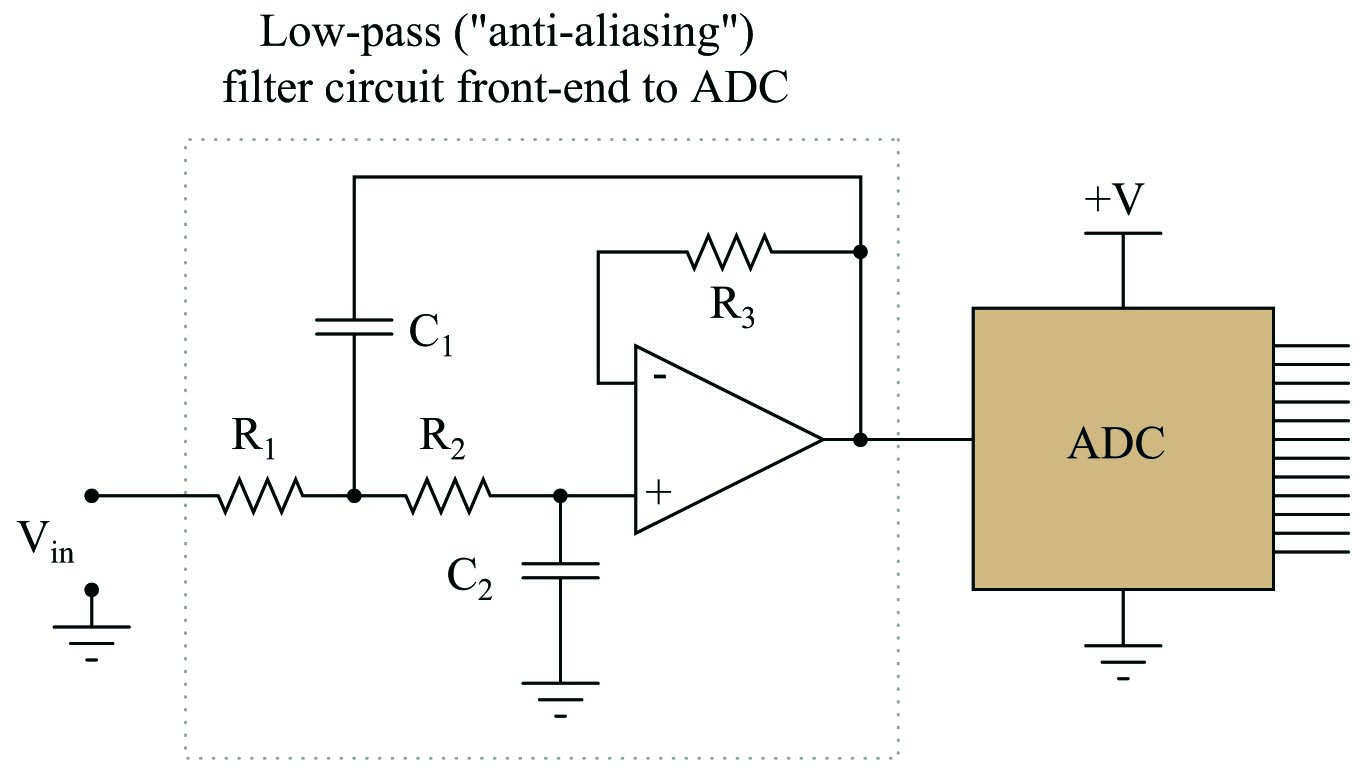

If we cannot set the sampling rate of the ADC to be significantly faster than the highest signal frequency we might encounter, we may avoid aliasing by preventing those high signal frequencies from ever reaching the ADC. This may be done by placing an analog low-pass filter circuit before the ADC’s input. Such a “front-end” circuit is called an anti-aliasing filter:
