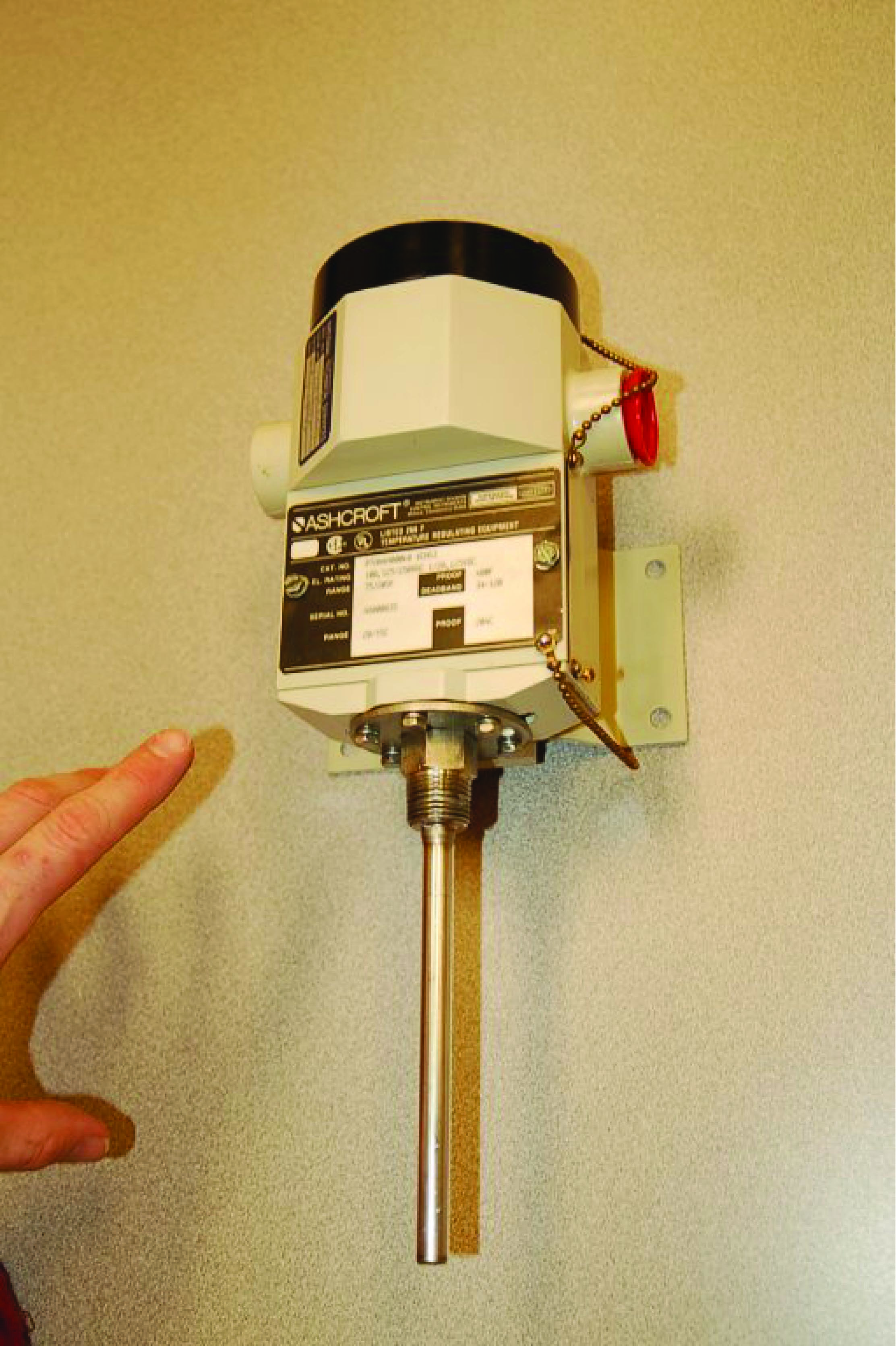

The following photograph shows a temperature-actuated switch manufactured by the Ashcroft corporation:
