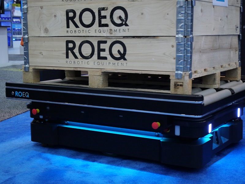

The most common place to see mobile platforms currently is in the context of warehousing and storage, followed by healthcare and various other capabilities such as store inventory and construction. The basic construction of most of these platforms is quite similar. Since these platforms are not guided by a remote human operator, they are autonomous, gaining the title ‘autonomous mobile robots’, or AMRs, as they will be called throughout this text.

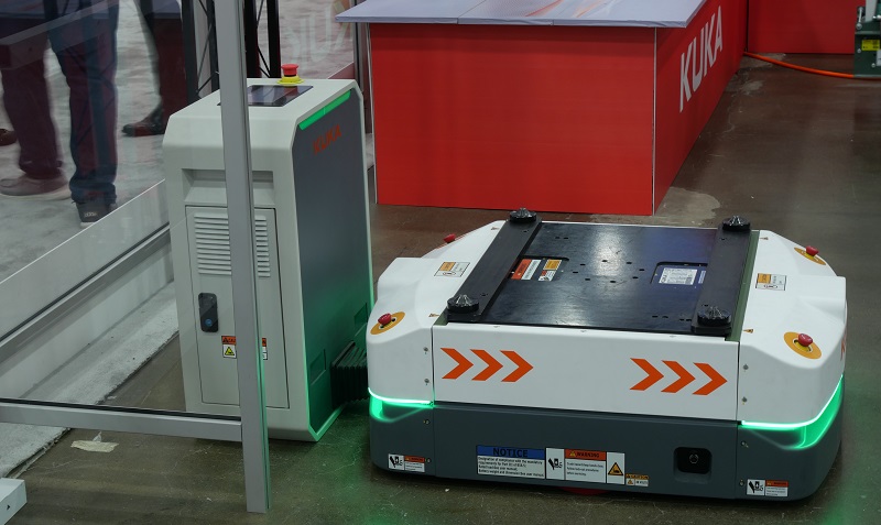

Most AMRs are designed for stability and payload, not for speed. They often work around humans, so safety is a great design consideration. Most of these will be low to the ground, supported by a wide wheel base capable of turning, usually not traversing sideways. Being mobile, they are battery powered and must return to a charging station in the event of battery capacity draining.

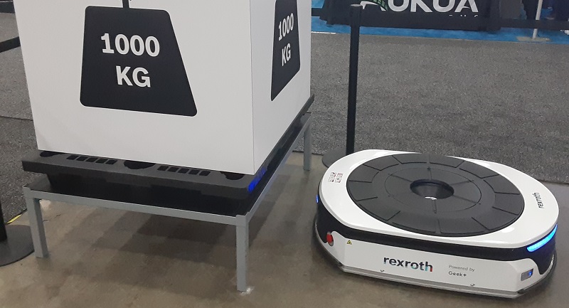

Mobile platforms, on the other hand, have payloads that are commonly well into the hundreds, or even above 1000 kg. These AMRs usually lift vertically, supporting the entire payload weight between the strong wheels, with no counter-balance required as with many heavy-payload arm designs. Once again, it should be noted that there are also articulated arms with several thousand kg payloads (over 5000 lb), which is nothing short of amazing.

A few design challenges certainly affect AMRs differently than other robots. Battery power must be conserved for long duty cycles between charges. Since they are supported by the floor, and they actually must have a heavy weight to keep a low center of gravity, they can be powered with large batteries. This center of gravity is a second challenge. When carrying a tall load of shelves or a cart with items stacked on it, any quick turns or slight angles on the floor can cause the robot to tip over or dump its load on the ground.
Some of these problems can be solved by the robot design. Many AMRs turn in place rather than turning around a corner as a car might. This keeps the load from dangerously tilting, which can happen even at low speeds. As for the angle of the floor, the AMR designer can’t solve that problem, but sensors can be installed to detect the distance to the floor below the robot, and if that distance increases, this means that an angle or edge is too close. This prevents the robot from accidentally traveling up or down loading ramps, or reaching the edge of a stairway.

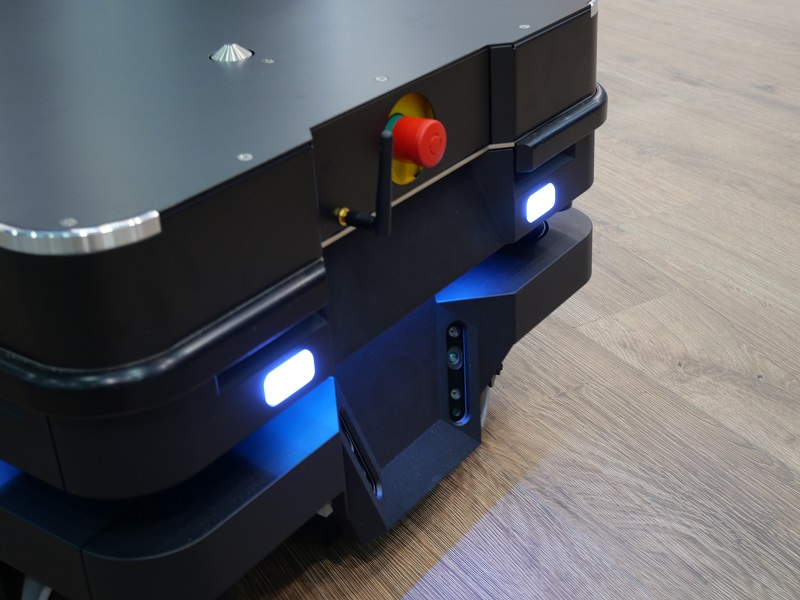

There is one major design consideration for AMRs, although it is not surprising: safety. As these platforms navigate among obstacles and people, they must have proper collision avoidance capabilities to not only finish the task but remain safe for equipment and workers.

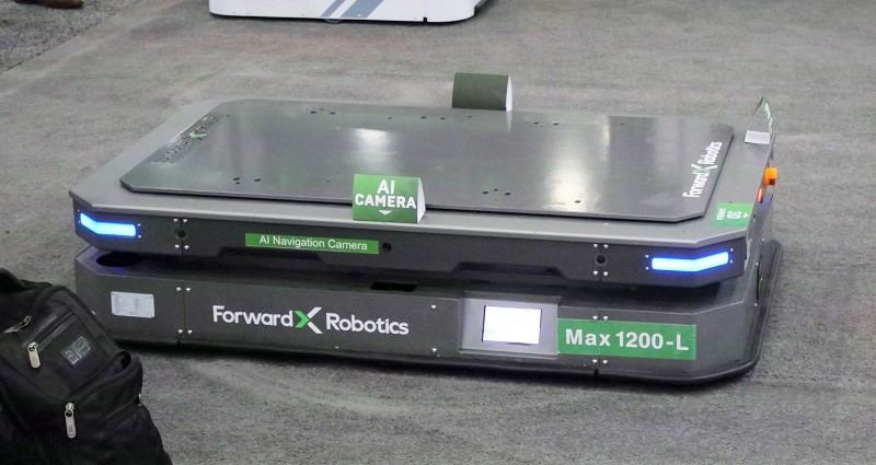

To sense temporary obstacles and people, arrays of sensors are mounted to the front, sides, and back of the robot. If the payload is tall, the sensors must be able to detect objects up to that height. Many types of sensors are often required, working in conjunction to ensure nothing is missed. IR detection can emit and reflect light to detect distances, passive IR cameras can detect people and heat-emitting objects, and ultrasonic can rely on sound to detect transparent objects (windows, glass doors, etc). Each of these methods provides critical insight, but they also have some critical flaws, which is why it is a rare case when only one type of sensor is used for proximity detection.
Using cameras together with artificial intelligence (AI) can be a major benefit to this field of mapping. Cameras along only provide a 2-dimensional picture of a surrounding space. The advent of 3D cameras provided a perspective image, which can be seen as you ‘move’ around an image like a virtual reality environment, but cameras alone still lack any ability to perceive objects and distances. The world of AI is advancing so rapidly that many things that were impossible only a few years ago are now common. Allowing an AI engine to process a picture and identify every single aspect of that image is really not far from reality. There are still some challenges that may be difficult to overcome, such as mapping from a single 2D image, but with the pace of AI technology, it’s hard to predict what the next few years will bring.

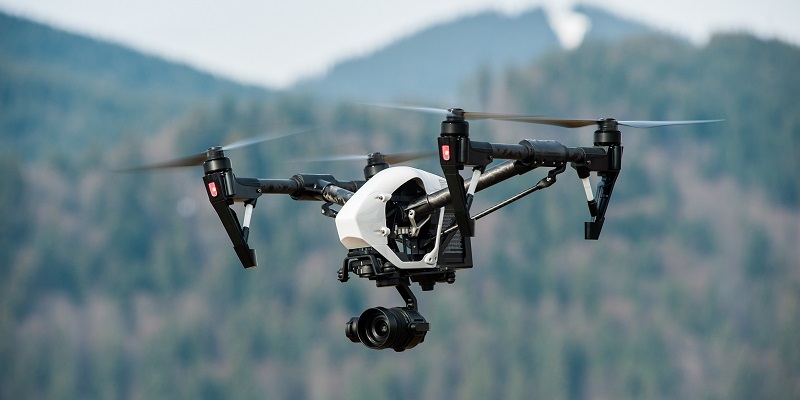

Unmanned aerial vehicles, or UAVs, are usually referred to simply as ‘drones’, although this name is sometimes applied to ground or water-based vehicles as well. The aerial platforms known as UAVs usually rely on a combination of vertical propellors that can provide balance and stability, and, when paired with the proper sensors, an astounding navigational capability.
When robots travel on the ground, simply stopping the motors is enough to hold the robot steady. Obstacles approach only in a 2D plane around the robot (nearly 2D at least, the height of the robot adds a limited 3rd dimensional sensing field). But drones are different in nearly every aspect.
Flying platforms are subject to forces of wind and updrafts even when stationary. Obstacles must be monitored in all directions, especially when ascending or descending in elevation. Since constant power is required even while light weight is essential, the battery powering the platform is compact but very limited. While ground-based AMRs can achieve run times of many hours, drones are rarely seen flying more than a few minutes, opting instead for small, swappable batteries that can be recharged on the ground while the robot is flying on a new battery.

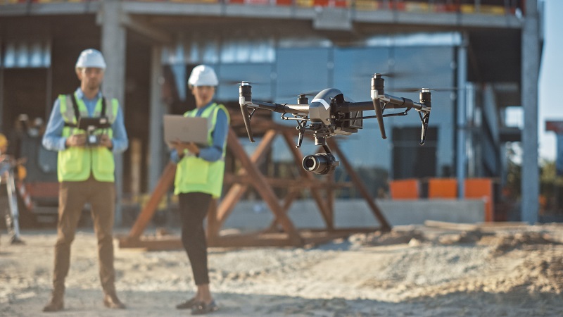

Since UAVs are air-based vehicles, any application that requires visibility and access above ground is an ideal application. Inspection of construction and development zones, infrastructure (dams, chemical storage tanks, etc), counting of livestock or wildlife (although there are legitimate concerns with UAV noise scaring animals), application of agricultural applications (fertilizer, pesticide, etc in small batches).

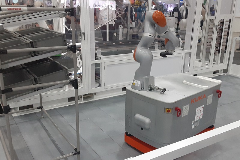

Some designs are not new entirely, but they exist as combinations of reliable technology. One such example is a mobile platform outfitted with a collaborative robot arm. This partnership is still safe for work near humans, and can aid in the manipulation of tasks across a much larger geographical range than a fixed robot base. Extra challenges are certainly unsurprising, such as batter power requirements, navigating to points in space when the base is in motion, and the extra force and inertia of a moving payload on top of a cart.
