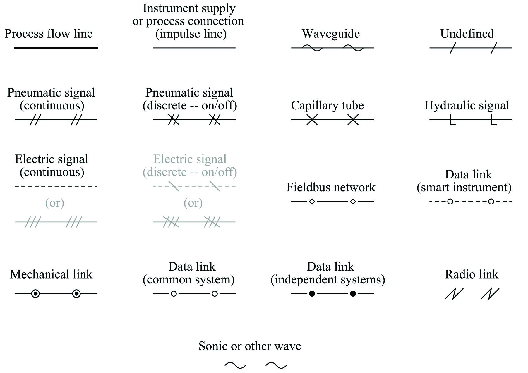

Line types
Note: the single backslash signifying a “discrete” or “binary” signal type has been removed from the ISA standard as of the 2009 ANSI publication. Regular pneumatic and electrical line symbols may represent either continuous or discrete states. The “triple-slash” alternative linetype for electrical symbols is also absent from the 2009 ANSI/ISA standard.

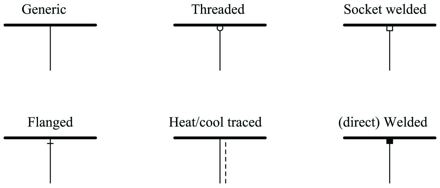

Process/Instrument line connections

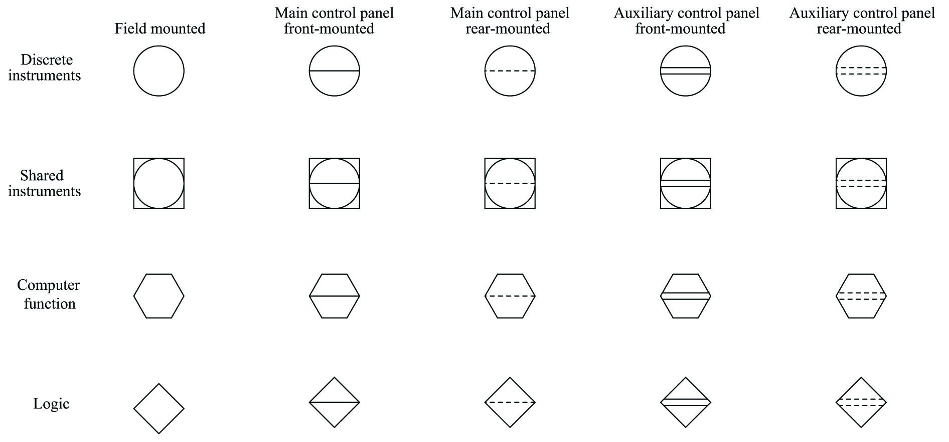

Instrument bubbles

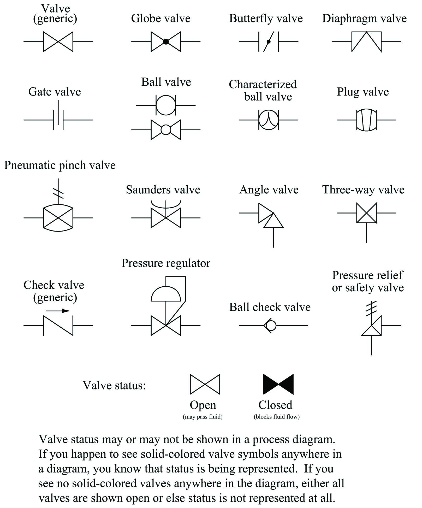

Process valve types

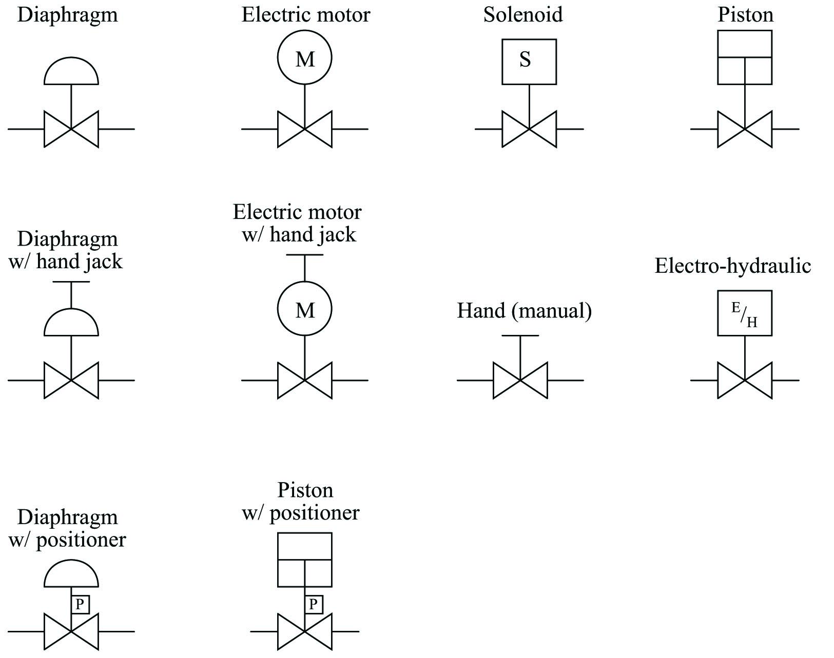

Valve actuator types

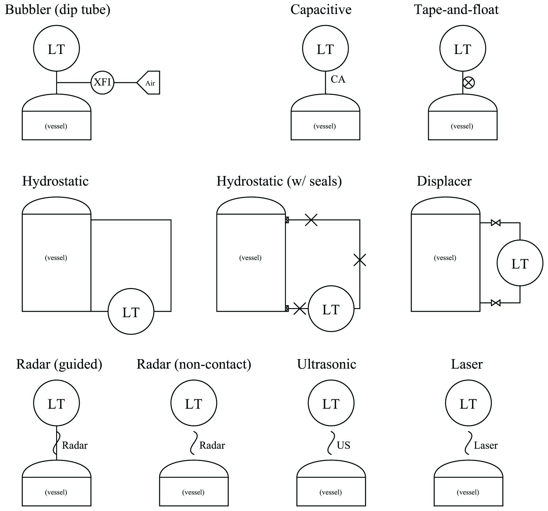

Liquid level measurement devices

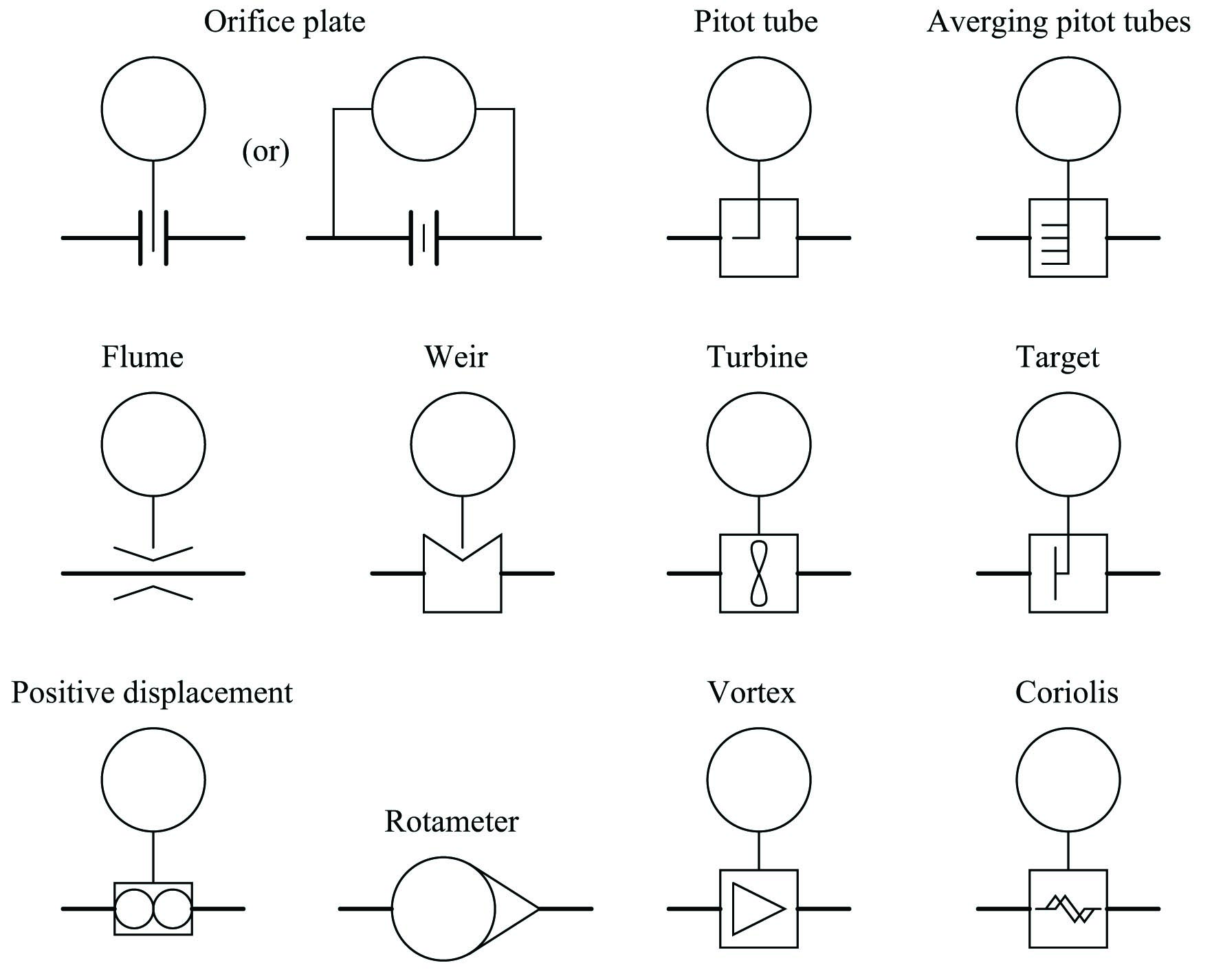

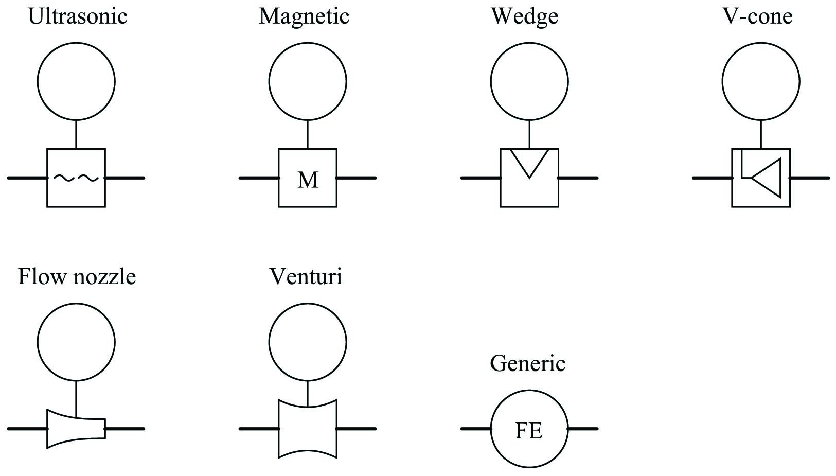

Flow measurement devices (flowing left-to-right)

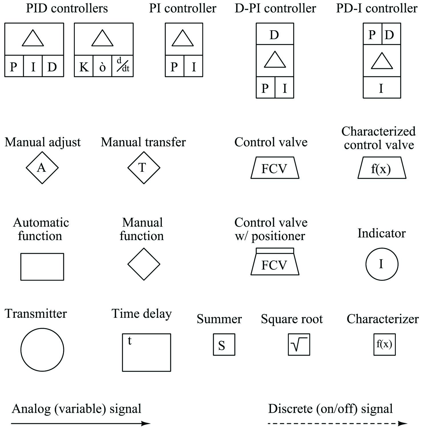

Functional diagram symbols

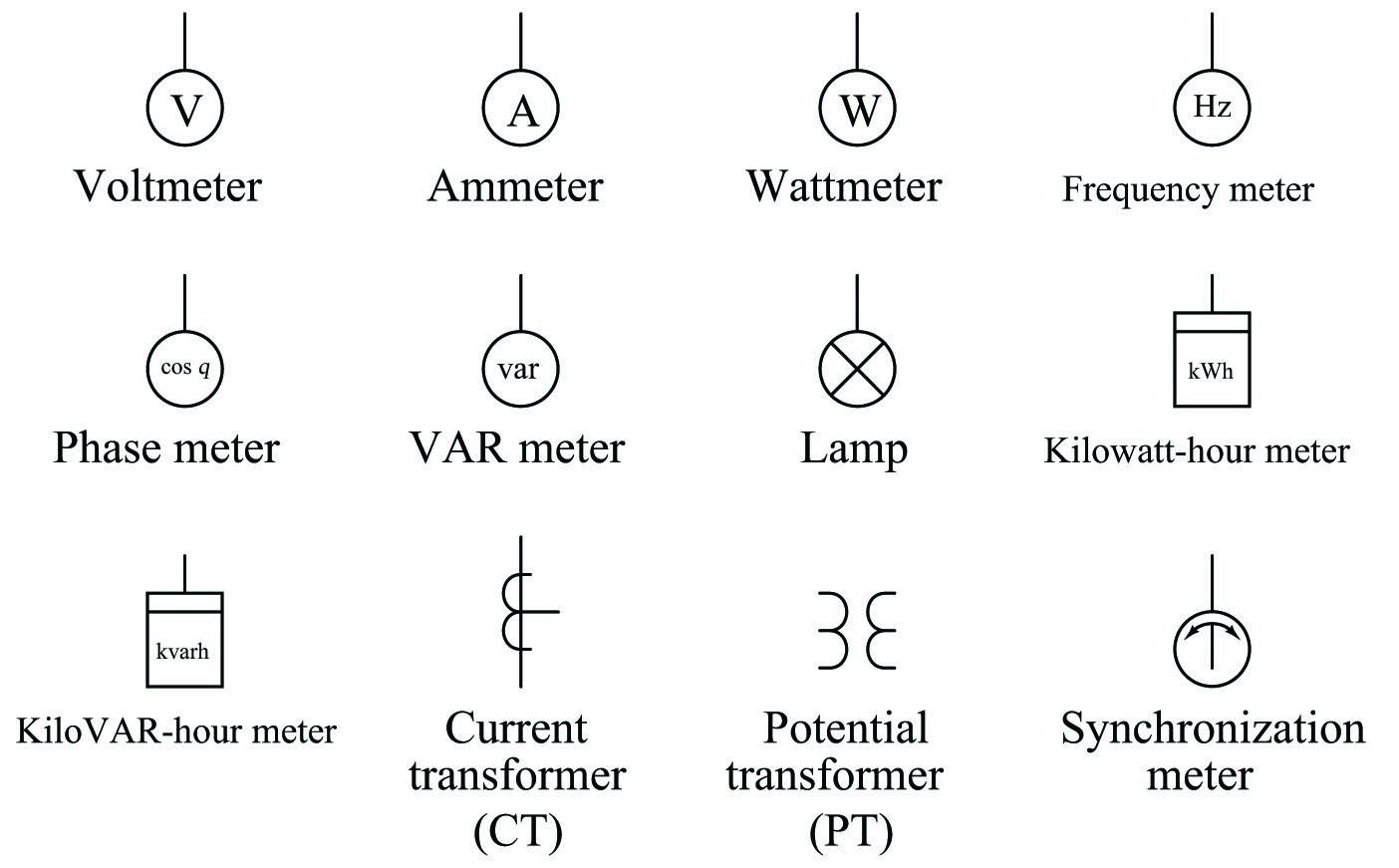

Single-line electrical diagram symbols

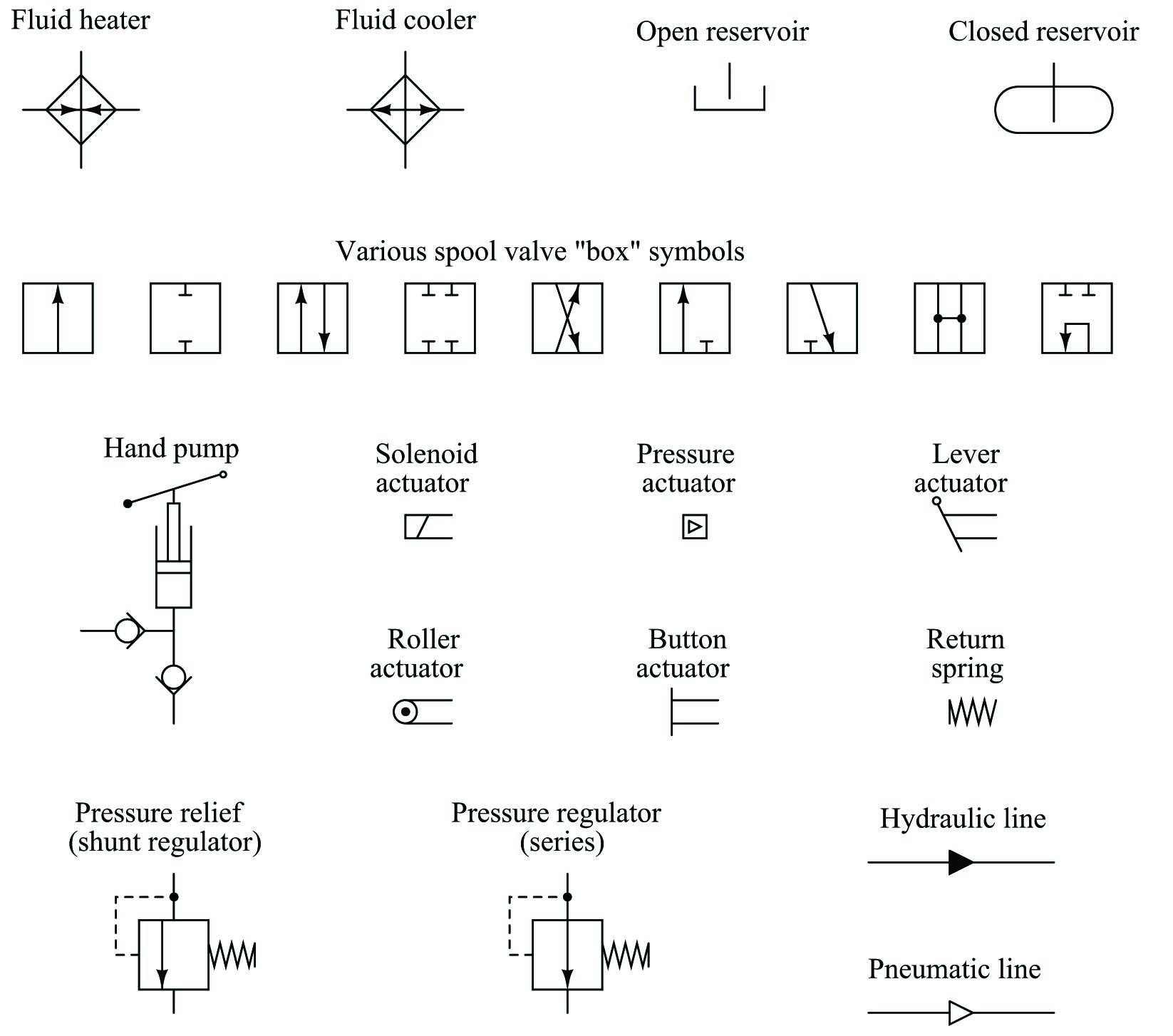

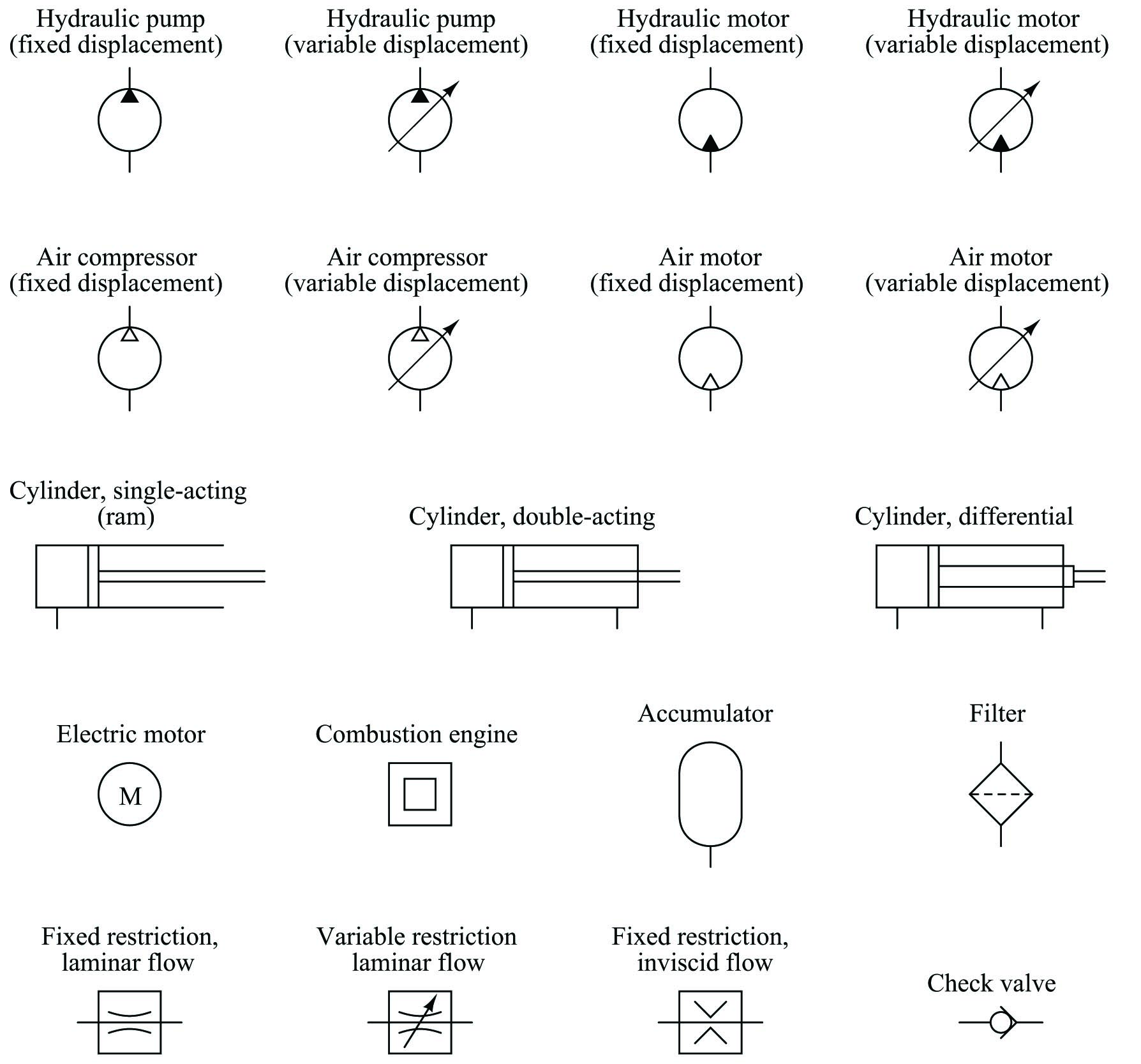

Fluid power diagram symbols
