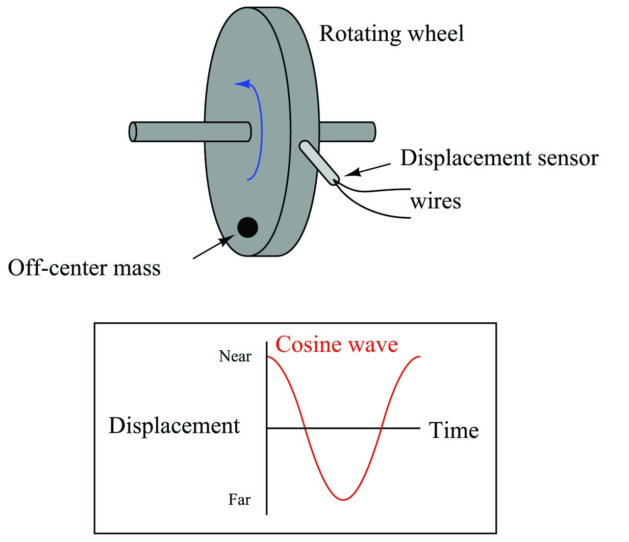

If a rotating wheel is unbalanced by the presence of an off-center mass, the resulting vibration will take the form of a cosine wave as measured by a displacement (position) sensor near the periphery of the object (assuming an angle of zero is defined by the position of the displacement sensor). The displacement sensor measures the air gap between the sensor tip and the rim of the spinning wheel, generating an electronic signal (most likely a voltage) directly proportional to that gap:
Since the wheel’s shaft “bows” in the direction of the off-center mass as it spins, the gap between the wheel and the sensor will be at a minimum at 0\(^{o}\), and maximum at 180\(^{o}\).

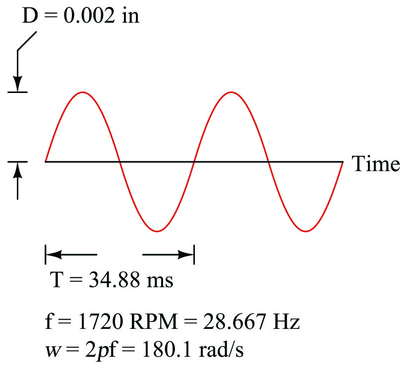

For a wheel spinning at 1720 RPM (approximately 180.1 radians per second), the angle between the off-center mass and the sensor will be as follows:
Time Angle (radians) Angle (deg) Angle (\(\cos \omega t\))
0 ms 0 rad 0\(^{o}\) +1
8.721 ms \(\pi \over 2\) rad 90\(^{o}\) 0
17.44 ms \(\pi\) rad 180\(^{o}\) -1
26.16 ms \(3 \pi \over 2\) rad 270\(^{o}\) 0
34.88 ms 0 rad 360\(^{o}\) or 0\(^{o}\) +1

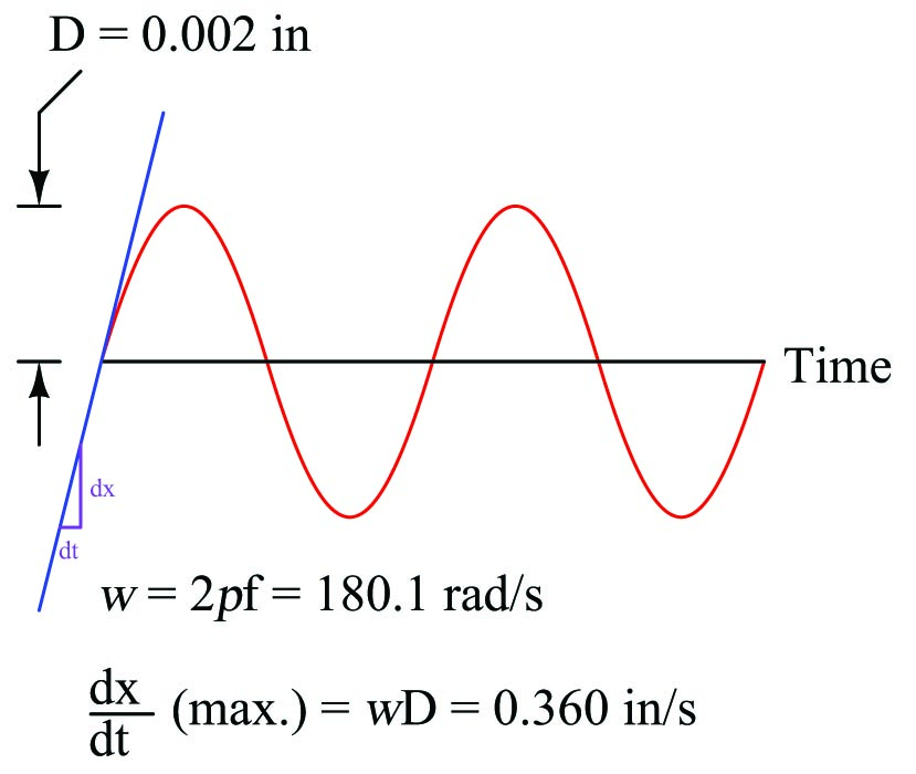

To give perspective to these units, it is helpful to consider a real application. Suppose we have a rotating machine vibrating in a sinusoidal (sine- or cosine-shaped) manner with a peak displacement (\(D\)) of 2 mils (0.002 inch) at a rotating speed of 1720 RPM (revolutions per minute). The frequency of this rotation is 28.667 Hz (revolutions per second), or 180.1 radians per second:
If \(D\) is the peak displacement of the sinusoid, then \(\omega D\) must be the peak velocity (maximum rate-of-change over time) of the sinusoid. This yields a peak velocity of 0.360 inches per second:
We may apply differentiation once more to obtain the acceleration of this machine’s rotating element. If \(D\) is the peak displacement of the sinusoid, and \(\omega D\) the peak velocity, then \(\omega^2 D\) will be its peak acceleration.
\[D = \hbox{Peak displacement} = 0.002 \hbox{ in}\]
\[\omega D = \hbox{Peak velocity} = 0.360 \hbox{ in/s}\]
\[\omega^2 D = \hbox{Peak acceleration} = 64.9 \hbox{ in/s}^2\]

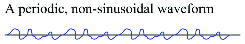

Normal machine vibrations rarely take the form of perfect sinusoidal waves. Although typical vibration waveforms are periodic (i.e. they repeat a pattern over time), they usually do not resemble sine or cosine waves in their shape:
An unfortunate quality of non-sinusoidal waveforms is that they do not lend themselves as readily to mathematical analysis as sinusoidal waves. From the previous discussion on sinusoidal vibrations, we saw how simple it was to take the derivative of a sinusoidal waveform (\({d \over dt} \sin \omega t = \omega \cos \omega t\)), and how well this worked to predict velocity and acceleration from a function describing displacement. Most non-sinusoidal waveforms cannot be expressed as simply and neatly as \(\sin \omega t\), however, and as such are not as easy to mathematically analyze.
Fortunately, though, there is a way to represent non-sinusoidal waveforms as combinations of sinusoidal waveforms. The French mathematician and physicist Jean Baptiste Joseph Fourier (1768-1830) proved mathematically that any periodic waveform, no matter how strange or asymmetrical its shape may be, may be replicated by a specific sum of sine and cosine waveforms of integer-multiple frequencies. That is, any periodic waveform (a periodic function of time, \(f(\omega t)\) being the standard mathematical expression) is equivalent to a series of the following form:

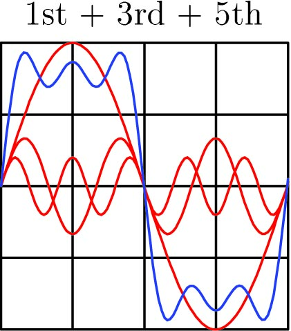

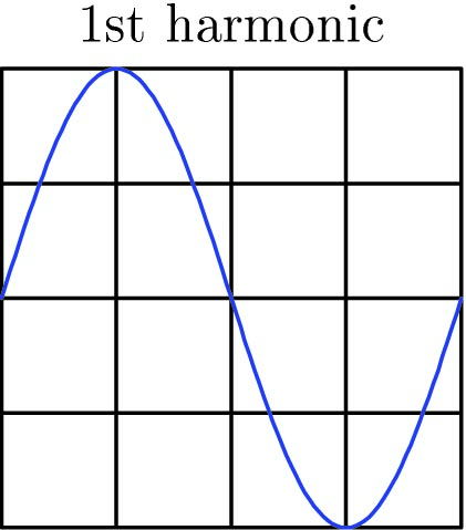

One of the most visually convincing examples of Fourier’s theorem is the ability to describe a square wave as a series of sine waves. Intuition would suggest it is impossible to synthesize a sharp-edged waveform such as a square wave using nothing but rounded sinusoids, but it is indeed possible if one combines an infinite series of sinusoids of successively higher harmonic frequencies, given just the right combination of harmonic frequencies and amplitudes.
The Fourier series for a square wave is as follows:
\[\hbox{Square wave} = 1 \sin \omega t + {1 \over 3} \sin 3 \omega t + {1 \over 5} \sin 5 \omega t + {1 \over 7} \sin 7 \omega t + \cdots\]

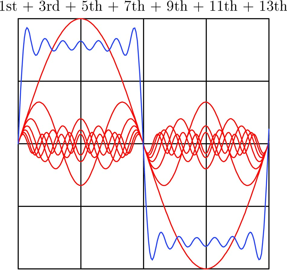

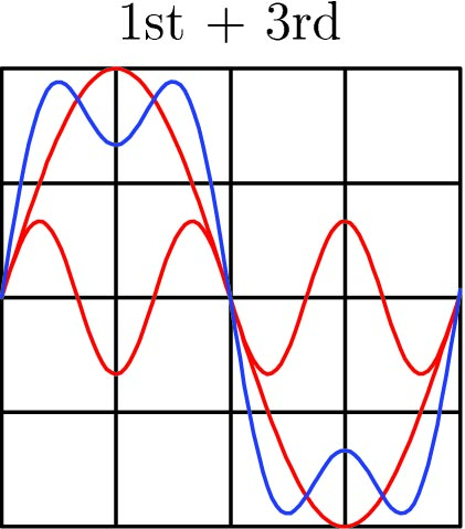

Such a series would be impossible to numerically calculate, but we may approximate it by adding several of the first (largest) harmonics together to see the resulting shape. In each of the following plots, we see the individual harmonic waveforms plotted in red, with the sum plotted in blue:

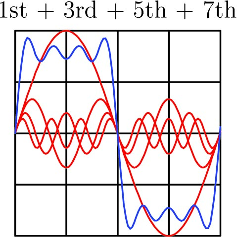

If we continue this pattern up to the 13th harmonic (following the same pattern of diminishing reciprocal amplitudes shown in the Fourier series for a square wave), we see the resultant sum looking more like a square wave:

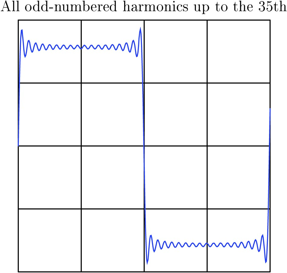

Continuing on to the 35th harmonic, the resultant sum looks like a square wave with ripples at each rising and falling edge:
If we were to continue adding successive terms in this infinite series, the resulting superposition of sinusoids would look more and more like a perfect square wave.

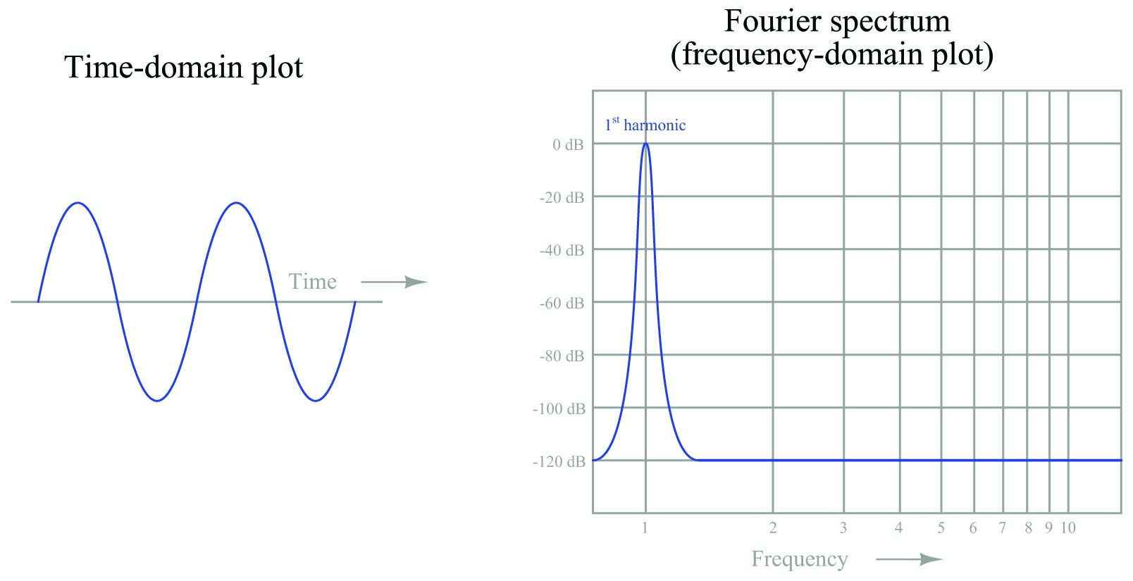

To illustrate the relationship between a waveform plotted with respect to time versus a Fourier analysis showing component frequencies, I will show a pair of Fourier spectrum plots for two waveforms – one a perfect sinusoid and the other a non-sinusoidal waveform. First, the perfect sinusoid:
Fourier spectra are often referred to as frequency-domain plots because the x-axis (the “domain” in mathematical lingo) is frequency. A standard oscilloscope-type plot is called a time-domain plot because the x-axis is time. In this first set of plots, we see a perfect sine wave reduced to a single peak on the Fourier spectrum, showing a signal with only one frequency (the fundamental, or 1st harmonic). Here, the Fourier spectrum is very plain because there is only one frequency to display. In other words, the Fourier series for this perfect sinusoid would be:
\[f(\omega t) = 0 \cos \omega t + 1 \sin \omega t + 0 \cos 2 \omega t + 0 \sin 2 \omega t + \cdots 0 \cos n \omega t + 0 \sin n \omega t\]
Only the \(B_1\) coefficient has a non-zero value. All other coefficients are zero because it only takes one sinusoid to perfectly represent this waveform.

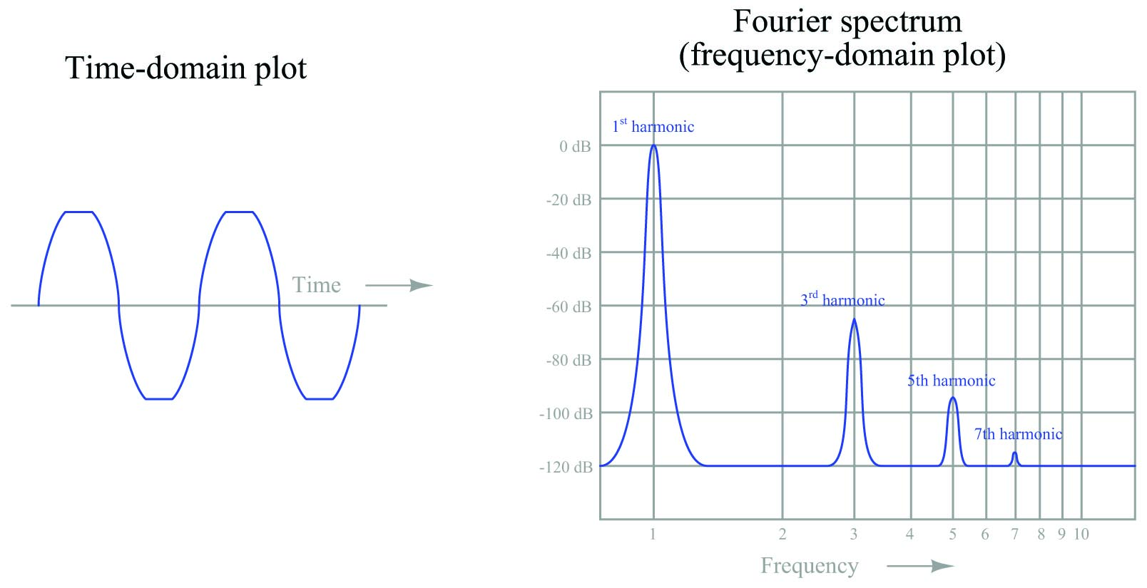

Next, we will examine the Fourier analysis of a non-sinusoidal waveform:
In this second set of plots, we see the waveform is similar to a sine wave, except that it appears “clipped” at the peaks. This waveform is obviously not a perfect sinusoid, and therefore cannot be described by just one of the terms (\(\sin \omega t\)) in a Fourier series. It can, however, be described as equivalent to a series of perfect sinusoids summed together. In this case, the Fourier spectrum shows one sinusoid at the fundamental frequency, plus another (smaller) sinusoid at three times the fundamental frequency (\(3 \omega\)), plus another (yet smaller) sinusoid at the 5th harmonic and another (smaller still!) at the 7th: a series of odd-numbered harmonics.
If each of these harmonics is in phase with each other, we could write the Fourier series as a set of sine terms:
\[f(\omega t) = (0 \hbox{ dB}) \sin \omega t + (-65 \hbox{ dB}) \sin 3 \omega t + (-95 \hbox{ dB}) \sin 5 \omega t + (-115 \hbox{ dB}) \sin 7 \omega t\]
Translating the decibel amplitude values into simple coefficients, we can see just how small these harmonic sinusoids are in comparison to the fundamental:
\[f(\omega t) = 1 \sin \omega t + 0.000562 \sin 3 \omega t + 0.0000178 \sin 5 \omega t + 0.00000178 \sin 7 \omega t\]
If the waveform deviated even further from a perfect sinusoid, we would see a Fourier spectrum with taller harmonic peaks, and perhaps more of them (possibly including some even-numbered harmonics, not just odd-numbered), representing a harmonically “richer” spectrum.
