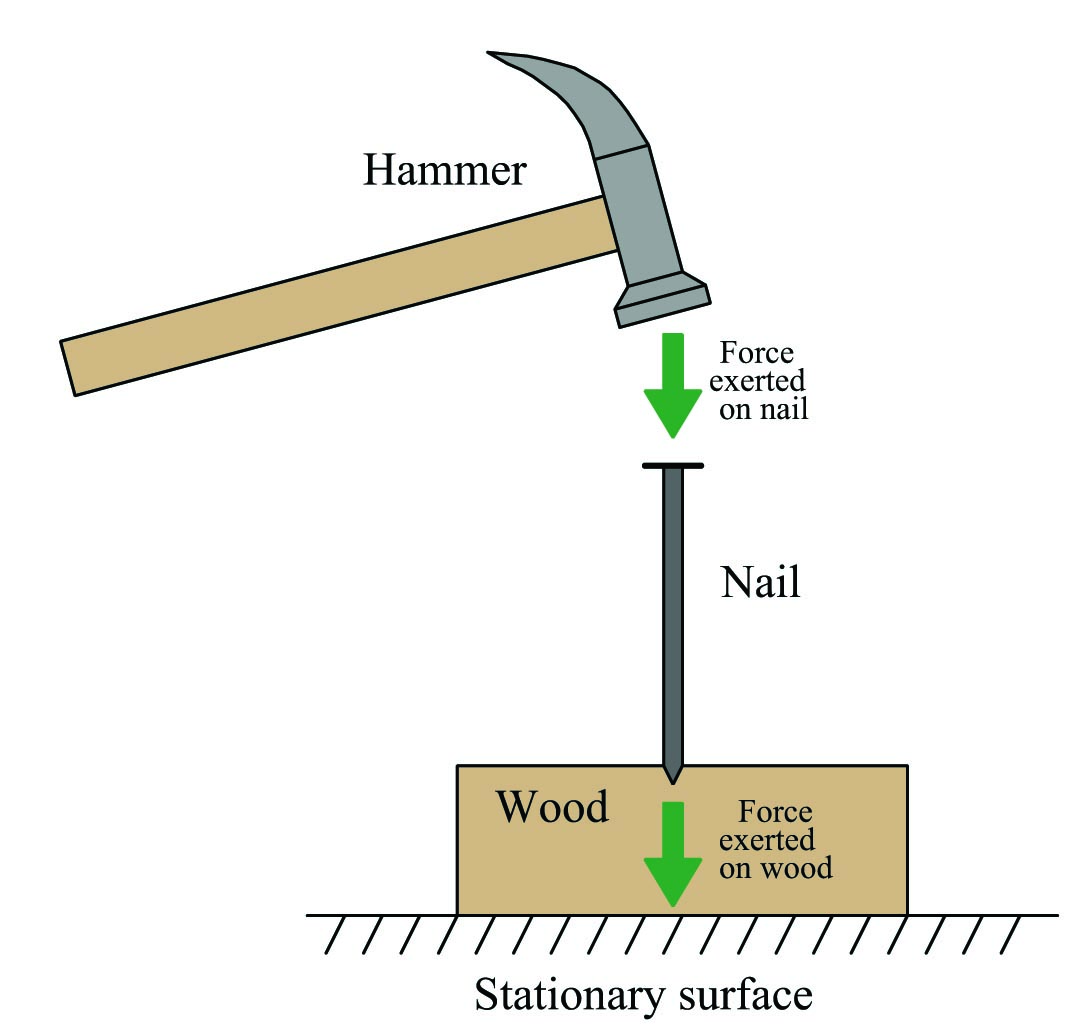

Due to their lack of definite shape, fluids tend to disperse any force applied to them. This stands in marked contrast to solids, which tend to transfer force only in the applied direction. Take for example the force transferred by a nail, from a hammer to a piece of wood:
The impact of the hammer’s blow is directed straight through the solid nail into the wood below – nothing surprising here.

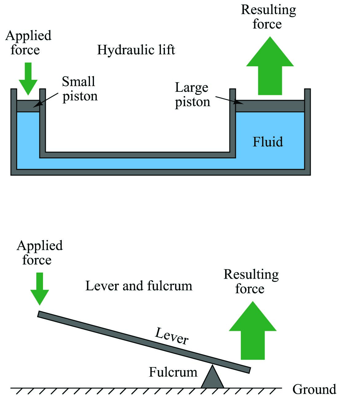

The even distribution of force throughout a fluid has some very practical applications. One application of this principle is the hydraulic lift, which functions somewhat like a fluid lever:
Force applied to the small piston creates a pressure throughout the fluid. That pressure exerts a greater force on the large piston than what is exerted on the small piston, by a factor equal to the ratio of piston areas. Since area for a circular piston is proportional to the square of the radius (\(A = \pi r^2\)), even modest ratios of piston diameter yield large ratios of area and therefore of force. If the large piston has five times the area of the small piston (i.e. the large piston’s diameter is 2.236 times greater than the small piston’s diameter), force will be multiplied five-fold. Just as with the lever, however, there must be a trade-off so as to not violate the Conservation of Energy. The trade-off for increased force is decreased distance, whether in the lever system or in the hydraulic lift system. If the large piston generates a force five times greater than what is applied to the small piston, it must move only one-fifth as far as the small piston’s motion. In this way, energy in equals energy out (remember that work, which is equivalent to energy, is calculated by multiplying force by parallel distance traveled).
For those familiar with electricity, what you see here in either the lever system or the hydraulic lift is analogous to a transformer: we can step AC voltage up, but only by reducing AC current. Being a passive device, a transformer cannot boost power. Therefore, power out can never be greater than power in, and given a perfectly efficient transformer, power out will always be precisely equal to power in:
\[\hbox{Power} = (\hbox{Voltage in}) (\hbox{Current in}) = (\hbox{Voltage out}) (\hbox{Current out})\]
\[\hbox{Work} = (\hbox{Force in}) (\hbox{Distance in}) = (\hbox{Force out}) (\hbox{Distance out})\]

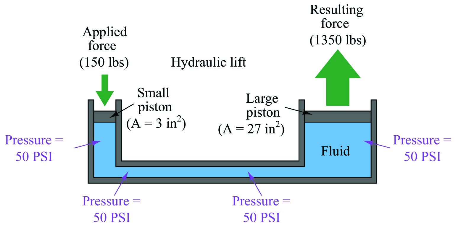

We learned earlier that fluids tend to evenly distribute any applied force. This fundamental principle is the basis of fluid power and fluid signaling systems, where pressure is assumed to be transferred equally to all points in a confined fluid. In the example of a hydraulic lift given earlier, we assume that the pressure throughout the fluid pathway is equal:
If additional force is applied to the small piston (say, 160 lbs instead of 150 lbs), the fluid pressure throughout the system will increase, not just the fluid pressure in the vicinity of the piston. The effect of this additional force will be immediately “felt” at all points of the system. The phenomenon of pressure changes being evenly distributed throughout an enclosed fluid is called Pascal’s principle.
Pascal’s principle is really nothing more than the direct consequence of fluids’ ability to flow. The only way an additional applied pressure would not be transmitted to all points within a confined fluid volume is if the fluid molecules were somehow not free to move. Since they are mobile, any compression applied to one region of that fluid will propagate to all other regions within that fluid volume. As fluid molecules are subjected to greater pressure, they naturally try to migrate to regions of lower pressure where they “bump up” against other fluid molecules, distributing that increased pressure in doing so.
Pascal’s principle tells us any change in applied pressure to a confined fluid will be distributed evenly throughout, but it does not say pressure will be the same throughout all points. If forces other than those applied to pistons exert pressure on the fluid, we may indeed experience gradients of pressure throughout a confined fluid volume.

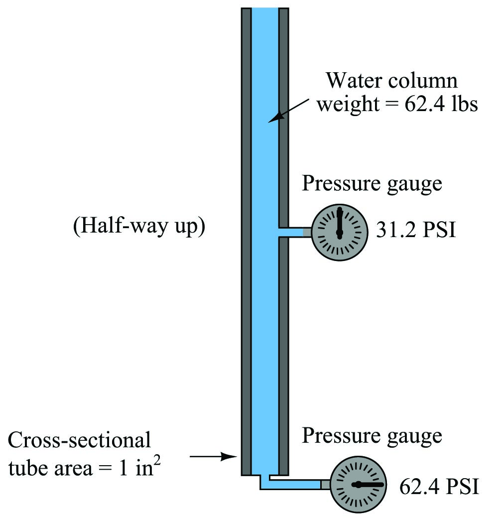

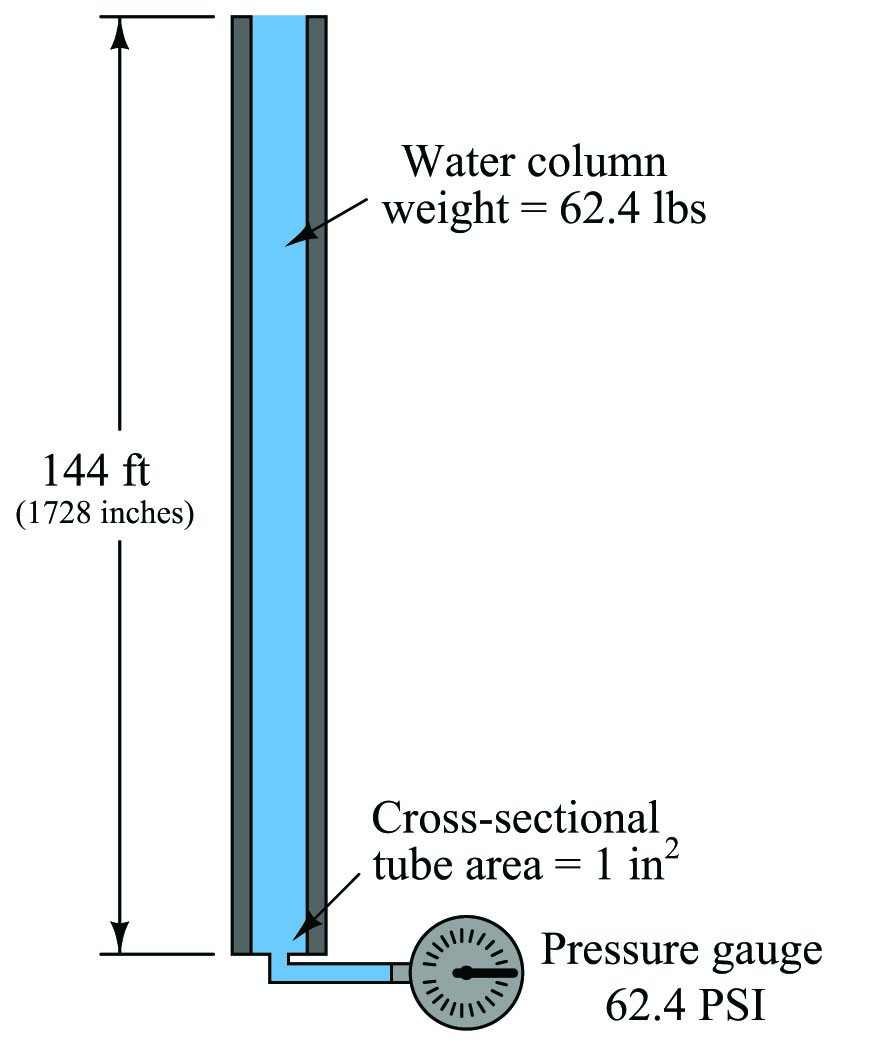

In cases where we are dealing with tall columns of dense fluid, there is another force we must consider: the weight of the fluid itself. Suppose we took a cubic foot of water which weighs approximately 62.4 pounds, and poured it into a very tall vertical tube with a cross-sectional area of 1 square inch:
Naturally, we would expect the pressure measured at the bottom of this tall tube to be 62.4 pounds per square inch, since the entire column of water (weighing 62.4 pounds) has its weight supported by one square inch of area.
If we placed another pressure gauge mid-way up the tube, though, how much pressure would it register? At first you might be inclined to say 62.4 PSI as well, because you learned earlier in this lesson that fluids naturally distribute force throughout their bulk. However, in this case the pressure is not the same mid-way up the column as it is at the bottom:
The reason for this apparent discrepancy is that the source of pressure in this fluid system comes from the weight of the water column itself. Half-way up the column, the water only experiences half the total weight (31.2 pounds), and so the pressure is half of what it is at the very bottom. We did not consider this effect before, because we assumed the force exerted by the piston in the hydraulic lift was so large it “swamped” the weight of the fluid itself. Here, with our very tall column of water (144 feet tall!), the effect of gravity upon the water’s mass is quite substantial. Indeed, without a piston to exert an external force on the water, weight is the only source of force we have to consider when calculating pressure.
This fact does not invalidate Pascal’s principle. Any change in pressure applied to the fluid column will still be distributed equally throughout. For example, if we were to place a piston at the top of this fluid column and apply a force to the fluid, pressure at all points in that fluid column would increase by the same amount. This is not the same as saying all pressures will be equal throughout the column, however.

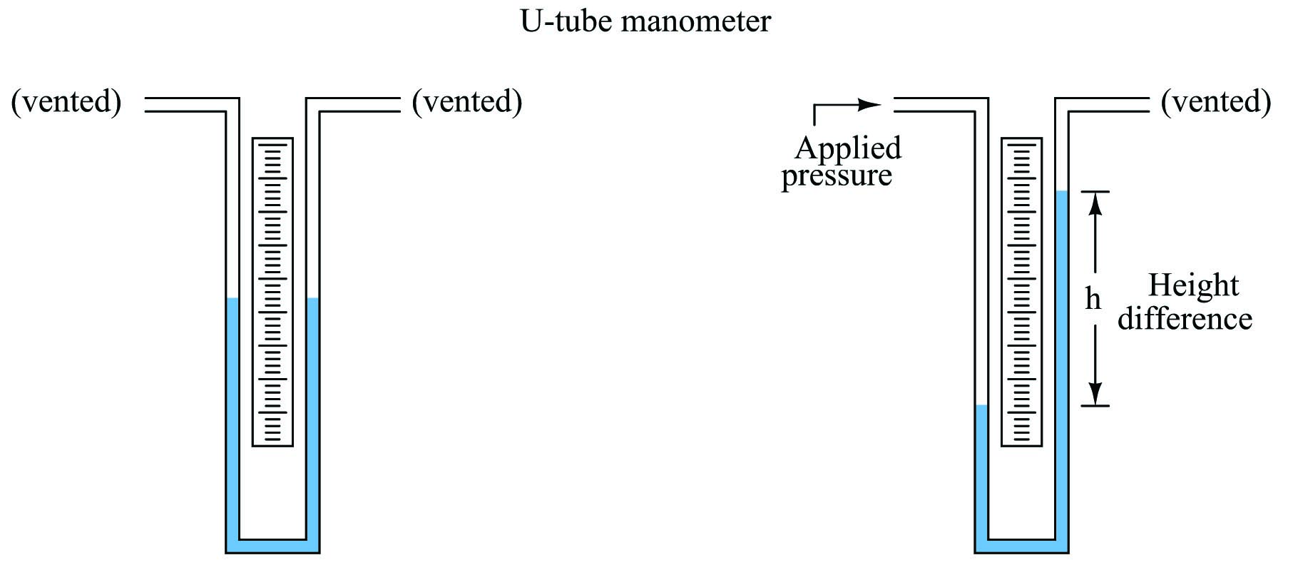

Expressing fluid pressure in terms of a vertical liquid column makes perfect sense when we use a very simple kind of motion-balance pressure instrument called a manometer. A manometer is nothing more than a piece of clear (glass or plastic) tubing filled with a liquid of known density, situated next to a scale for measuring distance. The most basic form of manometer is the U-tube manometer, shown here:
The basis for all manometers is the mathematical relationship between a liquid’s density (\(\rho\) in mass units or \(\gamma\) in weight units) and vertical height. The diameter of the manometer tubes is irrelevant:
\[P = \rho g h\]
\[P = \gamma h\]
Pressure is read on the scale as the difference in height (\(h\)) between the two liquid columns. One nice feature of a manometer is it really cannot become “uncalibrated” so long as the fluid is pure and the assembly is maintained in an upright position. If the fluid used is water, the manometer may be filled and emptied at will, and even rolled up for storage if the tubes are made of flexible plastic.

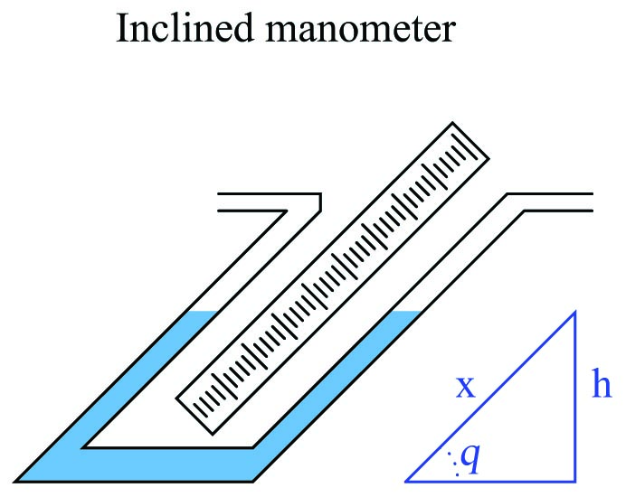

We may create even more sensitive manometers by purposely inclining one or more of the tubes, so that the liquid must travel a farther distance along the tube length to achieve the same vertical shift in height. This has the effect of “amplifying” the liquid’s motion to make it easier to resolve small pressures:
This way, a greater motion of liquid (\(x\)) is required to generate the same hydrostatic pressure (vertical liquid displacement, \(h\)) than in an upright manometer, making the inclined manometer more sensitive. As the similar triangle in the illustration shows, \(x\) and \(h\) are related trigonometrically by the sine function:
\[\sin \theta = {h \over x}\]
The difference in fluid column positions measured diagonally along the scale (\(x\)) must always be greater than the vertical height difference between the two columns (\(h\)) by a factor of \(1 \over {\sin \theta}\), which will always be greater than one for angles less than 90\(^{o}\). The smaller the angle \(\theta\), the greater the ratio between \(x\) and \(h\), leading to more sensitivity.

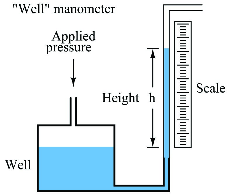

A common form of manometer seen in industrial instrument calibration shops is the well type, consisting of a single vertical tube and a relatively large reservoir (called the “well”) acting as the second column:
Due to the well’s much larger cross-sectional area, liquid motion inside of it is negligible compared to the motion of liquid inside the clear viewing tube. For all practical purposes, the liquid level inside the “well” is constant, and so the liquid inside the tube moves the full distance equivalent to the applied pressure. Thus, the well manometer provides an easier means of reading pressure: no longer does one have to measure the difference of height between two liquid columns, only the height of a single column.

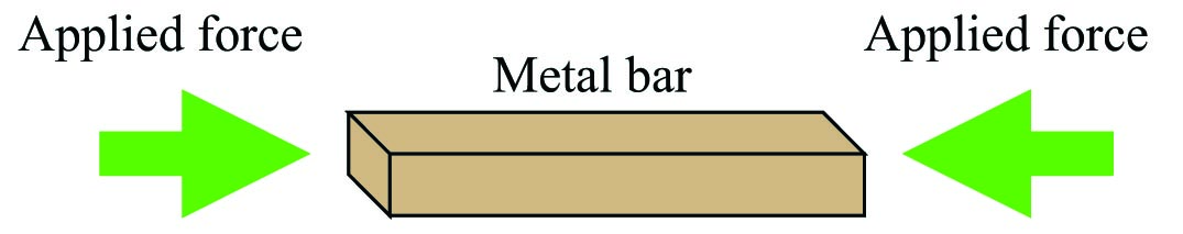

Let us begin our exploration of this concept by considering the case of weight applied to a solid metal bar:
Recall that pressure is defined as force exerted over area. This metal bar certainly has a cross-sectional area, and if a compressive force is applied to the bar then the molecules of metal inside the bar will experience a pressure attempting to force them closer together. Supposing the bar in question measured 1.25 inches wide and thick, its cross-sectional area would be (1.25 in)\(^{2}\), or 1.5625 in\(^{2}\). Applying a force of 80 pounds along the bar’s length would set up an internal pressure within the bar of 51.2 pounds per square inch, or 51.2 PSI:
Now suppose we reverse the direction of the applied force to the bar, applying tension to the bar rather than compression. If the force is still 80 pounds and the cross-sectional area is still 1.5625 square inches, then the internal pressure inside the bar must be \(-51.2\) PSI:
The negative pressure value describes the tensile force experienced by the molecules of metal inside the bar: a degree of force per unit area attempting to pull those molecules apart from each other rather than push them closer together as was the case with a compressive force.

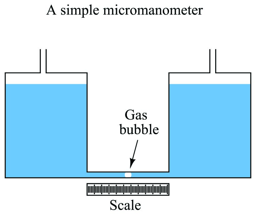

If even the smallest bubble of gas exists within a liquid sample, however, negative pressures become impossible. Since gases can only exert positive pressures, and Pascal’s Principle tells us that pressure will be equally distributed throughout a fluid sample, the low-limit of 0 PSIA for gases establishes a low pressure limit for the entire liquid/gas sample. In other words, the presence of any gas within an otherwise liquid sample prevents the entire sample from experiencing tension.
One limitation to the generation of negative pressures within liquids is that disturbances and/or impurities within the liquid may cause that liquid to spontaneously boil (changing phase from liquid to vapor), at which point a sustained negative pressure becomes impossible.

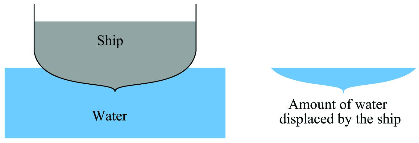

When a solid body is immersed in a fluid, it displaces an equal volume of that fluid. This displacement of fluid generates an upward force on the object called the buoyant force. The magnitude of this force is equal to the weight of the fluid displaced by the solid body, and it is always directed exactly opposite the line of gravitational attraction. This is known as Archimedes’ Principle.
Buoyant force is what makes ships float. A ship sinks into the water just enough so the weight of the water displaced is equal to the total weight of the ship and all it holds (cargo, crew, food, fuel, etc.):
If we could somehow measure the weight of that water displaced, we would find it exactly equals the dry weight of the ship:
Expressed mathematically, Archimedes’ Principle states that the buoyant force is the product of the liquid volume and liquid density:

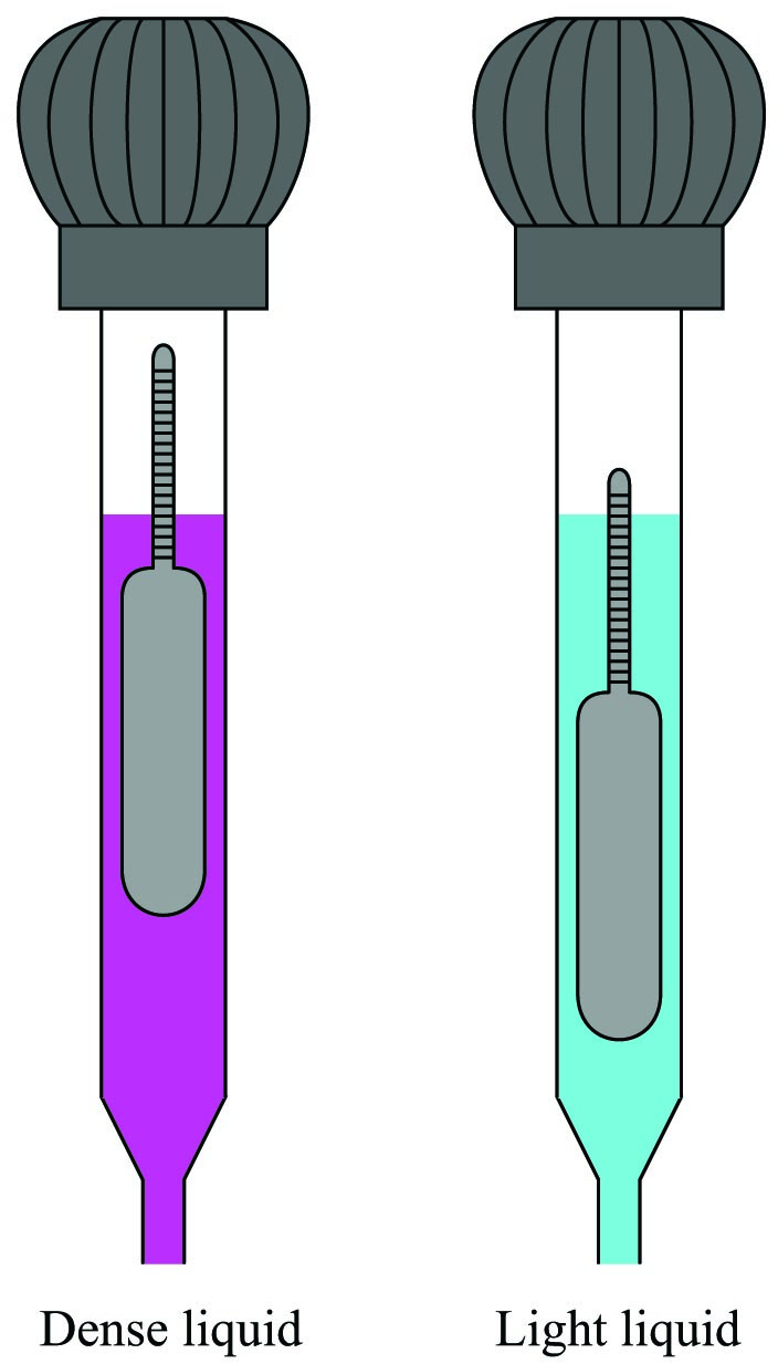

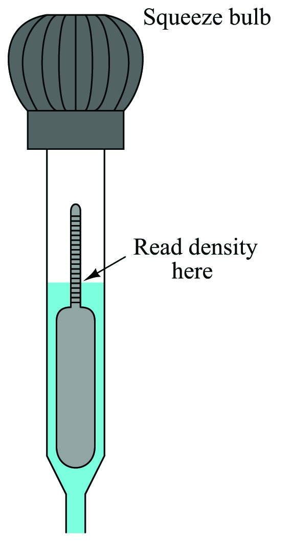

A simple style of hydrometer used to measure the density of lead-acid battery electrolyte is shown in this illustration:
To use this hydrometer, you must squeeze the rubber bulb at the top and dip the open end of the tube into the liquid to be sampled. Relaxing the rubber bulb will draw a sample of liquid up into the tube where it immerses the float. When enough liquid has been drawn into the tube to suspend the float so that it neither rests on the bottom of the tapered glass tube or “tops out” near the bulb, the liquid’s density may be read at the air/liquid interface.
A denser electrolyte liquid results in the float rising to a higher level inside the hydrometer tube:
Like all floating objects, the hydrometer float naturally seeks a condition of neutral buoyancy where the weight of the displaced liquid exactly equals the dry weight of the float. If the liquid happens to be very dense, the float will not have to sink very far in order to achieve neutral buoyancy; the less dense the liquid, the deeper the float must sink in order to achieve neutral buoyancy.
This means the float’s graduated density scale will read less density toward the top and greater density toward the bottom.

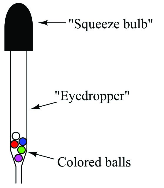

A less sophisticated version of hydrometer uses multiple balls of differing density. A common application for such a hydrometer is measuring the concentration of “antifreeze” coolant for automobile engines, comprised of a mixture of ethylene glycol and water. Ethylene glycol is a denser compound than water, and so a “stronger” mixture of antifreeze will have a greater bulk density than a “weaker” density of antifreeze. This style of hydrometer yields a crude measurement of ethylene glycol concentration based on the number of balls that float:
A greater number of floating balls represents a “stronger” concentration of glycol in the coolant. “Weak” glycol concentrations represent a greater percentage of water in the coolant, with a correspondingly higher freezing temperature.
Similar hydrometers are used to measure the concentration of sulfuric acid in lead-acid battery electrolyte, comprised of acid and water. The more fully charged a lead-acid battery is, the higher the concentration of sulfuric acid in the electrolyte fluid. The more discharged a lead-acid battery becomes, the less sulfuric acid (and the more water) is present in the electrolyte. Since sulfuric acid is a denser compound than water, measuring electrolyte density with a hydrometer yields a crude measurement of battery charge state.

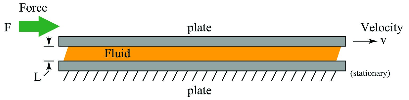

Viscosity is a measure of a fluid’s resistance to shear. It may be visualized as a sort of internal friction, where individual fluid molecules experience either cohesion or collision while flowing past one another. The more “viscous” a fluid is, the “thicker” it is when stirred. Clean water is an example of a low-viscosity liquid, while liquid honey at room temperature is an example of a high-viscosity liquid.
There are two different ways to quantify the viscosity of a fluid: absolute viscosity and kinematic viscosity. Absolute viscosity (symbolized by the Greek symbol “eta” \(\eta\), or sometimes by the Greek symbol “mu” \(\mu\)), also known as dynamic viscosity, is a direct relation between stress placed on a fluid and its rate of deformation (or shear). The textbook definition of absolute viscosity is based on a model of two flat plates moving past each other with a film of fluid separating them. The relationship between the shear stress applied to this fluid film (force divided by area) and the velocity/film thickness ratio is viscosity:
\[\eta = {FL \over Av}\]
Where,
\(\eta\) = Absolute viscosity (pascal-seconds), also symbolized as \(\mu\)
\(F\) = Force (newtons)
\(L\) = Film thickness (meters) – typically much less than 1 meter for any realistic demonstration!
\(A\) = Plate area (square meters)
\(v\) = Relative velocity (meters per second)
Another common unit of measurement for absolute viscosity is the poise, with 1 poise being equal to 0.1 pascal-seconds. Both units are too large for common use, and so absolute viscosity is often expressed in centipoise. Water has an absolute viscosity of very nearly 1.000 centipoise.

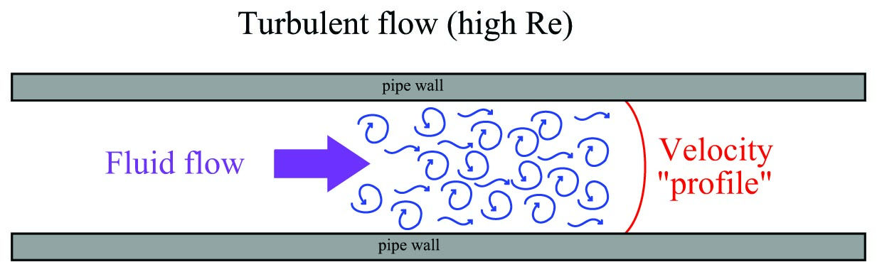

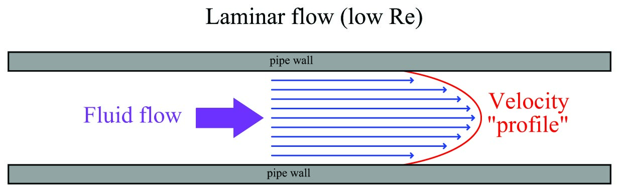

The Reynolds number of a fluid stream may be used to qualitatively predict whether the flow regime will be laminar or turbulent. Low Reynolds number values predict laminar (viscous) flow, where fluid molecules move in straight “stream-line” paths, and fluid velocity near the center of the pipe is substantially greater than near the pipe walls:
High Reynolds number values predict turbulent (inviscid) flow, where individual molecule motion is chaotic on a microscopic scale, and fluid velocities across the face of the flow profile are similar:
It should be emphasized that this turbulence is microscopic in nature, and occurs even when the fluid flows through a piping system free of obstructions, rough surfaces, and/or sudden directional changes. At high Reynolds number values, turbulence simply happens.
Other forms of turbulence, such as eddies and swirl are possible at high Reynolds numbers, but are caused by disturbances in the flow stream such as pipe elbows, tees, control valves, thermowells, and other irregular surfaces. The “micro-turbulence” naturally occurring at high Reynolds numbers will actually randomize such macroscopic (large-scale) motions if the fluid subsequently passes through a long enough length of straight pipe.
Turbulent flow is actually the desired condition for many industrial processes. When different fluids must be mixed together, for example, laminar flow is a bad thing: only turbulent flow will guarantee thorough mixing. The same is true for convective heat exchange: in order for two fluids to effectively exchange heat energy within a heat exchanger, the flow must be turbulent so that molecules from all portions of the flow stream will come into contact with the exchanger walls. Many types of flowmeters require a condition called fully-developed turbulent flow, where the flow profile is relatively flat and the only turbulence is that existing on a microscopic scale. Large-scale disturbances in the flow profile such as eddies and swirl tend to negatively affect the measurement performance of many flowmeter designs. This is why such flowmeters usually require long lengths of “straight-run” piping both upstream and downstream: to give micro-turbulence the opportunity to randomize any large-scale motions and homogenize the velocity profile.
A generally accepted rule-of-thumb is that Reynolds number values less than 2000 will probably be laminar, while values in excess of 10000 will probably be turbulent. There is no definite threshold value for all fluids and piping configurations, though. To illustrate, I will share with you some examples of Reynolds number thresholds for laminar versus turbulent flows given by various technical sources:

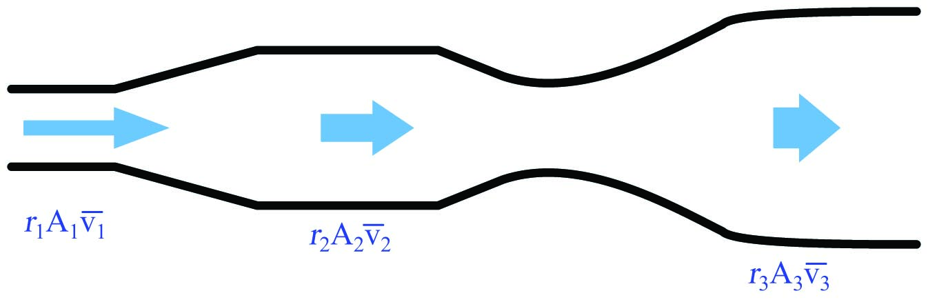

Any fluid moving through a pipe obeys the Law of Continuity, which states that the product of average velocity (\(\overline{v}\)), pipe cross-sectional area (\(A\)), and fluid density (\(\rho\)) for a given flow stream must remain constant:
[Law of Continuity]
\[\rho_1 A_1 \overline{v_1} = \rho_2 A_2 \overline{v_2} = \cdots \rho_n A_n \overline{v_n}\]

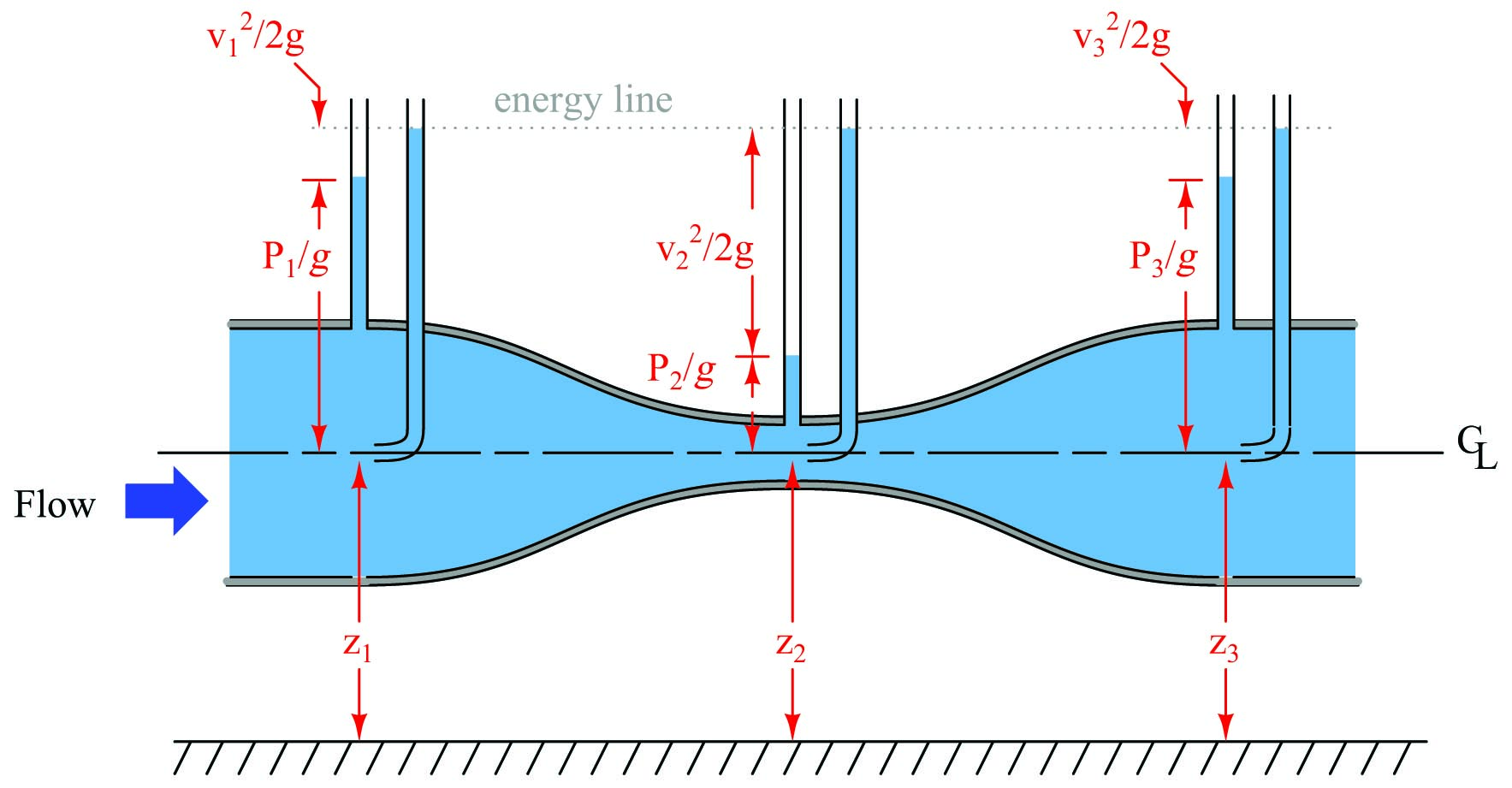

Bernoulli’s equation is an expression of the Law of Energy Conservation for an inviscid (frictionless) fluid stream, named after Daniel Bernoulli. It states that the sum total energy at any point in a passive fluid stream (i.e. no pumps or other energy-imparting machines in the flow path, nor any energy-dissipating elements) must be constant. Two versions of the equation are shown here:
\[z_1 \rho g + {v_1^2 \rho \over 2} + P_1 = z_2 \rho g + {v_2^2 \rho \over 2} + P_2\]
\[z_1 + {v_1^2 \over {2 g}} + {P_1 \over \gamma} = z_2 + {v_2^2 \over {2 g}} + {P_2 \over \gamma}\]
Where,
\(z\) = Height of fluid (from a common reference point, usually ground level)
\(\rho\) = Mass density of fluid
\(\gamma\) = Weight density of fluid (\(\gamma = \rho g\))
\(g\) = Acceleration of gravity
\(v\) = Velocity of fluid
\(P\) = Pressure of fluid
Each of the three terms in Bernoulli’s equation is an expression of a different kind of energy, commonly referred to as head:
\[z \rho g \hbox{\hskip 20pt Elevation head}\]
\[{v^2 \rho \over 2} \hbox{\hskip 20pt Velocity head}\]
\[P \hbox{\hskip 20pt Pressure head}\]
Elevation and Pressure heads are potential forms of energy, while Velocity head is a kinetic form of energy. Note how the elevation and velocity head terms so closely resemble the formulae for potential and kinetic energy of solid objects:

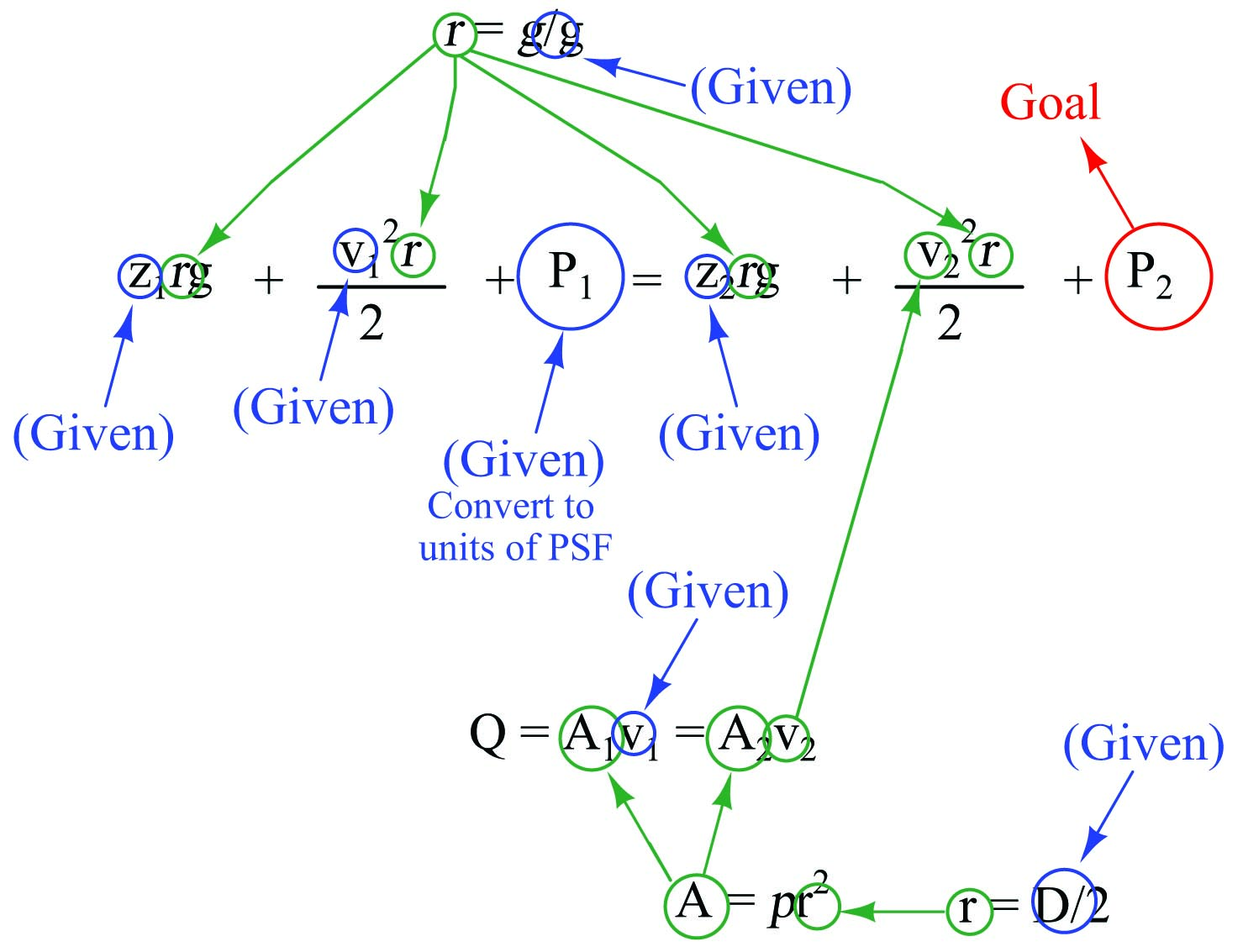

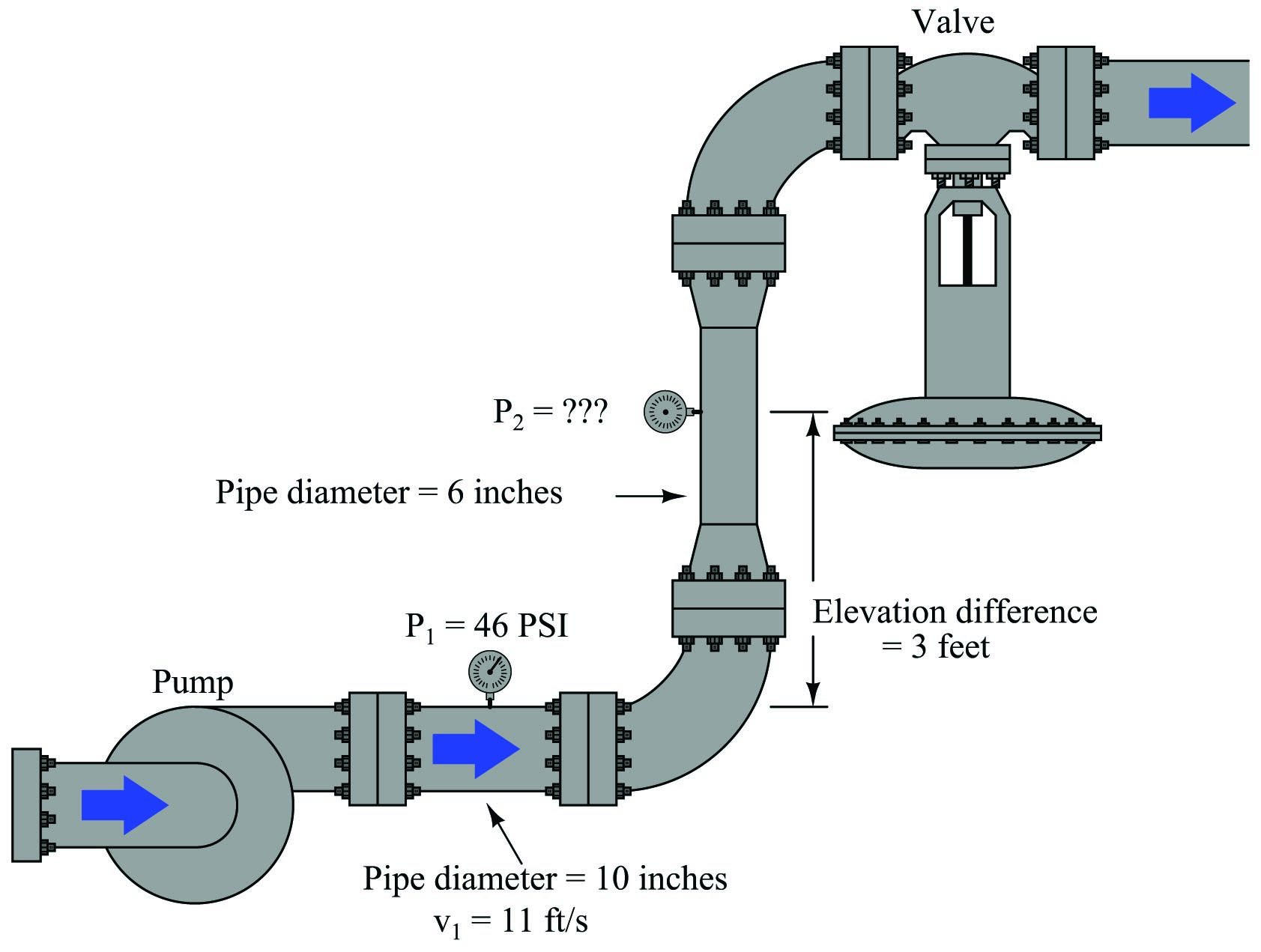

Applying Bernoulli’s equation to real-life applications can be a bit daunting, as there are so many different units of measurement to contend with, and so many calculations which must be precise in order to arrive at a correct final answer. The following example serves to illustrate how Bernoulli’s equation may be applied to the solution of pressure at a point in a water piping system, assuming no frictional losses anywhere in the system:
We know without a doubt that Bernoulli’s equation will be what we need to evaluate in order to solve for the unknown pressure \(P_2\), but where do we begin? A good place to start is by writing the equation we know we will need, then identifying all known values and all unknown values:
Here is a list of known values, given to us already:
| Known quantity | Comments |
| $z_1$ | 0 ft (arbitrarily assigned as 0 height) |
| $z_2$ | 3 ft (if $z_1$ is 0 feet, then $z_2$ is 3 ft above it) |
| $v_1$ | 11 ft/s |
| $P_1$ | 46 PSI (\textit{need to convert into PSF so all units match}) |
| $g$ | 32.2. ft/s$^{2}$ |
The conversion for \(P_1\) from units of PSI into units of PSF is quite simple: multiply 46 PSI by 144 to get 6624 PSF.
Here is a list of values unknown to us at this time:
| Unknown quantity | Comments |
| $\rho$ | (needs to be in units of slugs/ft$^{3}$) |
| $v_2$ | (needs to be in units of ft/s just like $v_1$) |
| $P_2$ | (the quantity we are ultimately solving for) |
Now all we must do is solve for \(\rho\) and \(v_2\), and we will be ready to use Bernoulli’s equation to solve for \(P_2\). The important of identifying all the known and unknown quantities before beginning any calculations cannot be overstated. Doing so allows us to develop a plan for solving the problem. Without a plan, one has no idea of where or how to proceed, which is a condition many students repeatedly find themselves in when solving physics-type problems.
We know that \(\rho\) is an expression of mass density for the fluid, and we were told the fluid in this example is water. Water has a maximum density of 62.4 pounds per cubic foot, but this figure is not usable in our chosen form of Bernoulli’s equation because it is weight density (\(\gamma\)) and not mass density (\(\rho\)).
The relationship between weight density \(\gamma\) and mass density \(\rho\) is the exact same relationship between weight (\(F_W\)) and mass (\(m\)) in a gravitational field (\(g\)). Newton’s Second Law equation relating force to mass and acceleration (\(F = ma\)) works well to relate weight to mass and gravitational acceleration:
\[F = ma\]
\[F_W = mg\]
Dividing both sides of this equation by volumetric units (\(V\)) (e.g. cubic feet) gives us our relationship between \(\gamma\) and \(\rho\):
\[{F_W \over V} = {m \over V} g\]
\[\gamma = \rho g\]
Water has a weight density of 62.4 pounds per cubic foot in Earth gravity (32.2 feet per second squared), so:
\[\rho = {\gamma \over g}\]
\[\rho = {62.4 \hbox{ lb/ft}^3 \over 32.2 \hbox{ ft/s}^2} = 1.94 \hbox{ slugs/ft}^3\]
Now we may calculate the total value for the left-hand side of Bernoulli’s equation, representing the sum total of potential and kinetic heads for the fluid within the 10-inch pipe:
\[z_1 \rho g + {v_1^2 \rho \over 2} + P_1 = \hbox{Total head at 10-inch pipe}\]
| Head | Calculation at 10 inch pipe | Value |
| $z_1 \rho g$ | (0 ft) (1.94 slugs/ft$^{3}$) (32.2 ft/s$^{2}$) | 0 lb/ft$^{2}$ |
| $v_1^2 \rho / 2$ | (11 ft/s)$^{2}$ (1.94 slugs/ft$^{3}$) / 2 | 117.4 lb/ft$^{2}$ |
| $P_1$ | (46 lb/in$^{2}$) (144 in$^{2}$/1 ft$^{2}$) | 6624 lb/ft$^{2}$ |
| Total | 0 lb/ft$^{2}$ + 117.4 lb/ft$^{2}$ + 6624 lb/ft$^{2}$ | 6741.4 lb/ft$^{2$} |
Note the absolutely consistent use of units: all units of distance are feet. All units of mass as slugs. All units of time are seconds. Failure to maintain consistency of units will result in (often severely) incorrect results!
There is one more unknown quantity to solve for before we may calculate values at the 6-inch pipe, and that unknown quantity is \(v_2\). We know that the Continuity equation gives us a mathematical relationship between volumetric flow (\(Q\)), pipe area (\(A\)), and velocity (\(v\)):
\[Q = A_1 v_1 = A_2 v_2\]
Looking at this equation, the only variable we know the value of at this point is \(v_1\), and we need to find \(v_2\). However, if we could find the values of \(A_1\) and \(A_2\), and/or \(Q\), we would have the information we need to solve for \(v_2\), which in turn would give us the information we would need to solve for \(P_2\) in Bernoulli’s equation.
One way to approach this problem is to express the areas and velocities as ratios, eliminating \(Q\) entirely so all we need to find are \(A_1\) and \(A_2\):
\[{A_1 \over A_2} = {v_2 \over v_1}\]
The area of a circular pipe is given by the basic equation \(A = \pi r^2\). Since the problem gives us each pipe’s diameter (10 inches and 6 inches), we know the radii (5 inches and 3 inches, respectively) which we may then plug into our ratio equation:
\[{\pi (5\hbox{ in})^2 \over \pi (3\hbox{ in})^2} = {v_2 \over v_1}\]
\[{25 \over 9} = {v_2 \over v_1}\]
Knowing \(v_1\) has a value of 11 feet per second, the solution for \(v_2\) is now quite simple:
\[v_2 = 11 \hbox{ ft/s} \left({25 \over 9}\right)\]
\[v_2 = (11 \hbox{ ft/s}) (2.778) = 30.56 \hbox{ ft/s}\]
Finally, we have all the pieces necessary to solve for \(P_2\) in the right-hand side of Bernoulli’s equation:
\[z_2 \rho g + {v_2^2 \rho \over 2} + P_2 = \hbox{Total head at 6-inch pipe}\]
| Head | Calculation at 6 inch pipe | Value |
| $z_2 \rho g$ | (3 ft) (1.94 slugs/ft$^{3}$) (32.2 ft/s$^{2}$) | 187.4 lb/ft$^{2}$ |
| $v_2^2 \rho / 2$ | (30.56 ft/s)$^{2}$ (1.94 slugs/ft$^{3}$) / 2 | 905.6 lb/ft$^{2}$ |
| $P_2$ | (unknown) | |
| Total | 187.4 lb/ft$^{2}$ + 905.6 lb/ft$^{2}$ + $P_2$ | 1093 lb/ft$^{2$} + $P_2$ |
Knowing that the total head calculated at the first location was 6741.4 lb/ft\(^{2}\), and the Conservation of Energy requires total heads at both locations be equal (assuming no energy lost to fluid friction along the way), \(P_2\) must be equal to:
\[6741.4 \hbox{ lb/ft}^2 = 1093 \hbox{ lb/ft}^2 + P_2\]
\[P_2 = 6741.4 \hbox{ lb/ft}^2 - 1093 \hbox{ lb/ft}^2 = 5648.3 \hbox{ lb/ft}^2\]
Converting pounds per square foot into the more customary unit of pounds per square inch (PSI):
\[P_2 = (5648.3 \hbox{ lb/ft}^2) \left({1 \hbox{ ft}^2 \over 144 \hbox{ in}^2}\right)\]
\[P_2 = 39.2 \hbox{ lb/in}^2\]
Before discussing the larger meaning of our solution, it would be good to review the problem-solving plan we followed to calculate \(P_2\):
First, we identified Bernoulli’s equation as being the central equation necessary for solving \(P_2\). Then, we identified all the known variables within Bernoulli’s equation given to us in the problem, and also if there were any unit-conversion operations necessary. Next, we identified any unknown variables necessary to solve for \(P_2\) in Bernoulli’s equation. For each of those unknown variables, we found or developed equations to solve for them, based on variables known to us. The graphic shown above illustrates our plan of solution, with arrows showing the dependent relationships where equations supplied values for unknown quantities in other equations.
This is not just a problem-solving technique unique to Bernoulli’s equation; it is a general strategy applicable to any type of problem where multiple equations must be used to solve for some quantity. The study of physics is general is filled with problems like this!
Note how our calculated value for \(P_2\) at the second gauge is so much lower than the pressure at the first gauge: 39.2 PSI compared to 46 PSI. This represents nearly a 7 PSI decrease in pressure! Note also how little vertical distance separates the two gauges: only 3 feet. Clearly, the change in elevation between those two points in insufficient to account for the large loss in pressure. Given a 3 foot difference in elevation, one would expect a pressure reduction of about 1.3 PSI for a static column of water, but what we’re seeing in this piping system is a pressure drop of nearly 7 PSI. The difference is due to an exchange of energy from potential to kinetic form, as the fluid enters a much narrower pipe (6 inches instead of 10) and must increase velocity.
Furthermore, if we were to increase the flow rate discharged from the pump, resulting in even more velocity through the narrow pipe, pressure at \(P_2\) might even drop lower than atmospheric. In other words, Bernoulli’s equation tells us we can actually produce a vacuum by accelerating a fluid through a constriction. This principle is widely used in industry with devices known as eductors or ejectors: tapered tubes through which fluid flows at high velocity to produce a vacuum at the throat.

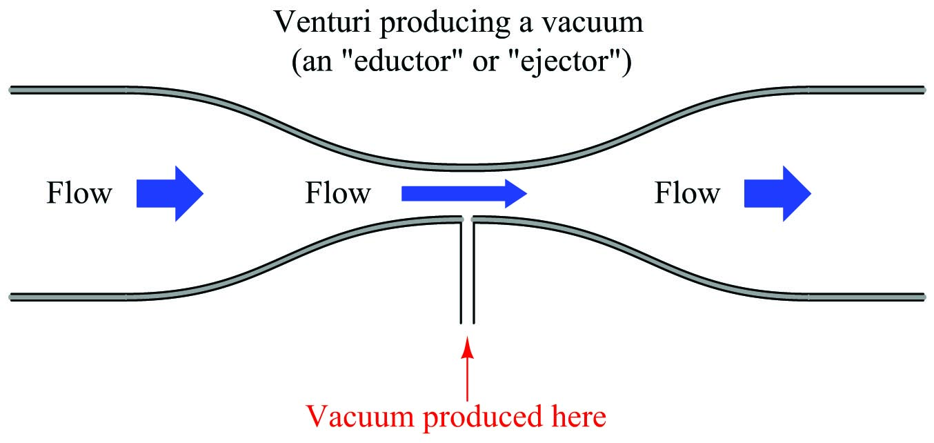

This, in fact, is how a carburetor works in an older automobile engine to vaporize liquid gasoline fuel into a stream of air drawn into the engine: the engine’s intake air passes through a venturi tube, where vacuum at the throat of the venturi produces enough negative pressure to draw liquid gasoline into the stream to produce a fine mist.

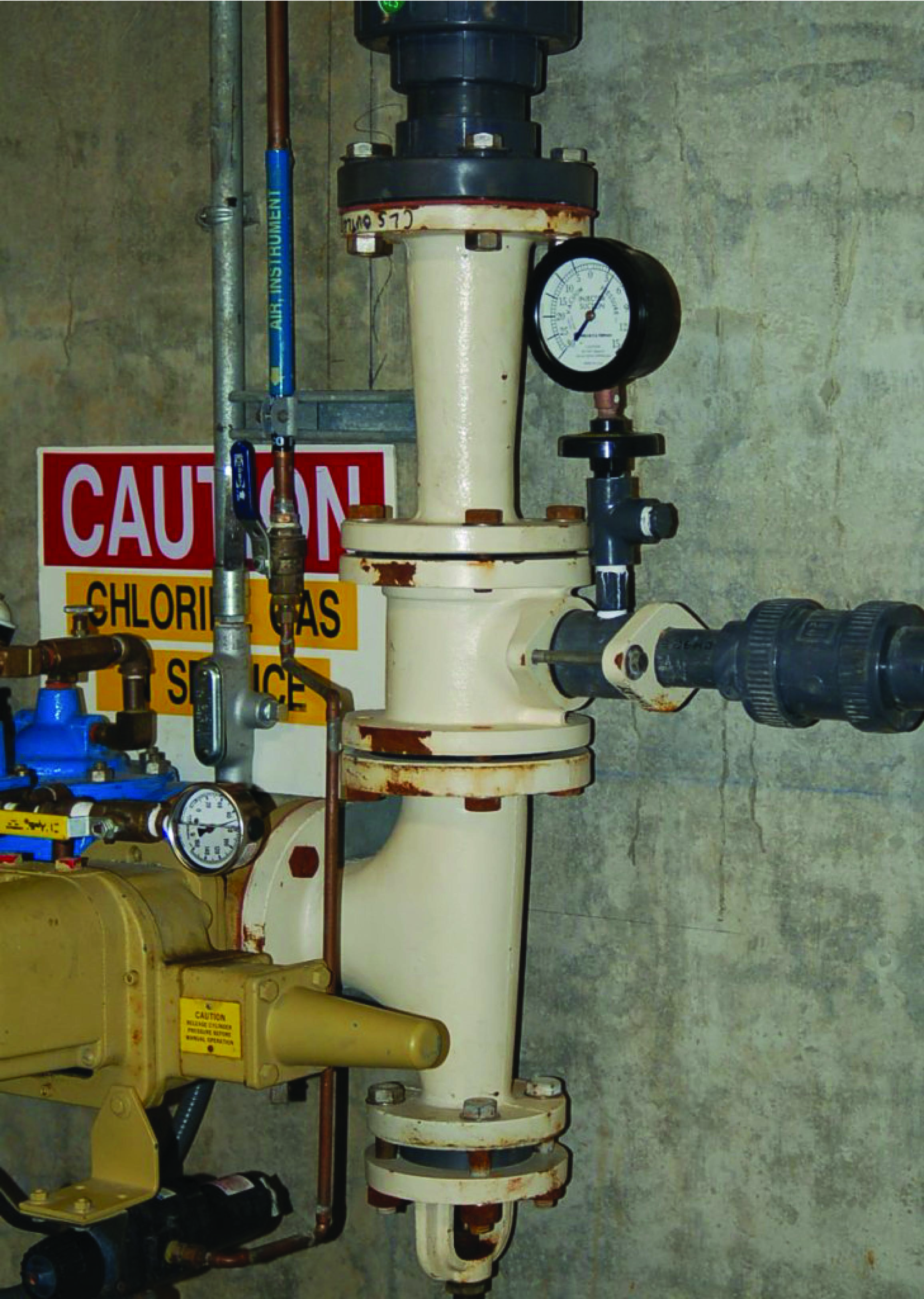

Ejectors use a high-velocity gas or vapor (e.g. superheated steam) to produce significant vacuums. Eductors use process liquid flow, such as the eductor shown in this next photograph where wastewater flow creates a vacuum to draw gaseous chlorine into the stream for biological disinfection:
Here, the eductor helps fulfill an important safety function. By creating a vacuum to draw toxic chlorine gas from the supply tank into the water stream, the chlorine gas piping may be continuously maintained at a slightly negative pressure throughout. If ever a leak were to develop in the chlorine system, this vacuum would cause ambient air to enter the chlorine pipe rather than toxic chlorine gas to exit the pipe, making a leak far less dangerous than if the chlorine gas piping were maintained in a pressurized state.

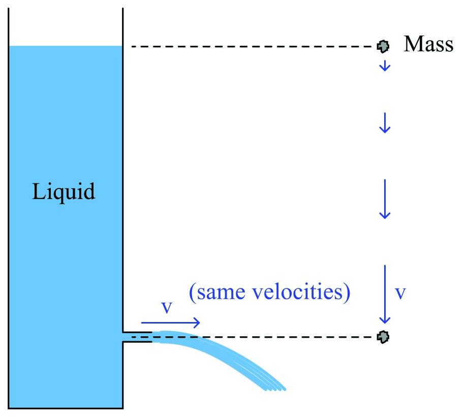

Torricelli’s equation
The velocity of a liquid stream exiting from a nozzle, pressured solely by a vertical column of that same liquid, is equal to the free-fall velocity of a solid mass dropped from the same height as the top of the liquid column. In both cases, potential energy (in the form of vertical height) converts to kinetic energy (motion):
This was discovered by Evangelista Torricelli almost 100 years prior to Bernoulli’s more comprehensive formulation. The velocity may be determined by solving for \(v\) after setting the potential and kinetic energy formulae equal to each other (since all potential energy at the upper height must translate into kinetic energy at the bottom, assuming no frictional losses):
\[mgh = {1 \over 2}mv^2\]
\[gh = {1 \over 2}v^2\]
\[2gh = v^2\]
\[v = \sqrt{2gh}\]
Note how mass (\(m\)) simply disappears from the equation, neatly canceling on both sides. This means the nozzle velocity depends only on height, not the mass density of the liquid. It also means the velocity of the falling object depends only on height, not the mass of the object.

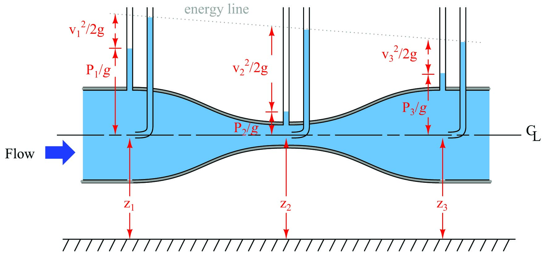

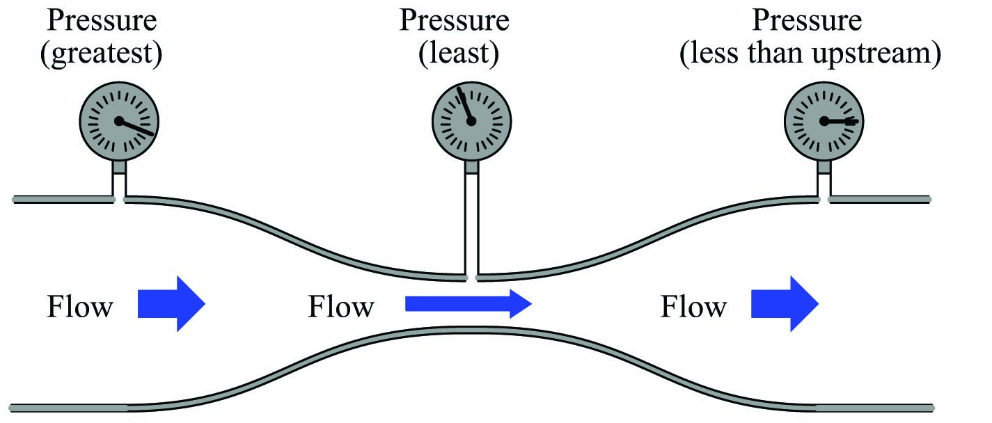

If an incompressible fluid moves through a venturi tube (i.e. a tube purposefully built to be narrow in the middle), the continuity principle tells us the fluid velocity must increase through the narrow portion. This increase in velocity causes kinetic energy to increase at that point. If the tube is level, there will be negligible difference in elevation (\(z\)) between different points of the tube’s centerline, which means elevation head remains constant. According to the Law of Energy Conservation, some other form of energy must decrease to account for the increase in kinetic energy. This other form is the pressure head, which decreases at the throat of the venturi:
Ideally, the pressure downstream of the narrow throat should be the same as the pressure upstream, assuming equal pipe diameters upstream and down. However, in practice the downstream pressure gauge will show slightly less pressure than the upstream gauge due to some inevitable energy loss as the fluid passed through the venturi. Some of this loss is due to fluid friction against the walls of the tube, and some is due to viscous losses within the fluid driven by turbulent fluid motion at the high-velocity throat passage.
The difference between upstream and downstream pressure is called permanent pressure loss, while the difference in pressure between the narrow throat and downstream is called pressure recovery.

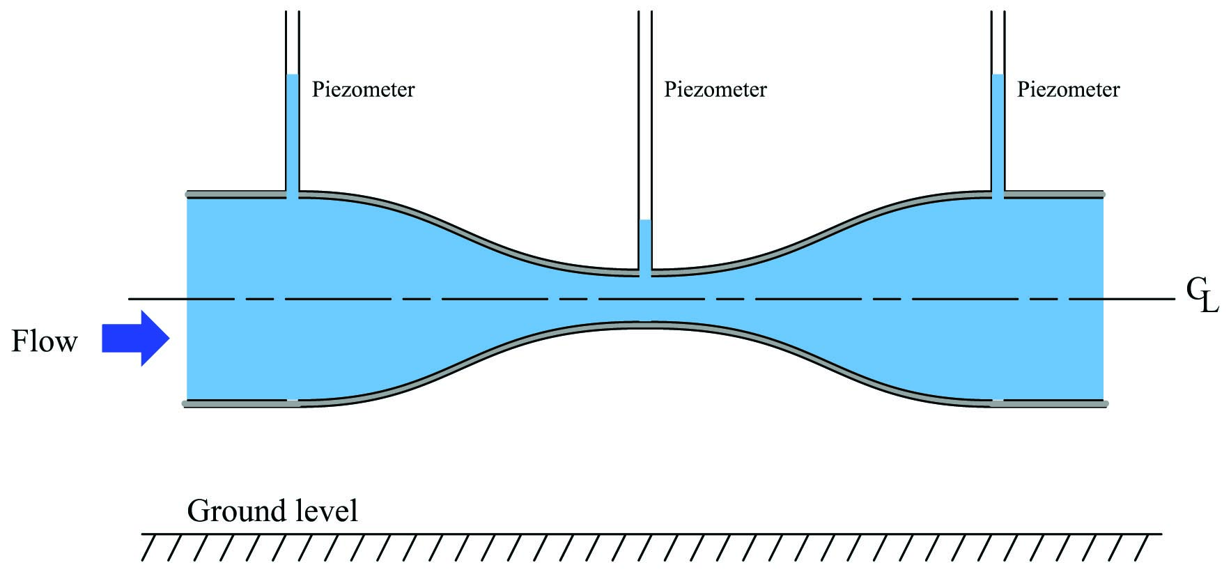

If we install vertical sight-tubes called piezometers along a horizontal venturi tube, the differences in pressure will be shown by the heights of liquid columns within the tubes. Here, we assume an ideal (inviscid) liquid with no permanent pressure loss:
The height of liquid in each piezometer tube represents the amount of potential energy in the fluid at that point along the venturi tube.
[Piezometer]
We may gain more insight into the nature of energy in this moving fluid stream if we add three more piezometers, each one equipped with its own Pitot tube facing upstream to “catch” the velocity of the fluid. Rather than represent potential energy by liquid height as the straight-tube piezometers do, the Pitot tube piezometers represent the total energy (potential plus kinetic) of the fluid. As such, the liquid heights in these new piezometers are all equal to each other, showing that total energy is indeed conserved at every point in the system:
\[z + {v^2 \over {2 g}} + {P \over \gamma} = \hbox{(constant)}\]
Here, each of the “heads” represented in Bernoulli’s equation are shown in relation to the different piezometer heights. The difference in liquid column height between each Pitot tube piezometer (potential + kinetic energy) and its corresponding straight-tube piezometer (potential energy alone) reflects the amount of kinetic energy possessed by the fluid stream at that point in the venturi tube.
In a real venturi tube, there is some energy permanently lost in the moving fluid due to friction. Consequently the piezometer measurements in a real venturi tube would look something like this:
The “energy line” is seen to slope downhill from inlet to outlet on the venturi tube, showing a degradation in total energy content from beginning to end.
