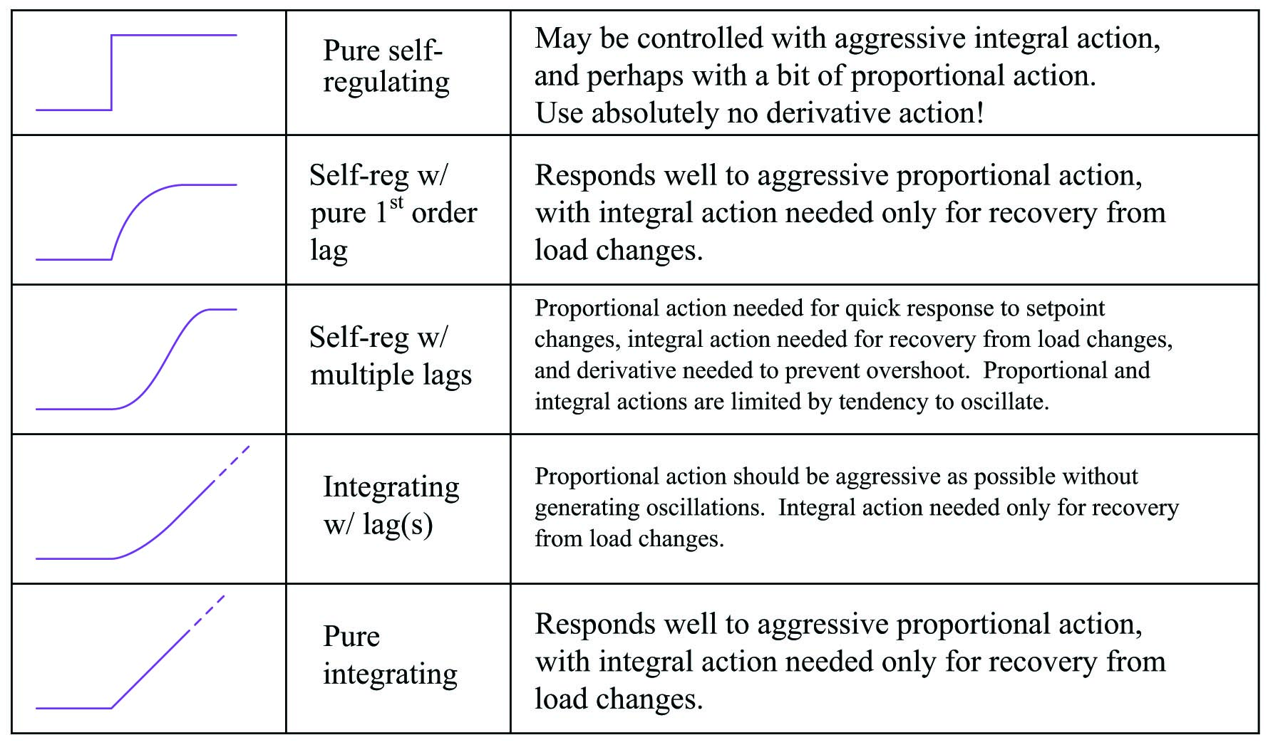

Tuning recommendations based on process dynamics
Knowing which control actions to focus on first is a matter of characterizing the process (identifying whether it is self-regulating, integrating, runaway, noisy, has lag or dead time, or any combination of these traits based on an open-loop response test984) and then selecting the best actions to fit those characteristics. The following table shows some general recommendations for fitting PID tuning to different process characteristics
[tuning_recommendations]
General rules:
  • Use no derivative action if the process signal is “noisy”
  • Use proportional action sparingly if the process signal is “noisy”
  • The slower the time lag(s), the less integral action to use (a good approximation is to set the integration time \(\tau_i\) equal to the measured lag time of the process)
  • The higher-order the time lag(s), the less proportional action (gain) to use
  • Self-regulating processes need integral action
  • Integrating processes need proportional action
  • Dead time requires a reduction of all PID constants below what would normally work
Once you have determined the basic character of the process, and understand from that characterization what the needs of the process will be regarding P, I, and/or D control actions, you may “experiment” with different tuning values of P, I, and D until you find a combination yielding robust control.

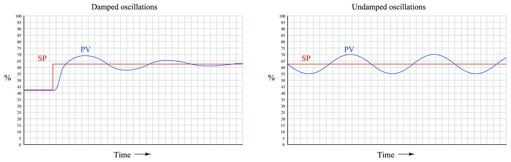

When performing heuristic tuning of a PID controller, it is important to be able to identify a condition where one or more of the “actions” (P, I, or D) is configured too aggressively for the process. The characteristic indication of over-tuning is the presence of sinusoidal oscillations. At best, this means damped oscillations following a sudden setpoint or load change. At worst, this means oscillations that never decay:
At this point, the question is: which action of the controller is causing this oscillation? We know all three actions (P, I, and D) are fully capable of causing process oscillation if set too aggressive, so in the lack of clarifying information it could be any of them (or some combination!).

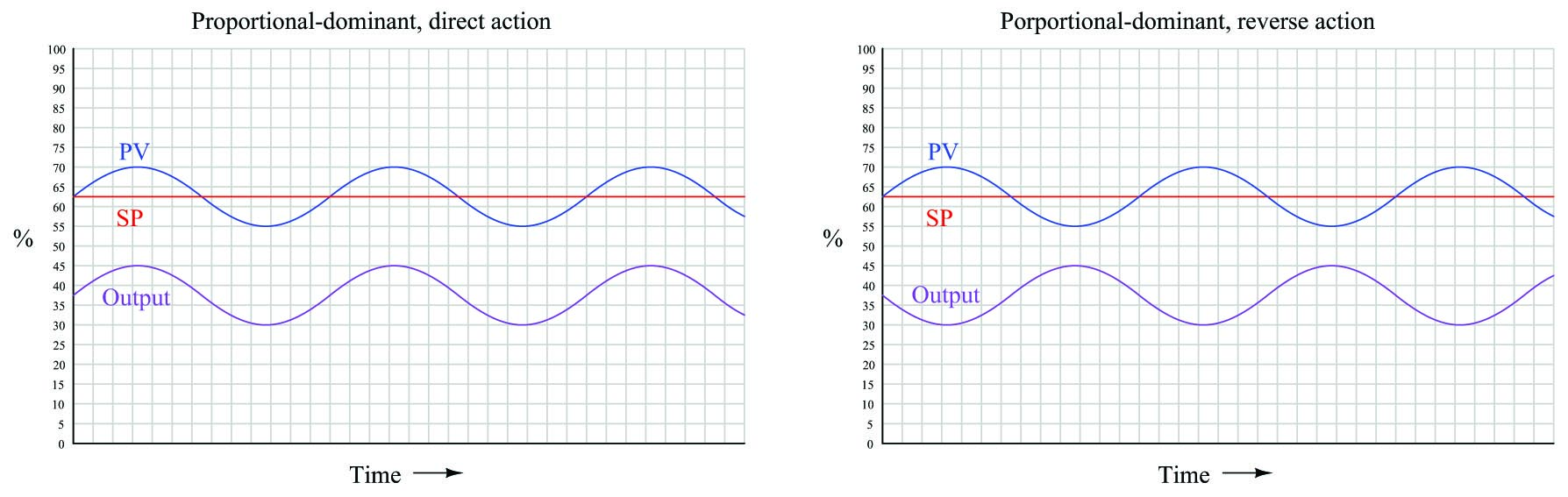

For example, the following trend graphs show the PV and output signals for a loop controller with proportional-dominant response. Both direct- and reverse-acting versions are shown:
Since we know proportional action is immediate, there should be no phase shift985 between the PV and output waveforms. This makes sense from a mathematical perspective: if we substitute a sine function for the error variable in a proportional-only controller equation, we see that different gain values (\(K_p\)) simply result in an output signal of the same phase, just amplified or attenuated:
\[m = K_p e + b\]
\[m = K_p (\sin t) + b\]
If ever you see a process oscillating like this (sinusoidal waveforms, with the PV and output signals in-phase), you know that the controller’s response to the process is dominated by proportional action, and that the gain needs to be reduced (i.e. increase proportional band) to achieve stability.

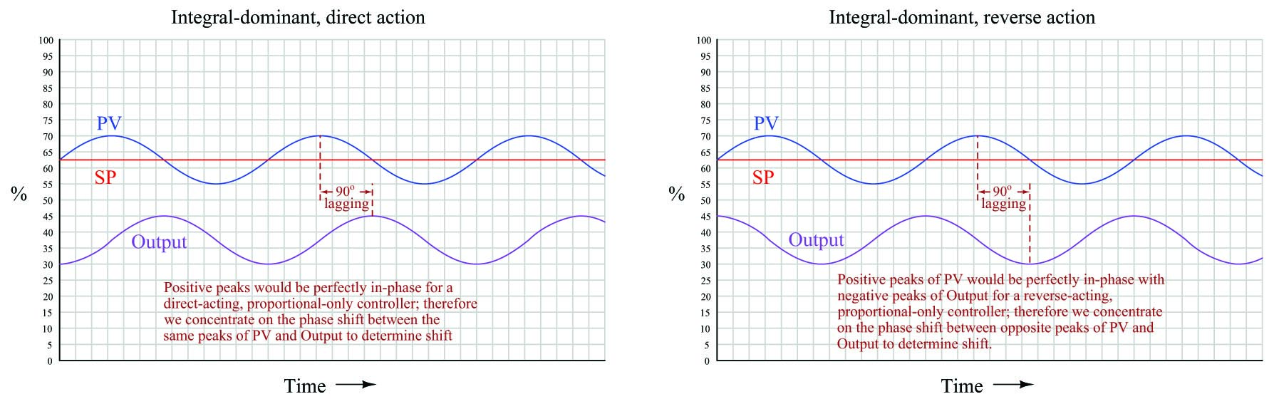

Integral and derivative actions, however, introduce phase shift between the PV waveform and the output waveform. The direction of phase shift will reveal which time-based action (either I or D) dominates the controller’s response and is therefore most likely the cause of oscillation.
For example, the following trend graph shows the PV and output signals for a loop controller with integral-dominant response. Both direct- and reverse-acting versions are shown:
Here, the output waveform is phase-shifted 90\(^{o}\) behind (lagging) the PV waveform compared to what it would be by proportional action alone. This \(-90^{o}\) phase shift is most difficult to see for reverse-acting controllers, since the natural 180\(^{o}\) phase shift caused by reverse action makes the additional \(-90^{o}\) shift look like a \(+90^{o}\) shift (i.e. a \(-270^{o}\) shift). One method I use for discerning the direction of phase shift for reverse acting controllers is to imagine what the output waveform would look like for a proportional-only controller, and compare to that. Another method is to perform a “thought experiment” looking at the PV waveform, noting the velocity of the controller’s output at points of maximum error (when integral action would be expected to move the output signal fastest). In the previous example of an integral-dominant reverse-acting controller, we see that the output signal is indeed descending at its most rapid pace when the PV is highest above setpoint (greatest positive error), which is exactly what we would expect reverse-acting integration to do.
Mathematically, this makes sense as well. Integration of a sine function results in a negative cosine waveform:
\[-\cos t = \int \sin t \> dt\]
Another way of stating this is to say integration always adds a \(-90^{o}\) phase shift:
\[\sin (t - 90^{o}) = \int \sin t \> dt\]

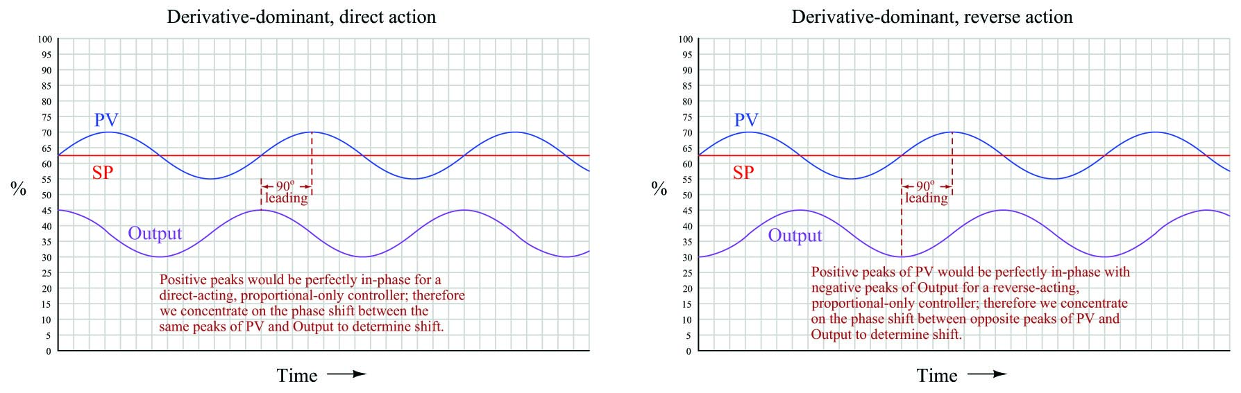

If derivative action is set too aggressive for the needs of the process, the resulting output waveform will be phase-shifted \(+90^{o}\) from that of a purely proportional response:
Once again, the direction of phase shift is easiest to discern in the direct-acting case, since we expect the PV and output sine waves to be perfectly in-phase for proportional-dominant response. A \(+90^{o}\) phase shift is very clear to see in the direct-acting example because the peaks of the output waveform clearly precede the corresponding peaks of the PV waveform. The reverse-acting control example is more difficult due to the added 180\(^{o}\) of phase shift intrinsic to reverse action.
The derivative of a sine function is always a cosine function (or alternatively stated, a sine function with a \(+90^{o}\) phase shift):
\[\cos t = {d \over dt} \sin t\]
\[\sin (t + 90^{o}) = {d \over dt} \sin t\]

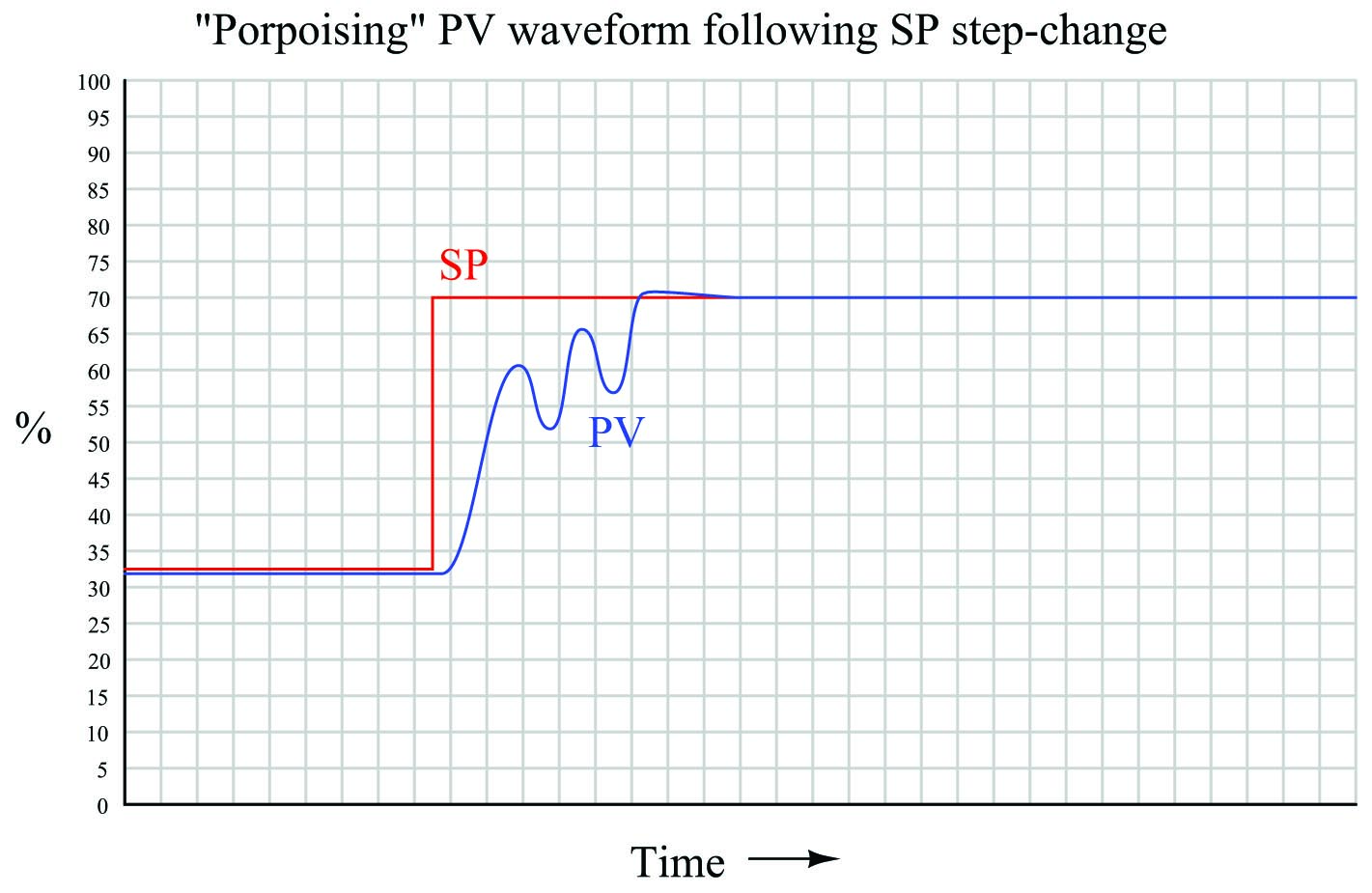

An interesting case of over-tuning is when the process variable “porpoises986” on its way to setpoint following a step-change in setpoint. The following trend shows such a response:
[porpoising]
“Porpoising” is universally poor behavior for a loop, because it combines the negative consequences of over-tuning (instability and excessive valve travel) with the negative consequence of under-tuning (delay achieving setpoint). There is no practical purpose served by a loop “porpoising,” and so this behavior should be avoided if at all possible.
Thankfully, identifying the cause of “porpoising” is rather easy to do. Only two control actions are capable of causing this response: proportional and derivative. Integral action simply cannot cause porpoising. In order for the process variable to “porpoise,” the controller’s output signal must reverse direction before the process variable ever reaches setpoint. Integral action, however, will always drive the output in a consistent direction when the process variable is on one side of setpoint. Only proportional and derivative actions are capable of producing a directional change in the output signal prior to reaching setpoint.
Solely examining the process variable waveform will not reveal whether it is proportional action, derivative action, or both responsible for the “porpoising” behavior. A trial reduction in the derivative987 tuning parameter is one way to identify the culprit, as is phase-shift analysis between the PV and output waveforms during the “porpoising” period.
