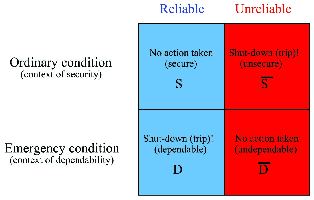

For the sake of clarity I will use these same terms when discussing the reliability of any instrument or control systems. “Dependability” is how reliably a device or system will take appropriate action when it is actively called to do so – in other words, the degree to which we may depend on this device or system to do its job when activated. “Security” is how reliably a device or system refrains from taking action when no action should be taken – in other words, the degree to which we may feel secure it won’t needlessly trigger a system shutdown or generate a false alarm. If there is no need to differentiate, the term “reliability” will be used as a general description of how probable a device or system will do what it was designed to do.
The following matrix should help clarify the meanings of these three terms, defined in terms of what the protective component or system does under various conditions:
In summary: a protective function that does not trip when it doesn’t need to is secure; a protective function that trips when it needs to is dependable; a protective system that does both is reliable.
The Boolean variables used to symbolize dependability (\(D\)), security (\(S\)), undependability (\(\overline{D}\)), and unsecurity (\(\overline{S}\)) tell us something about the relationships between those four quantities. A bar appearing over a Boolean variable represents the complement of that variable. For example, security (\(S\)) and unsecurity (\(\overline{S}\)) are complementary to each other: if we happen to know the probability that a device or system will be secure, then we may calculate with assurance the probability that it is unsecure. A fire alarm system that is 99.3% secure (i.e. 99.3% of the time it generates no false alarms) must generate false alarms the other 0.7% of the time in order to account for all possible system responses 100% of the time no fires occur. If that same fire alarm system is 99.8% dependable (i.e. it alerts people to the presence of a real fire 99.8% of the time), then we may conclude it will fail to report 0.02% of real fire incidents in order to account for all possible responses during 100% of fire incidents.
However, it should be clearly understood that there is no such simple relationship between security (\(S\)) and dependability (\(D\)) because these two measures refer to completely different conditions and (potentially) different modes of failure. The specific faults causing a fire alarm system to generate a false alarm (an example of an unsecure outcome, \(\overline{S}\)) are quite different from the faults disabling that same fire alarm system in the event of a real fire (an example of an undependable outcome, \(\overline{D}\)). Through the application of redundant components and clever system design we may augment dependability and/or security (sometimes improving one at the expense of the other), but it should be understood that these are really two fundamentally different probability measures and as such are not necessarily related.

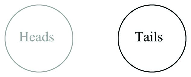

Probability may be defined as a ratio of specific outcomes to total (possible) outcomes. If you were to flip a coin, there are really only two possibilities for how that coin may land: face-up (“heads”) or face-down (“tails”). The probability of a coin falling “tails” is thus one-half (\(1 \over 2\)), since “tails” is one specific outcome out of two total possibilities. Calculating the probability (\(P\)) is a matter of setting up a ratio of outcomes:
\[P(\hbox{``tails''}) = {\hbox{``tails''} \over \hbox{``heads'' + ``tails''}} = {1 \over 2} = 0.5\]
This may be shown graphically by displaying all possible outcomes for the coin’s landing (“heads” or “tails”), with the one specific outcome we’re interested in (“tails”) highlighted for emphasis:
The probability of the coin landing “heads” is of course exactly the same, because “heads” is also one specific outcome out of two total possibilities.

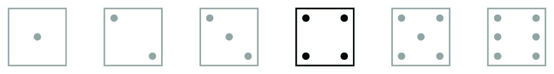

If we were to roll a six-sided die, the probability of that die landing on any particular side (let’s arbitrarily choose the “four” side) is one out of six, because we’re looking at one specific outcome out of six total possibilities:
\[P(\hbox{``four''}) = {\hbox{``four''} \over \hbox{``one'' + ``two'' + ``three'' + ``four'' + ``five'' + ``six''}} = {1 \over 6} = 0.1\overline{66}\]

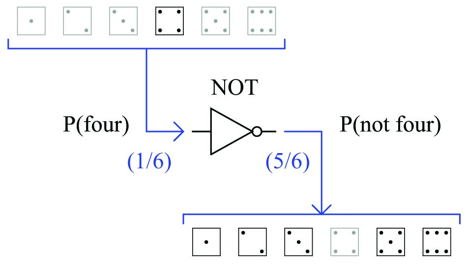

The logical “NOT” function
For instance, if we know the probability of rolling a “four” on a six-sided die is \({1 \over 6}\), then we may safely say the probability of not rolling a “four” is \(5 \over 6\), the complement of \({1 \over 6}\). The common “inverter” logic symbol is shown here representing the complementation function, turning a probability of rolling a “four” into the probability of not rolling a “four”:
Symbolically, we may express this as a sum of probabilities equal to one:
\[P(\hbox{total}) = P(\hbox{``one''}) + P(\hbox{``two''}) + P(\hbox{``three''}) + P(\hbox{``four''}) + P(\hbox{``five''}) + P(\hbox{``six''}) = 1\]
\[P(\hbox{total}) = {1 \over 6} + {1 \over 6} + {1 \over 6} + {1 \over 6} + {1 \over 6} + {1 \over 6} = 1\]
\[P(\hbox{total}) = P(\hbox{``four''}) + P(\hbox{not ``four''}) = {1 \over 6} + {5 \over 6} = 1\]
\[P(\hbox{``four''}) = 1 - P(\hbox{not ``four''}) = 1 - {5 \over 6} = {1 \over 6}\]
We may state this as a general “law” of complementation for any event (\(A\)):
\[P(A) = 1 - \overline{P}(A)\]
Complements of probability values find frequent use in reliability engineering. If we know the probability value for the failure of a component (i.e. how likely it is to fail when called upon to function – termed the Probability of Failure on Demand, or PFD – which is a measure of that component’s undependability), then we know the dependability value (i.e. how likely it is to function on demand) will be the mathematical complement. To illustrate, consider a device with a PFD value of \(1 \over 100000\). Such a device could be said to have a dependability value of \(99999 \over 100000\), or 99.999%, since \(1 - {1 \over 100000} = {99999 \over 100000}\).

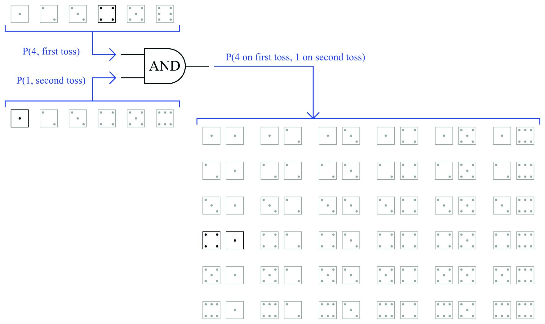

The AND function regards probabilities of two or more coincidental events (i.e. where the outcome of interest only happens if two or more events happen together, or in a specific sequence). Another example using a die is the probability of rolling a “four” on the first toss, then rolling a “one” on the second toss. It should be intuitively obvious that the probability of rolling this specific combination of values will be less (i.e. less likely) than rolling either of those values in a single toss. The shaded field of possibilities (36 in all) demonstrate the unlikelihood of this sequential combination of values compared to the unlikelihood of either value on either toss:
As you can see, there is only one outcome matching the specific criteria out of 36 total possible outcomes. This yields a probability value of one-in-thirty six (\(1 \over 36\)) for the specified combination, which is the product of the individual probabilities. This, then, is our second law of probability:
\[P(\hbox{A \textit{and} B}) = P(\hbox{A}) \times P(\hbox{B})\]

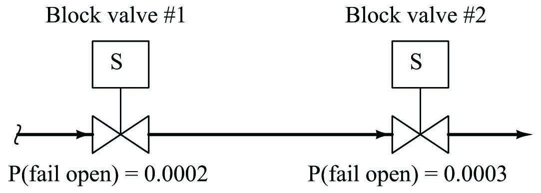

A practical application of this would be the calculation of failure probability for a double-block valve assembly, designed to positively stop the flow of a dangerous process fluid. Double-block valves are used to provide increased assurance of shut-off, since the shutting of either block valve is sufficient in itself to stop fluid flow. The probability of failure for a double-block valve assembly – “failure” defined as not being able to stop fluid flow when needed – is the product of each valve’s un-dependability (i.e. probability of failing in the open position when commanded to shut off):
With these two valves in service, the probability of neither valve successfully shutting off flow (i.e. both valve 1 and valve 2 failing on demand; remaining open when they should shut) is the product of their individual failure probabilities.
\[P(\hbox{assembly fail}) = P(\hbox{valve 1 fail open}) \times P(\hbox{valve 2 fail open})\]
\[P(\hbox{assembly fail}) = 0.0002 \times 0.0003\]
\[P(\hbox{assembly fail}) = 0.00000006 = 6 \times 10^{-8}\]
An extremely important assumption in performing such an AND calculation is that the probabilities of failure for each valve are completely unrelated. For instance, if the failure probabilities of both valve 1 and valve 2 were largely based on the possibility of a certain residue accumulating inside the valve mechanism (causing the mechanism to freeze in the open position), and both valves were equally susceptible to this residue accumulation, there would be virtually no advantage to having double block valves. If said residue were to accumulate in the piping, it would affect both valves practically the same. Thus, the failure of one valve due to this effect would virtually ensure the failure of the other valve as well. The probability of simultaneous or sequential events being the product of the individual events’ probabilities is true if and only if the events in question are completely independent.

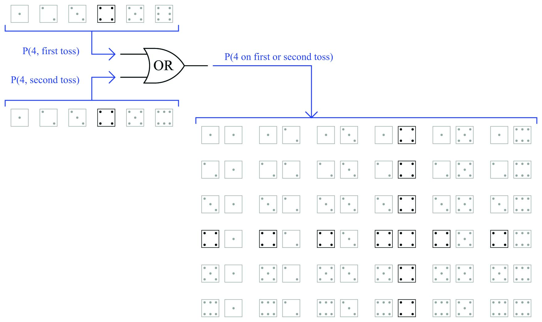

The OR function regards probabilities of two or more redundant events (i.e. where the outcome of interest happens if any one of the events happen). Another example using a die is the probability of rolling a “four” on the first toss or on the second toss. It should be intuitively obvious that the probability of rolling a “four” on either toss will be more probable (i.e. more likely) than rolling a “four” on a single toss. The shaded field of possibilities (36 in all) demonstrate the likelihood of this either/or result compared to the likelihood of either value on either toss:
As you can see, there are eleven outcomes matching the specific criteria out of 36 total possible outcomes (the outcome with two “four” rolls counts as a single trial matching the stated criteria, just as all the other trials containing only one “four” roll count as single trials). This yields a probability value of eleven-in-thirty six (\(11 \over 36\)) for the specified combination. This result may defy your intuition, if you assumed the OR function would be the simple sum of individual probabilities (\({1 \over 6} + {1 \over 6} = {2 \over 6}\) or \(1 \over 3\)), as opposed to the AND function’s product of probabilities (\({1 \over 6} \times {1 \over 6} = {1 \over 36}\)). In truth, there is an application of the OR function where the probability is the simple sum, but that will come later in this presentation.
As with the logical “AND” function, the logical “OR” function assumes the events in question are independent from each other. That is to say, the events lack a common cause, and are not contingent upon one another in any way.

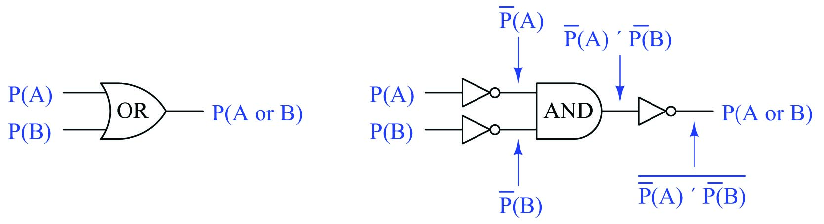

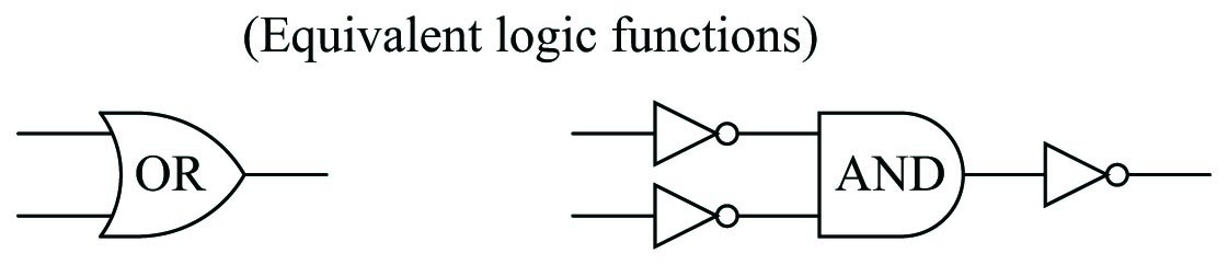

For now, a way to understand why we get a probability value of \(11 \over 36\) for our OR function with two \(1 \over 6\) input probabilities is to derive the OR function from other functions whose probability laws we already know with certainty. From Boolean algebra, DeMorgan’s Theorem tells us an OR function is equivalent to an AND function with all inputs and outputs inverted (\(A + B = \overline{\overline{A} \> \overline{B}}\)):
We already know the complement (inversion) of a probability is the value of that probability subtracted from one (\(\overline{P} = 1 - P\)). This gives us a way to symbolically express the DeMorgan’s Theorem definition of an OR function in terms of an AND function with three inversions:
Knowing that \(\overline{P}(A) = 1 - P(A)\) and \(\overline{P}(B) = 1 - P(B)\), we may substitute these inversions into the triple-inverted AND function to arrive at an expression for the OR function in simple terms of \(P(A)\) and \(P(B)\):
\[P(A \hbox{ or } B) = \overline{\overline{P}(A) \times \overline{P}(B)}\]
\[P(A \hbox{ or } B) = \overline{(1 - {P}(A)) (1 - {P}(B))}\]
\[P(A \hbox{ or } B) = 1 - \left[(1 - {P}(A)) (1 - {P}(B))\right]\]
Distributing terms on the right side of the equation:
\[P(A \hbox{ or } B) = 1 - \left[1 - P(B) - P(A) + P(A)P(B)\right]\]
\[P(A \hbox{ or } B) = P(B) + P(A) - P(A)P(B)\]
This, then, is our third law of probability:
\[P(\hbox{A \textit{or} B}) = P(B) + P(A) - P(A) \times P(B)\]
Inserting our example probabilities of \(1 \over 6\) for both \(P(A)\) and \(P(B)\), we obtain the following probability for the OR function:
\[P(A \hbox{ or } B) = {1 \over 6} + {1 \over 6} - \left(1 \over 6 \right) \left( 1 \over 6 \right)\]
\[P(A \hbox{ or } B) = {2 \over 6} - \left(1 \over 36 \right)\]
\[P(A \hbox{ or } B) = {12 \over 36} - {1 \over 36}\]
\[P(A \hbox{ or } B) = {11 \over 36}\]
This confirms our previous conclusion of there being an \(11 \over 36\) probability of rolling a “four” on the first or second rolls of a die.

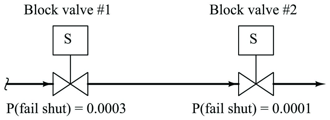

We may return to our example of a double-block valve assembly for a practical application of OR probability. When illustrating the AND probability function, we focused on the probability of both block valves failing to shut off when needed, since both valve 1 and valve 2 would have to fail open in order for the double-block assembly to fail in shutting off flow. Now, we will focus on the probability of either block valve failing to open when needed. While the AND scenario was an exploration of the system’s un-dependability (i.e. the probability it might fail to stop a dangerous condition), this scenario is an exploration of the system’s un-security (i.e. the probability it might fail to resume normal operation).
Each block valve is designed to be able to shut off flow independently, so that the flow of (potentially) dangerous process fluid will be halted if either or both valves shut off. The probability that process fluid flow may be impeded by the failure of either valve to open is thus a simple (non-exclusive) OR function:
\[P(\hbox{assembly fail}) = P(\hbox{valve 1 fail shut}) + P(\hbox{valve 2 fail shut}) - P(\hbox{valve 1 fail shut}) \times P(\hbox{valve 2 fail shut})\]
\[P(\hbox{assembly fail}) = 0.0003 + 0.0001 - (0.0003 \times 0.0001)\]
\[P(\hbox{assembly fail}) = 0.0003997 = 3.9997 \times 10^{-4}\]

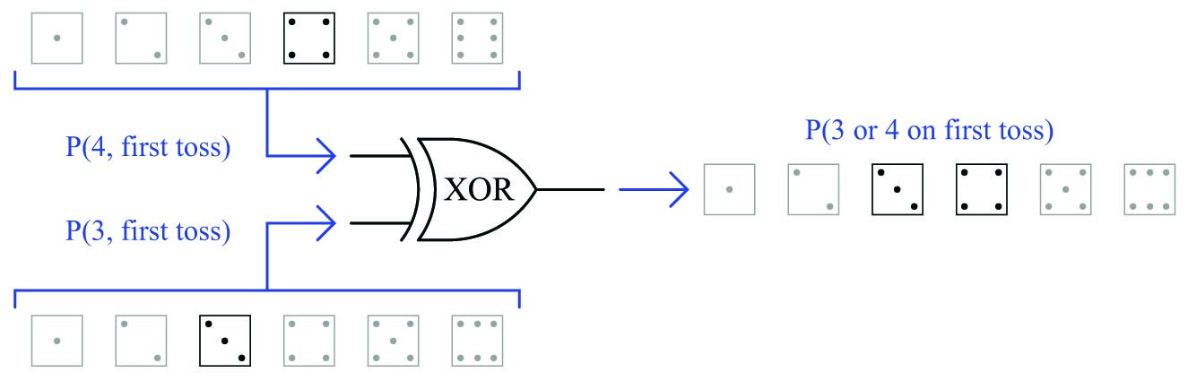

A similar application of the OR function is seen when we are dealing with exclusive events. For instance, we could calculate the probability of rolling either a “three” or a “four” in a single toss of a die. Unlike the previous example where we had two opportunities to roll a “four,” and two sequential rolls of “four” counted as a single successful trial, here we know with certainty that the die cannot land on “three” and “four” in the same roll. Therefore, the exclusive OR probability (XOR) is much simpler to determine than a regular OR function:
This is the only type of scenario where the function probability is the simple sum of the input probabilities. In cases where the input probabilities are mutually exclusive (i.e. they cannot occur simultaneously or in a specific sequence), the probability of one or the other happening is the sum of the individual probabilities. This leads us to our fourth probability law:
\[P(\hbox{A \textit{exclusively or} B}) = P(A) + P(B)\]

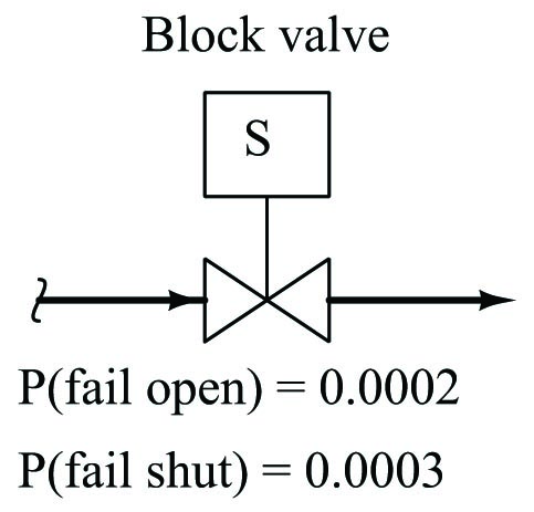

A practical example of the exclusive-or (XOR) probability function may be found in the failure analysis of a single block valve. If we consider the probability this valve may fail in either condition (stuck open or stuck shut), and we have data on the probabilities of the valve failing open and failing shut, we may use the XOR function to model the system’s general unreliability. We know that the exclusive-or function is the appropriate one to use here because the two “input” scenarios (failing open versus failing shut) absolutely cannot occur at the same time:
\[P(\hbox{valve fail}) = P(\hbox{valve fail open}) + P(\hbox{valve fail shut})\]
\[P(\hbox{valve fail}) = 0.0002 + 0.0003\]
\[P(\hbox{valve fail}) = 0.0005 = 5 \times 10^{-4}\]
If the intended safety function of this block valve is to shut off the flow of fluid if a dangerous condition is detected, then the probability of this valve’s failure to shut when needed is a measure of its undependability. Conversely, the probability of this valve’s failure to open under normal (safe) operating conditions is a measure of its unsecurity. The XOR of the valve’s undependability and its unsecurity therefore represents its unreliability. The complement of this value will be the valve’s reliability: \(1 - 0.0005 = 0.9995\). This reliability value tells us we can expect the valve to operate as it’s called to 99.95% of the time, and we should expect 5 failures out of every 10,000 calls for action.

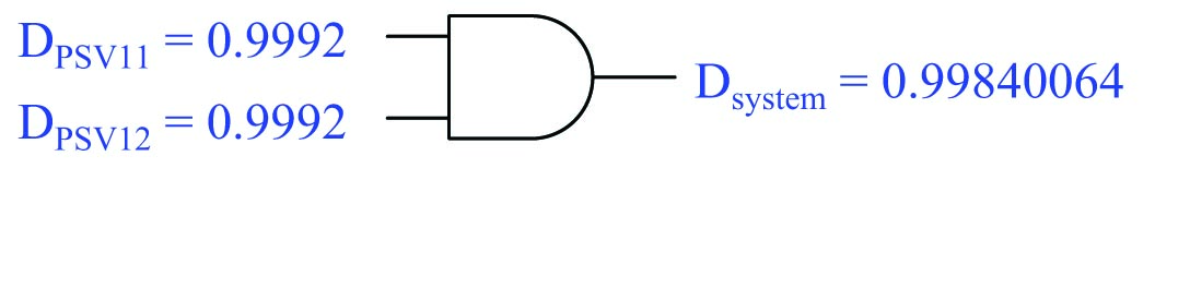

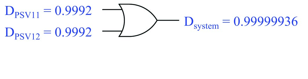

Suppose each of these pressure safety valves has a dependability (\(D\)) rating of 0.9992, which means each one has a 99.92% chance of opening up to relieve excess pressure when a high-pressure condition exists. Let us also suppose each of these PSVs has a security (\(S\)) rating of 0.995, which means each one has a 99.5% chance of remaining in the shut condition when no overpressure condition exists. Furthermore, assume each of the two pressure safety valves individually has a high enough flow capacity to adequately vent the vessel during an overpressure condition.
How might we calculate the overall dependability and security ratings of this dual-PSV overpressure protection system? Clearly, we must use Boolean functions to combine the two valves’ \(D\) ratings into a \(D_{system}\) rating, and likewise with the two valves’ \(S\) ratings, but which logical function should we use to calculate each measure of reliability? The choice between AND and OR functions may not be obvious at first inspection.
One way to analyze logical functions is in terms of what state (0 or 1) at any input will guarantee a certain output state. For an AND function, any 0 state in guarantees a 0 state out. For an OR function, any 1 state in guarantees a 1 state out. These facts are useful when selecting logical functions for a variety of purposes, and they will serve us well in this application of probability values too.
A useful problem-solving technique for this application is called limiting cases, where we take some quantity to its extreme limits in an effort to simply the problem at hand. To begin, we will assume that one of the two pressure safety valves in this system has a \(D\) rating of 1, which means it is perfectly reliable when called to open by a high-pressure condition. A \(D\) rating of 1 is a “limiting case” of the pressure safety valve’s dependability: a perfectly dependable PSV. If this were true, would it guarantee the whole overpressure protection system is dependable, or not? Since we know each valve is sized large enough to protect the vessel on its own (without need of the second PSV opening), then the answer to this question is “yes”: a single PSV with a \(D\) rating of 1 guarantees a \(D_{system}\) rating of 1. All we need is for one of these PSVs to vent when it senses a high-pressure condition to protect the vessel from overpressure damage. Therefore, the proper Boolean function to calculate \(D_{system}\) from the valves’ individual \(D\) ratings is the OR function, because given the choices of AND and OR only the OR function guarantees a certain output state with any “1” input. Calculating system dependability using both valves’ \(D\) ratings:
The numerical results shown here should make sense: in an overpressure protection system where we only need one of the two valves to vent gas during an overpressure condition, having two valves increases the probability that the vessel will be adequately protected.

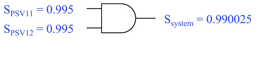

Now we will apply this same problem-solving strategy to the system’s security (\(S\)). Taking the high limiting-case value of either PSV’s \(S\) rating, we ask ourselves the question “Does any one perfectly secure PSV (\(S = 1\)) make the system secure?” In other words, if one of these valves was guaranteed not to vent when no overpressure condition exists, would that mean the entire system was guaranteed not to vent when it didn’t need to? The answer here is “no”, since the presence of two pressure safety valves increases the chance of unnecessary leakage. This tells us we cannot use the OR function for security, because a perfectly secure PSV (\(S = 1\)) does not guarantee a perfectly secure system.
At this point we may conclude that the proper Boolean function for system security in this application is the AND, by process of elimination. However, we may also consider a different limiting-case scenario to verify this conclusion. Let us suppose one of the pressure safety valves failed in such a way that it had zero security, meaning there was no chance at all it would remain shut when no overpressure condition existed (i.e. a security rating of \(S = 0\) means it is guaranteed to vent when it shouldn’t). Would one PSV in this state guarantee a certain system security state? We see here that this is true: any one PSV with an \(S\) rating of zero means the system as a whole has a zero \(S\) rating as well, because all it takes is one PSV to unnecessarily vent to make the system as a whole unnecessarily vent. Since we know the Boolean AND function guarantees a zero output for any zero input, this is the function we should use when calculating system security. Calculating system security using both valves’ \(S\) ratings::
These numerical results should make sense as well: in an overpressure protection system where a leak in one valve is enough to constitute a problem, the presence of multiple valves is a liability and therefore reduces the over-all security.
It is worth noting that a simple change in parameters may strongly impact our reliability calculations. In this scenario we were told each pressure safety valve was sized large enough to adequately vent the vessel on its own, without the help of the other PSV, in the event of an overpressure condition. What if the PSVs were undersized, and both of them would be required to vent in order to protect the vessel from overpressure damage? How would this alteration impact our reliability calculations?
