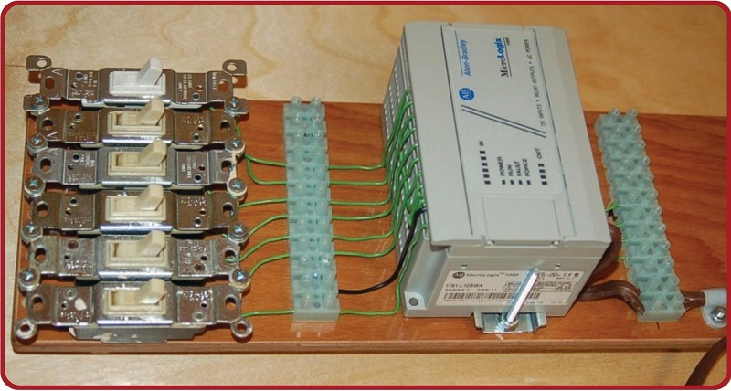

In order to work with your PLC, you will need a convenient way to simulate different input conditions coming from discrete (switch) devices. Any set of hand-operated switches will do, my recommendation being household light switches (very inexpensive and rugged). Attaching an array of these switches to a wooden board along with the PLC and interconnecting terminal blocks forms what is often called a PLC trainer. The following photograph shows one such trainer, using an Allen-Bradley MicroLogix 1000 PLC:
Input devices are simple to obtain because they can be any simple switch or metal contact from the 24 volt supply to the input terminal. The light switches in the previous diagrams are great examples, but a quick search of any electronics aisle at a thrift store will yield an amazing variety of power tools and broken appliances. Every one of them contains switches which can be repurposed with a little elbow grease. In a pinch, I’ve simply taped paper clips to the table, bent the ends slightly, and relied on the spring constant of the metal to fashion my own switches.
Outputs are simpler. PLCs contain built-in LEDs for all input and output terminals. Although you must install an input device to provide inputs, you don’t even need an output at all. It can be more exciting and real-world to install an output relay, or perhaps an indicator light, but it is sufficient to simply monitor the LEDs on the PLC to identify whether your logic is functional or not.
The educational value of building your own PLC trainer is difficult to overstate when learning about PLCs. Learning how to build properly-functioning I/O circuits is every bit as important to a working technician as learning how to develop PLC programs. Additionally, the experience gained in general wiring layout and fabrication are valuable skills for any instrumentation practitioner.

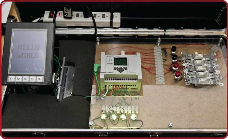

Another example of a PLC trainer with a bit more elegance is the following unit, housed inside of an attaché case. Not only does this trainer contain an Allen-Bradley MicroLogix 1100 PLC along with input switches and output indicator lights, but it also includes an HMI touch-screen panel on a fold-down bracket:

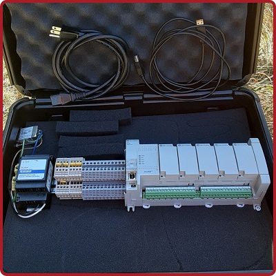

The following image shows a trainer built into a small plastic case using a Rockwell Micro830 PLC, along with a simple DC power supply and terminal block distribution strip. The simplicity of this learning design allows you to learn even the most advanced programming functions without spending unnecessary time in the wiring and construction phases. A common mistake is assuming that a trainer must be complex enough to replicate any facility experience in order to learn, and this example proves this is simply not the case.
