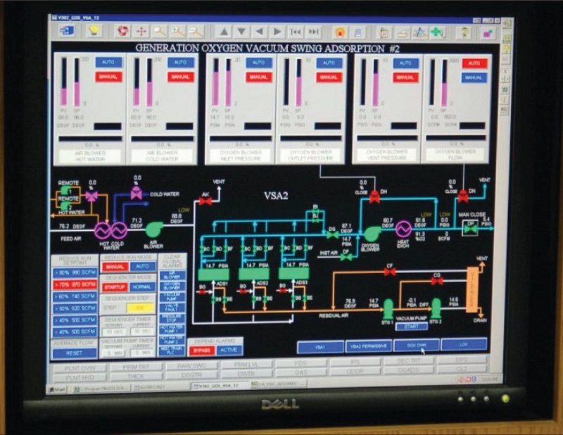

HMIs may take the form of general-purpose (“personal”) computers running special graphic software to interface with a PLC, or they can be special-purpose computer modules designed to be mounted through the front of sheet metal panels and cabinets to perform the sole task of operator <-> PLC interface. This first photograph shows an example of an ordinary personal computer (PC) with HMI software running on it:
The display shown here is a system which monitors a vacuum swing adsorption (VSA) process for purifying oxygen extracted from ambient air.
Somewhere, a PLC (or collection of PLCs) is monitoring and controlling this VSA process, with the HMI software acting as a “window” into the PLC memory to display pertinent variables in an easy-to-interpret form for operations personnel. The personal computer running this HMI software connects to the PLC(s) via an Ethernet digital network cable.

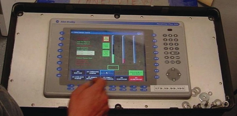

This next photograph shows an example of a special-purpose HMI panel designed and built expressly to be used in industrial operating environments:
These special HMI panels are really nothing more than “hardened” personal computers built ruggedly and in a compact format to facilitate their use in industrial environments. Most industrial HMI panels come equipped with touch-sensitive screens, allowing operators to press their fingertips on displayed objects to change screens, view details on portions of the process, etc.

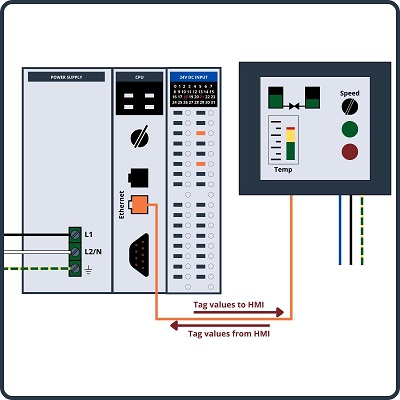

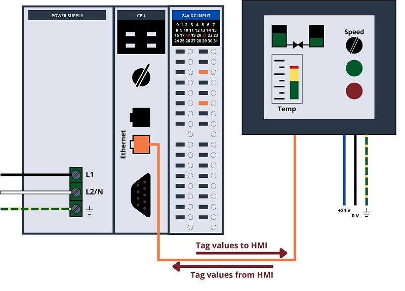

Technicians and/or engineers program HMI displays to read and write data via a digital network to one or more PLCs. Graphical objects arrayed on the display screen of an HMI often mimic real-world indicators and switches, in order to provide a familiar interface for operations personnel. A “pushbutton” object on the face of an HMI panel, for example, would be configured to write one bit of data to the PLC, in a manner similar to a real-world switch writing one bit of data to the PLC’s input register.
Modern HMI panels and software are almost exclusively tag-based, with each graphic object on the screen associated with at least one data tag name, which in turn is associated to data points (bits, or words) in the PLC by way of a tag name database file resident in the HMI. Graphic objects on the HMI screen either accept (read) data from the PLC to present useful information to the operator, send (write) data to the PLC from operator input, or both. The task of programming an HMI unit consists of building a tag name database and then drawing screens to illustrate the process to as good a level of detail as operators will need to run it.

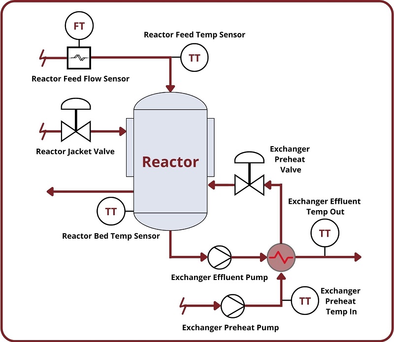

Another way to leverage the alphabetical listing of tag names to your advantage is to begin each tag name with a word describing its association to a major piece of equipment. Take for instance this example of a process with several data points defined in a PLC control system and displayed in an HMI:
If we list all these tags in alphabetical order, the association is immediately obvious:
  • Exchanger_effluent_pump
  • Exchanger_effluent_temp_out
  • Exchanger_preheat_pump
  • Exchanger_preheat_temp_in
  • Exchanger_preheat_valve
  • Reactor_bed_temp
  • Reactor_feed_flow
  • Reactor_feed_temp
  • Reactor_jacket_valve
As you can see from this tag name list, all the tags directly associated with the heat exchanger are located in one contiguous group, and all the tags directly associated with the reactor are located in the next contiguous group. In this way, judicious naming of tags serves to group them in hierarchical fashion, making them easy for the programmer to locate at any future time in the tag name database.
A further breakdown of this same list may provide better troubleshooting diagnostic information by integrating the input or output functionality into the tag name. This is weighed against the risk of lengthening the tag name until it becomes difficult to read, but nearly all tag table columns can be widened, and the text size in the ladder editor can be decreased.
  • Exchanger_input_effluent_temp_out
  • Exchanger_input_preheat_temp_in
  • Exchanger_output_effluent_pump
  • Exchanger_output_preheat_pump
  • Exchanger_output_preheat_valve
  • Reactor_input_bed_temp
  • Reactor_input_feed_flow
  • Reactor_input_feed_temp
  • Reactor_output_jacket_valve
In this alphabetized system, it becomes immediately clear whether the indicated function should be traced to a physical input or an output module terminal. For novice technicians still becoming familiar with the technical definitions of a particular system, this clarification can help accelerate the learning process. As an example in this system, ‘flow’ may refer to a flowrate transducer or a flow control valve. Labeling it as an input versus an output can clear this confusion.
You will note that all the tag names shown here lack space characters between words (e.g. instead of “Reactor bed temp”, a tag name should use hyphens or underscore marks as spacing characters: “Reactor_bed_temp”), since spaces are generally assumed by computer programming languages to be delimiters (separators between different variable names).

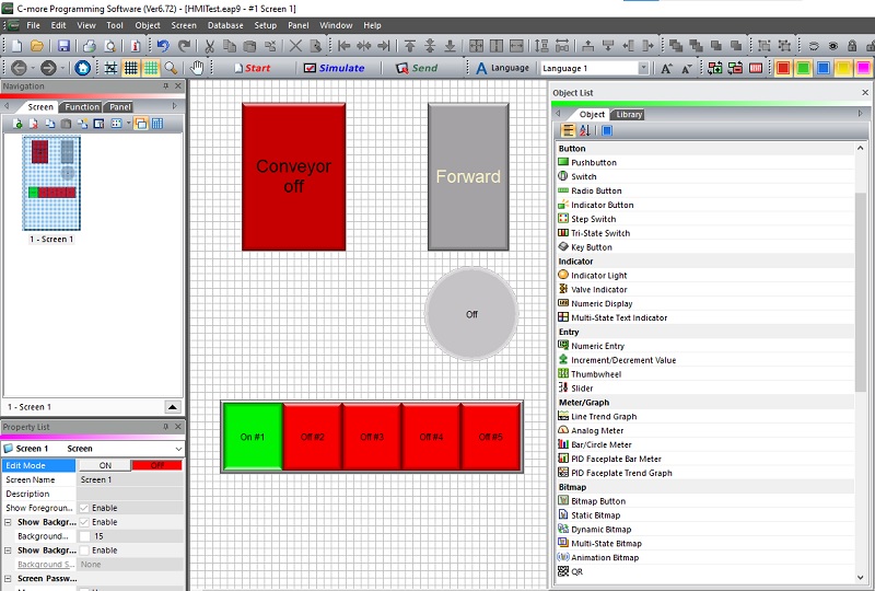

Graphical Object Oriented Programming
Consider the inventory of pushbuttons, displays, indicators, and keyboard inputs available from your favorite industrial controls vendor. What if you had instant access to every kind of toggling or momentary, every illumination color, every test format, every 10-key or alphanumeric keypad, and an unlimited number of contact blocks for each model? You could build whatever control/display panel you could imagine.
This is the exact purpose of the HMI programming environment.
A selection of discrete and analog inputs, indicators, and text/numeric displays and inputs is available to the programmer. When any of these objects is placed on the screen, it is attached to a tag from the database which matches its type. For an indicator, a read-only discrete tag coming from the PLC would be the best choice. For a button, it might be a toggle or momentary, but must be a discrete read/write type.
Advanced controls might allow the user to enter a password to access advanced controls. In this case, a read/write ‘string’ tag would allow an on-screen keyboard for letters, numbers, and special characters.
Objects can also be hidden and formatted different colors based on their active status, or on the status of another tag. For example, if a motor is placed in ‘JOG’ mode, a virtual speed selector knob may appear to allow control of the motor at very slow speeds. For colors, it would be useful to have a pushbutton illuminate dull or bright colors based on the running status of a system.
Ordinarily, any of these changes would require purchasing alternate components, followed by an overhaul of the physical system; drilling new holes in the enclosure, buying new modules for the PLC to support new I/O points, and all of the associated downtime with this project.
Instead, with an HMI, the system can be changed in mere moments, then the new update is loaded to the HMI with very minor disturbance to the system.
