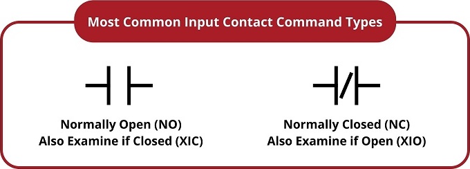

Normally Open (XIC) and Normally Closed (XIO)
The following image shows the two types of contacts in a PLC’s Ladder Diagram program.

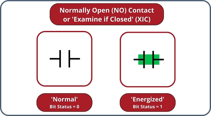

The normally open contact will logically conduct, or become 'closed' when the bit status is a 1, as shown below. As mentioned previously, a logically conducting, or 'closed' element is colored in most ladder programs.

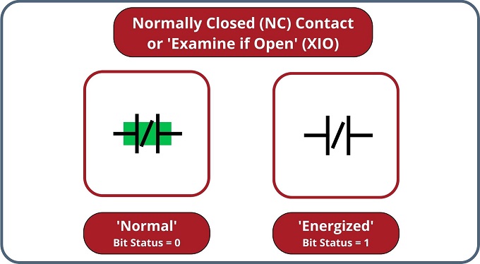

The normally closed contact will logically conduct, or become 'closed' when the bit status is a 0, as shown below.

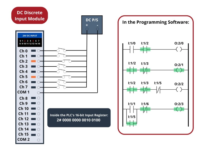

The following simplified illustration shows a small PLC with two of its discrete input channels electrically energized, causing those two bits to have “1” statuses. The color-highlighted contacts in the programming editor software’s display shows a collection of contacts addressed to those input bits in various states (colored = closed; un-colored = open). As you can see, every contact addressed to a “set” bit (1) is in its actuated state, while every contact addressed to a “cleared” bit (0) is in its normal state:
Remember that colored contact is a closed contact. The contacts appearing as colored are either normally-closed contacts with “0” bit states or normally-open contacts with “1” bit states. It is the combination of bit state and contact type (NO vs. NC) that determines whether the virtual contact will be open (un-colored) or closed (colored) at any given time. Correspondingly, it is a combination of colored highlighting and virtual contact type that indicates the real-world energization status of a particular PLC input at any given time.

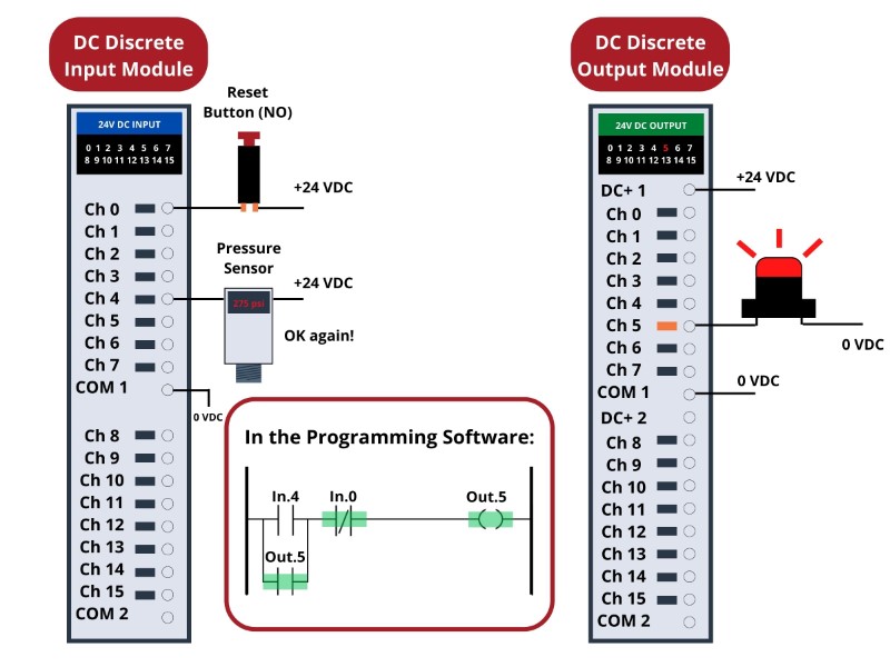

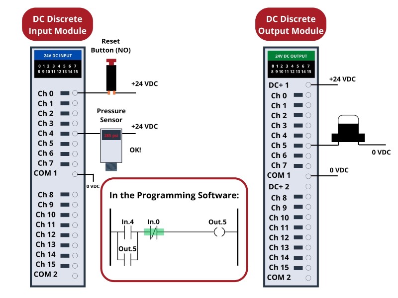

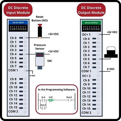

To further illuminate these fundamental concepts, we will examine the operation of a simple PLC system designed to energize a warning beacon in the event that a fluid process line experiences a low pressure. The PLC’s task is to energize a warning lamp if the process vessel pressure ever falls below 270 PSI and keep that warning lamp energized even if the pressure again exceeds the trip point of 270 PSI. This way, operators will be alerted to both past and present process vessel overpressure events.
DC control voltage (+24 and 0 volts) provides electrical energy for the signal potential for the input switches and power for the warning lamp. Two switches connect to the input of this PLC: one normally-open pushbutton switch acting as the alarm reset (pressing this switch “unlatches” the alarm lamp) and one normally-open pressure switch acting as the sensing element for the process pressure:
The reset pushbutton connects to discrete input channel 0 of the PLC, while the pressure switch connects to discrete input channel 4. The warning lamp connects to discrete output channel 5. Indicator LEDs next to each I/O terminal and at the top of each module visually indicate the electrical status of the I/O points, while green-shaded highlighting shows the virtual power status of the “contacts” and “coils” in the PLC’s program, displayed on the screen of a personal computer connected to the PLC through a programming cable.
With no one pressing the reset pushbutton, that switch will be in its normal status, which for a “normally-open” switch is open. Likewise with the pressure switch: with process pressure sufficiently higher than the trip point of 270 PSI, the pressure switch will also be in its normal status, which for a “normally-open” switch is open. Since neither switch is conducting electricity right now, neither discrete input channel 0 nor channel 4 will be energized. This means the “virtual” contacts inside the PLC program will likewise be in their own normal states. Thus, any virtual contact drawn as a normally-open will be open (not passing virtual power), and any virtual contact drawn as a normally-closed (a diagonal slash mark through the contact symbol) will be closed. This is why the two normally-open virtual contacts In.4 and Out.5 have no highlighting, but the normally-closed virtual contact In.0 does – remember, the colored highlighting represents the ability to pass virtual logical power, NOT an indicator of the actual current flow through the switch.
If the process vessel experiences a low pressure (\(<\) 270 PSI), the pressure switch will actuate, closing its normally-open contact. This will energize input channel 4 on the PLC, which will “close” the virtual contact In.4 in the ladder program. This sends virtual power to the virtual “coil” Out.5, which in turn latches itself on through virtual contact Out.5 and also energizes the real discrete output channel 5 to energize the warning lamp:
If now the process pressure goes back above below 270 PSI, the pressure switch will return to its normal state (open), thus de-energizing discrete input channel 4 on the PLC. Because of the latching contact Out.5 in the PLC’s program, however, output channel 5 remains on to keep the warning lamp in its energized state:
Thus, the Out.5 contact performs a seal-in function to keep the channel 5 output bit set (1) even after the low-pressure condition clears. This is precisely the same concept as the “seal-in” auxiliary contact on a hard-wired motor starter circuit, where the electromechanical contactor keeps itself energized after the “Start” pushbutton switch has been released.

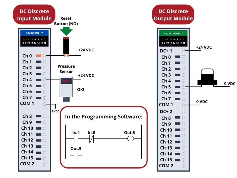

The only way for a human operator to re-set the warning lamp is to press the pushbutton. This will have the effect of energizing input channel 0 on the PLC, thus opening virtual contact In.0 (normally-closed) in the program, thus interrupting virtual power to the virtual coil Out.5, thus powering down the warning lamp and un-latching virtual power in the program:
