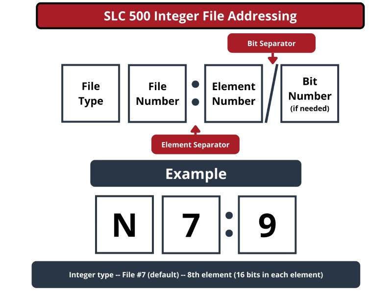

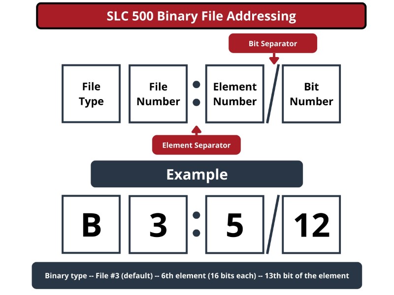

This file-based addressing notation bears further explanation. When an address appears in a PLC program, special characters are used to separate (or “delimit”) different fields from each other. The general scheme for Allen-Bradley SLC 500 input and output terminal addresses is shown here:
Not all addresses refer the PLC to external, physical screw terminals attached to real-world I/O devices. Many individual memory bits are available in the PLC's memory - far more convenient in many cases that forcing the logic to consume all the available I/O points. For these binary bits of data, a very similar address structure is used, except this structure will not refer to physical slots or terminals, but rather files and elements.
In the following breakdown, a file can be specified for all of the internal memory types. The default fils for binary memory is file #3, but files 9 through 255 can be configured for the user's own needs.
Not all file types need to distinguish individual words and bits. Integer files (N), for example, consist of one 16-bit word for each element. For instance, N7:9 it would be the 16-bit integer word number nine held in file seven. A discrete input file type (I), though, needs to be addressed as individual bits because each separate I/O point refers to a single bit. Thus, I:3/7 would be bit number seven residing in input element three. The “slash” symbol is necessary when addressing discrete I/O bits because we do not wish to refer to all sixteen bits in a word when we just mean a single input or output point on the PLC. Integer numbers, by contrast, are collections of 16 bits each in the SLC 500 memory map, and so are usually addressed as entire words rather than bit-by-bit.
As with the binary data, a default file is allocated for each memory type by default. There are 9 total default files, 0 through 8. The following files, from 9 all the way to file 255 are not allocated to any one specific purpose - the user can provide more allowance for extra bits, integers, or timers, however the project dictates.

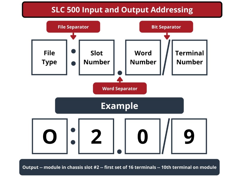

A hallmark of the SLC 500’s addressing scheme common to many legacy PLC systems is that the address labels for input and output bits explicitly reference the physical locations of the I/O channels. For instance, if an 8-channel discrete input card were plugged into slot 4 of an Allen-Bradley SLC 500 PLC, and you wished to specify the second bit (bit 1 out of a 0 to 7 range), you would address it with the following label: I:4/1. Addressing the seventh bit (bit number 6) on a discrete output card plugged into slot 3 would require the label O:3/6. In either case, the numerical structure of that label tells you exactly where the real-world input signal connects to the PLC.

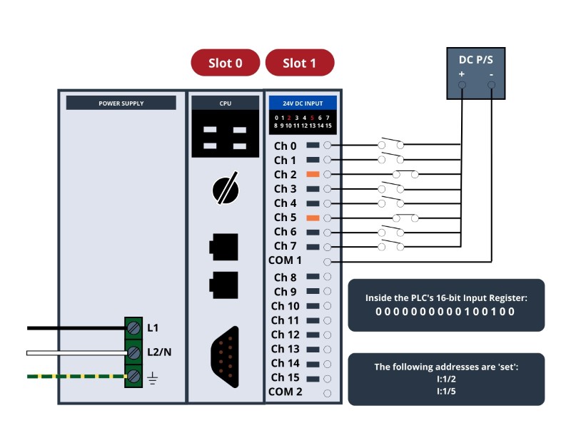

To illustrate the relationship between physical I/O and bits in the PLC’s memory, consider this example of an Allen-Bradley SLC 500 PLC, showing two of its discrete input channels energized (indicated here are simple closed button electrical symbols, but they may be switches or sensors):

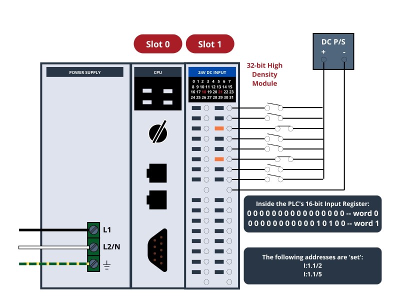

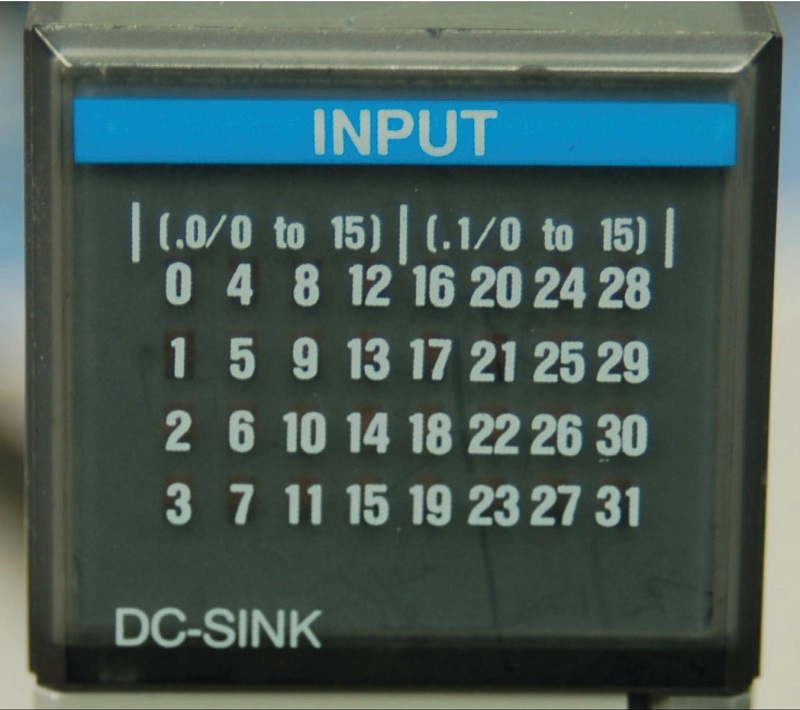

If an input or output card possesses more than 16 bits – as in the case of the 32-bit discrete output card shown in slot 3 of the example SLC 500 rack – the addressing scheme further subdivides each element into words and bits (each “word” being 16 bits in length). Thus, the address for bit numbers 18 and 21 of a 32-bit input module plugged into slot 1 would be I:1.1/2 and I:1.1/5 (since bit 18 is equivalent to bit 2 of word 1 – word 0 addressing bits 0 through 15 and word 1 addressing bits 16 through 31. Similar for bit 21.):
A close-up photograph of a 32-bit DC input card for an Allen-Bradley SLC 500 PLC system shows this multi-word addressing:
The first sixteen input points on this card (the left-hand LED group numbered 0 through 15) are addressed I:X.0/0 through I:X.0/15, with “X” referring to the slot number the card is plugged into. The next sixteen input points (the right-hand LED group numbered 16 through 31) are addressed I:X.1/0 through I:X.1/15.
Legacy PLC systems typically reference each one of the I/O channels by labels such as “I:1/3” (or equivalent) indicating the actual location of the input channel terminal on the PLC unit. The IEC 61131-3 programming standard refers to this channel-based addressing of I/O data points as direct addressing. A synonym for direct addressing is absolute addressing.
Addressing I/O bits directly by their card, slot, and/or terminal labels may seem simple and elegant, but it becomes very cumbersome for large PLC systems and complex programs. Every time a technician or programmer views the program, they must “translate” each of these I/O labels to some real-world device (e.g. “Input I:1/3 is actually the Start pushbutton for the middle tank mixer motor”) in order to understand the function of that bit. A later effort to enhance the clarity of PLC programming was the concept of addressing variables in a PLC’s memory by arbitrary names rather than fixed codes. The IEC 61131-3 programming standard refers to this as symbolic addressing in contrast to “direct” (channel-based) addressing, allowing programmers arbitrarily name I/O channels in ways that are meaningful to the system as a whole. To use our simple motor “Start” switch example, it is now possible for the programmer to designate input I:1/3 (an example of a direct address) as “Motor_start_switch” (an example of a symbolic address) within the program, thus greatly enhancing the readability of the PLC program. Initial implementations of this concept maintained direct addresses for I/O data points, with symbolic names appearing as supplements to the absolute addresses.

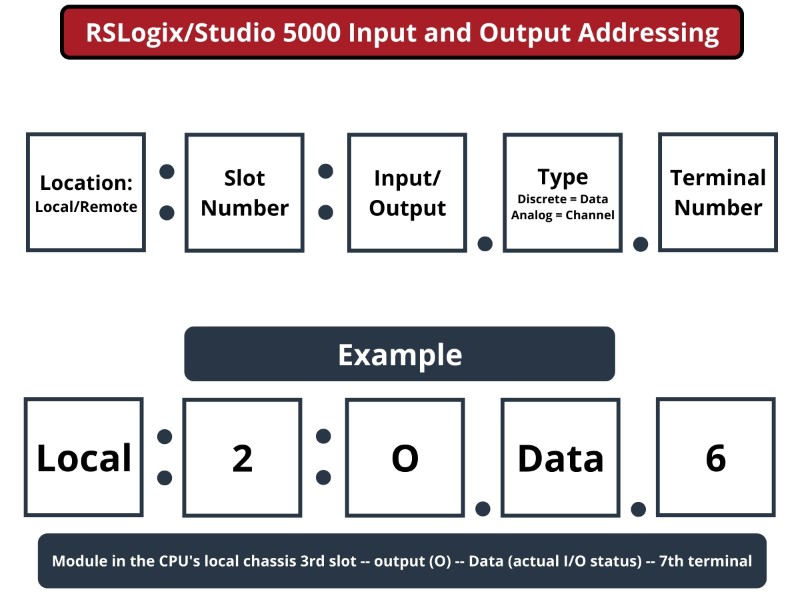

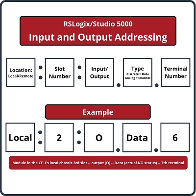

ControlLogix and CompactLogix I/O Addresses
All I/O terminals must still be identified by an address that points to their physical location with respect to the CPU, but these are different from the file, element, and bit pointers of the older systems.
These addresses still act as a ‘map’ of sorts, which can direct a technician to the exact spot where any screw terminal may be found. The structure appears in the image below, along with an example.
The structure begins by pointing to either a local or remote chassis. When any external chassis (such as another PLC, or a remote I/O rack) is added to the project, it is given a name. If the I/O terminal is located in the remote rack, the address will begin with the name of the remote rack, not with the word Local which is reserved only for the CPU’s local chassis.
The slot number in the local or remote chassis is the next address number, always starting with slot #0. Often, the CPU is placed in slot #0, but this should not always assumed to be the case. Input and output terminals are indicated with I and O respectively. Configuration and status data may also be added into certain module types, so C and S may also appear in the address.
The type component refers to the module being used. The reference to ‘data’ in an address points to the on/off status of a single discrete terminal, identified by the bit number. In an analog system, a single terminal represents a channel, so in those cases, the word ‘channel’ will be followed by the terminal number.
When any new I/O module is added to a project, a new double integer (DINT) set of memory addresses is reserved for that module. With 32 bits of availability, every module is now a new assignment of 32 new bits as the input register. Even if the module only has 16 terminals to monitor, 32 bits will still be consumed.
Sometimes, these 32 bits can be used advantageously.
For example, assume a new project is created and a variable frequency motor control device (VFD) is added.
A set of command words will be sent and received from this VFD. The PLC will store the outgoing data as a 32-bit double word register, but the VFD may be able to split this into two 16-bit words. One word may store all of the start/stop/jog/direction commands, while the second word contains the integer value representing the desired operating speed of the motor.
So while the PLC consumes only a single 32-bit address for the information, it may serve two or more purposes when split apart (called ‘parsing’) by a receiving device.

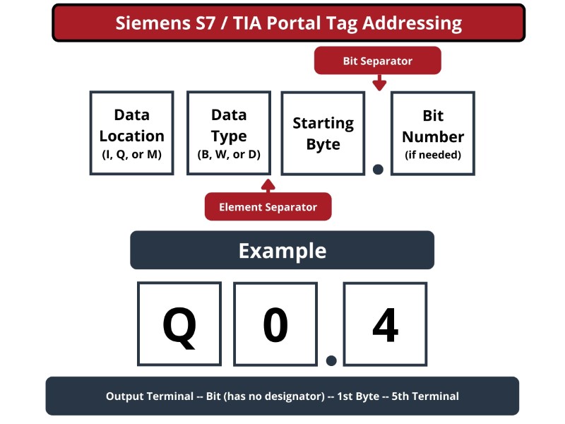

Another popular style of tag-based programming is used in the Siemens S7 PLC series (including the S7-300, 400, 1200, and 1500). These are programmed using the Totally Integrated Automation TIA portal software.
In this system, each tag is created by name, and then assigned an address based on available memory locations. All inputs, outputs, and memory locations are directed to 8-bit byte of 16-bit word registers, and there will likely be several thousand of these registers, depending on the specific PLC’s memory.
Each register can be referenced as an entire byte or integer, or two registers may be referenced as a 32-bit integer, or finally, a single bit from a register can be retrieved. In this way, every data type from boolean to integers to floats can be created and stored, but must be assigned a memory location.
In these PLCs, each I/O module, or embedded set of I/O terminals is already linked to a particular set of registers. Discrete and analog terminals will be pre-determined and must be retrieved from the documentation.
For example, an S7-1214C AC/DC/Rly has 14 discrete inputs, 10 relay outputs, and 2 analog inputs. This model is equipped with a removable signal board providing 1 additional analog output. Each of these signals is already located in a particular memory address within the controller.
The discrete input and output registers are read as 8-bit bytes, so each byte can store 8 input or output terminals. Since there are 14 inputs, two bytes are required. If you wish to read any of the input terminals, you would use the tag addresses I0.0 to I0.7 for the first 8 terminals, then I1.0 to I1.5 for the remaining 6.
In a similar vein, the 10 output terminals would be addressed as Q0.0 to Q0.7 for the first 8 terminals, then Q1.0 to Q1.1 for the remaining 2.
This PLC has two analog input terminals. Since they are not single-bit values, they must be referenced as 16-bit words. Since the memory is divided into bytes, it takes two consecutive bytes to store a single word. This is accomplished by using an address with an Input structure (I), indicating it as a word (W), and being sure to only use every other byte address.

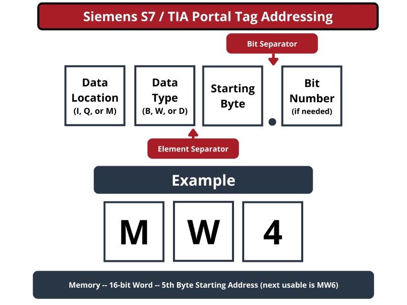

Memory addresses can be placed at the user’s discretion since they are not tied to physical I/O registers. When defining a new tag, start by selecting M (for memory storage). If the tag must be a single bit, the structure may be M4.1 for example, the second bit of the 5th byte.
If the tag must be an entire byte, the tag would be MB4 and the next one would be MB5. As the integer size increases, such as a word, MW4 may be the first tag, but MW6 must be the next one, since a 16-bit word consumes two consecutive bytes. A double word is twice the size of a word, so MD4 must be followed by MD8.

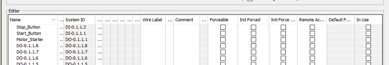

Tag Database Management
With this comparison of tags and addresses in the rear-view mirror, it is worth discussing the process of tag creation, and learning how to manage sets of tags in a database.
A tag database is the logical organization of labels for the data used in a program. It is not classified in order of where the data is stored in the memory of the controller, in contrast to an address-based memory table. Storage files are not in order, but rather the labels can be sorted alphabetically, by order of creation, or by data type. This allows programmers to treat the memory storage in their PLC much more like any traditional database.
Inside this database, tags can be viewed and created when needed. Often, the current value of a tag can be monitored while the program and I/O registers are actively scanning. When a tag is created by selecting a unique name and data type, that unique pointer address can still be accessed. Commonly, this is used to link tags to human-machine interface (HMI) tag lists, although there are a wide variety of HMI programming strategies.
Several critical tag components should be considered in the database. In most programming software interfaces, each of the following details can be shown or hidden in the ladder rungs to display valuable information as needed.
Tag Name
Logical names will be the first visible element when troubleshooting the running ladder logic, so it’s important to consider the names as they would appear in the code, and in the database. If the database arranges the tags alphabetically, consider stating each group of like items with the same character so they remain readable, yet grouped in the database.
Many languages do not support spaces (the space character) in a tag name, so it can be a good practice to use alternative methods like underscores, mixed-case capital and lowercase letters, and other strategies to name tag.
Wire Label
A wiring label is the short code that will appear on a physical wire in a control cabinet, and in a schematic ‘wire’ line connecting two components. It may also be a reference to a line in a printed version of the program.
Proper wire labels attached to the tags in the database can aid the troubleshooter in tracing a circuit from the PLC terminal back to the original field device - switch, sensor, or coil - that may be a suspect in a faulty system.
Description
A tag description can provide further information about the function and use of a tag, even if it does not directly reference a physical I/O terminal. A timer, for example, may be used to treat a chemical batch process, but the duration of the timer is dependent on several factors from other inputs. A description can be a helpful method of noting these important details that can aid a future troubleshooting or process improvement upgrade.
Another benefit of a description field for a physical I/O device is to contain details about the component - specifications, part numbers, and even hyperlinks to datasheets. This can save valuable time when the most likely suspect is a faulty part that needs replacement. If the program already contains the details of the part, a replacement can be immediately retrieved rather than the typical process of removing the bad part, locating the replacement from a supply room, then reinstalling the new part.
